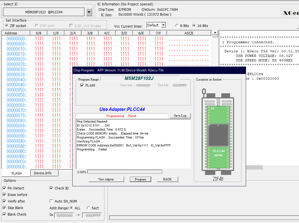

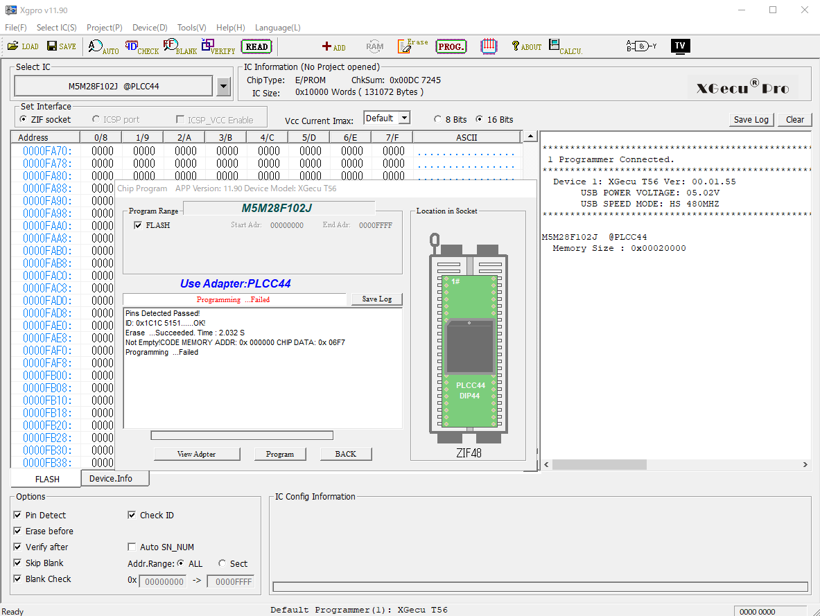

T56 can't ERASE and PROGRAM for MITSUBISHI M5M28F102J .
wrong command data(D0-D15)?
VCC: 5V OUT OK
VPP: 12V OUT OK
Read: Successed
Erase: Failed (data remains)
Program: Failed

作者: admin    时间: 2022-5-3 11:52
回复 1# OffGao
   If the IC is Boot Locked . the boot data canot be erased.  Check the data after the boot.  if all is  FF , the chip is boot locked.
作者: OffGao    时间: 2022-5-3 23:08
回复 2# admin
ttps://www.datasheets360.com/pdf/2009148678025692463
I'm checking the datasheet, this chip doesn't seem to suported boot lock feature.
The data read after erasing was the same as the data before erasing.

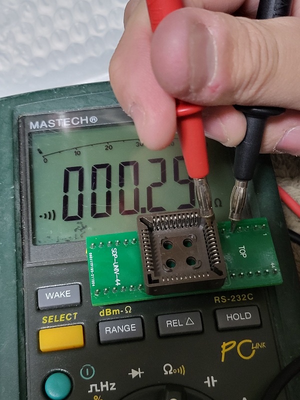

OffGao 发表于 2022-5-3 23:08
    As an user... Just to add diagnostic info, please check ohm from every pin, to dip, and sure pin to pin with no high ohm between?

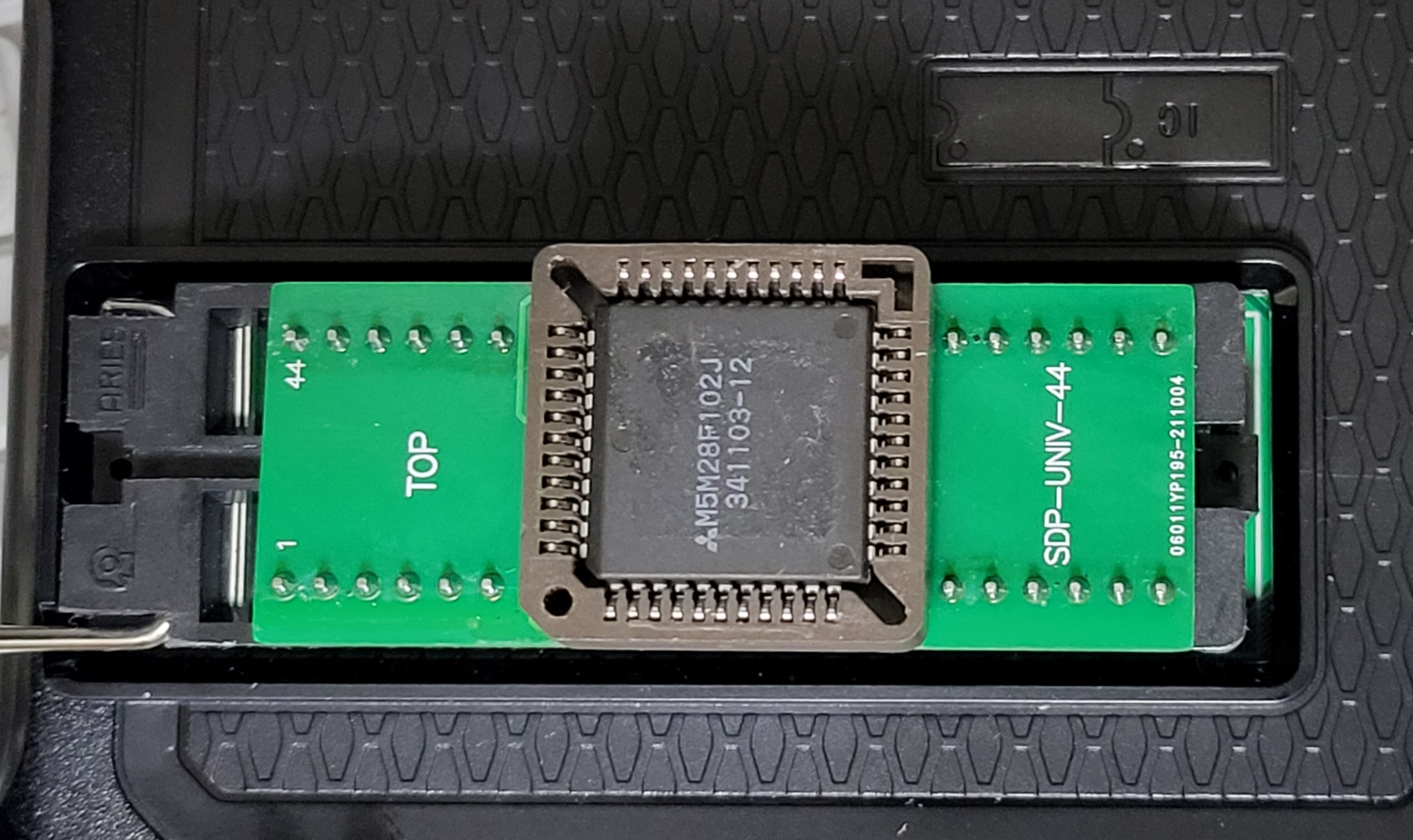

作者: OffGao    时间: 2022-5-4 11:19
回复 4# Albano.Matos
I looked it up.
All pins are connected(0Ω), and not shorted near pins.
Also, It successed program for HN27C1024(PLCC44) with this adapter.
This PLCC to DIP Adapter is works.
图片附件: 20220504_115958.jpg (2022-5-4 11:17, 158.93 KB) / 下载次数 27460
http://forums.xgecu.com/attachment.php?aid=1219&k=bb1f817ef0842f369e7c2e1fc2523440&t=1793708454&sid=htJdxy

作者: admin    时间: 2022-5-5 17:29
回复 6# Albano.Matos
   I carefully proofread the algorithm and no errors found,    Test with SOP40 1.27mm is normal, but I don't have this chip of PLCC44, and it's hard to find
作者: OffGao    时间: 2022-5-6 00:38
回复 7# admin

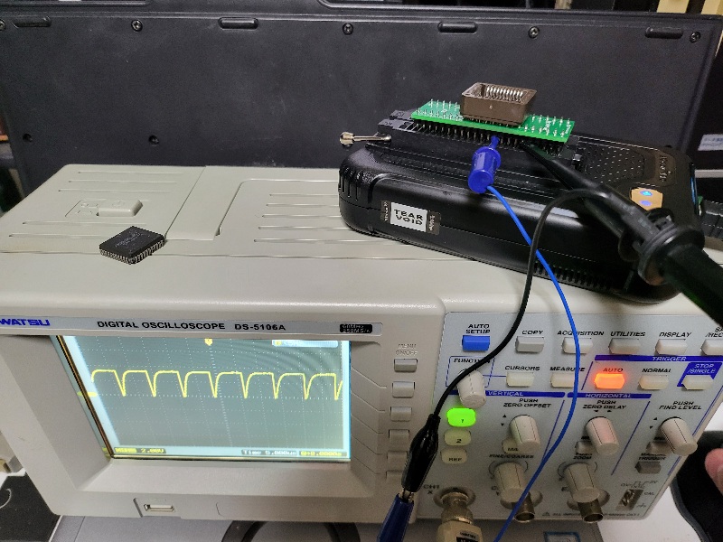

I tried using an oscilloscope.
After investigating, it was possible that I was sending the wrong command.
Erase Command required "2020H" and "A0A0H".
But, T56 Sending "0020H" and "00A0H".
It's wrong...
图片附件: 20220506_013643.jpg (2022-5-6 00:26, 172.51 KB) / 下载次数 27287
http://forums.xgecu.com/attachment.php?aid=1220&k=bf0dac3f2ae4eb405c70a9bcb2febb87&t=1793708454&sid=htJdxy
作者: admin    时间: 2022-5-8 16:17
回复 8# OffGao
But M5M28F102J SOP40 is Normal,  they are same command.
please test with new algorithm with 0x2020
ROM40P91.alg (63.74 KB)
Replace it in the floder:  ?/xgpro/algorithm. After replacement, reopen the application software.
附件: ROM40P91.alg (2022-5-8 16:15, 63.74 KB) / 下载次数 112246
http://forums.xgecu.com/attachment.php?aid=1221&k=a5ea7dfddee53809b6cf7821c09bbe4f&t=1793708454&sid=htJdxy

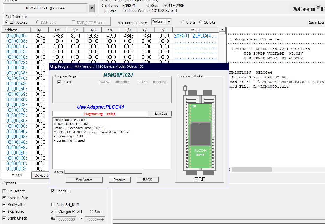

作者: OffGao    时间: 2022-5-9 21:11
回复 9# admin
I tried new algorithm file.
READ: Success
ERASE: Success!!
PROGRAM: Failed
Erase Successed. My M5M28F102J was correctly blanked.
But, Program Failed... Only one word is written unstable.
Some modifications are needed.
图片附件: m5m-2.png (2022-5-9 20:47, 52.14 KB) / 下载次数 26006
http://forums.xgecu.com/attachment.php?aid=1222&k=6fb9e2c08698042def2ce179899f96bd&t=1793708454&sid=htJdxy
图片附件: m5m-3.png (2022-5-9 21:09, 62.79 KB) / 下载次数 25979
http://forums.xgecu.com/attachment.php?aid=1223&k=1b7cd38cb62e4371f2f9427874f4e4d7&t=1793708454&sid=htJdxy
作者: admin    时间: 2022-5-11 17:30
回复 10# OffGao
   I have to get the chip to test!

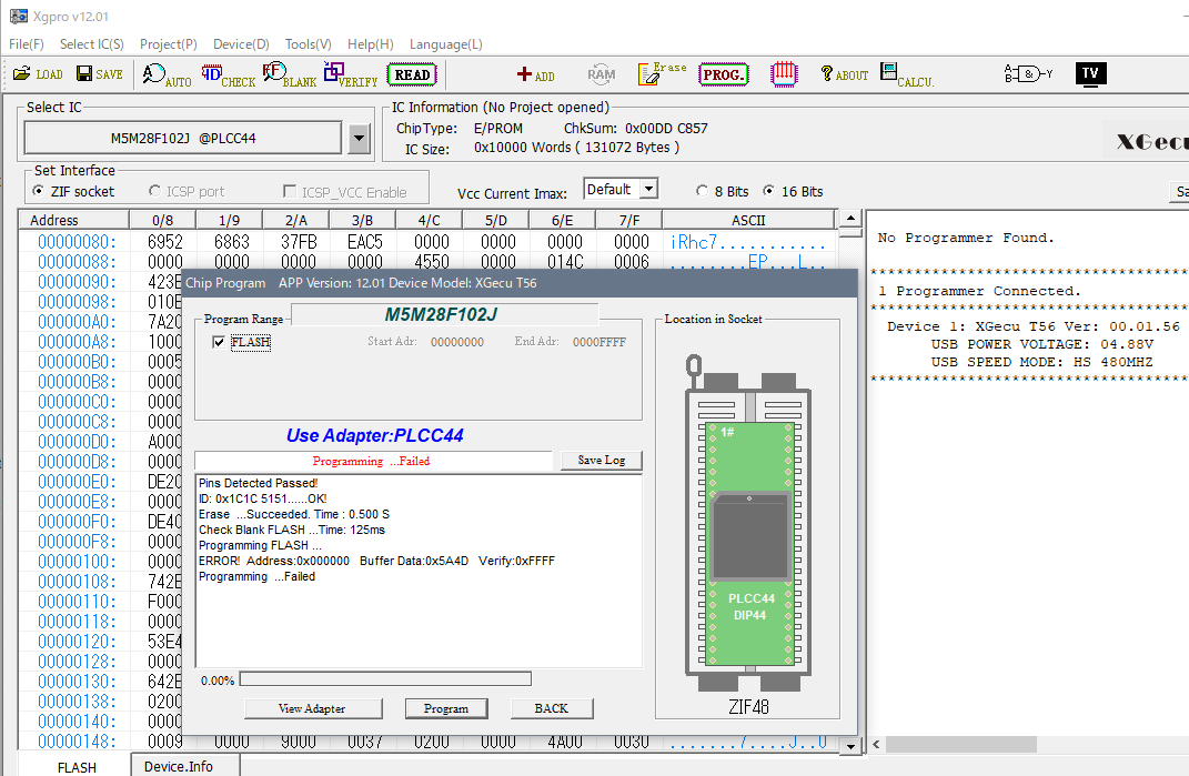

作者: OffGao    时间: 2022-6-15 12:22
I tried new Xgpro v12.01.
But, My M5M28F102J failed program.
READ: Success
ERASE: Success
PROGRAM: Failed
图片附件: 1201.png (2022-6-15 12:18, 64.04 KB) / 下载次数 25781
http://forums.xgecu.com/attachment.php?aid=1272&k=2415fd3e32d66f5ccc17d4e371d957d3&t=1793708454&sid=htJdxy
作者: admin    时间: 2022-6-15 17:30
回复 12# OffGao
   I tested more and more , but it can not be sloved.  programming logic is right.   It seems that the age of the chip is too old to be written.
Found :  after erasing,Disable erase before programming , then repeat programming more times. it can write into the first word, but cannot write the second word.
and M5M28F102 SOP40 is Normal.  I can't find the the problem.
作者: OffGao    时间: 2022-6-26 06:39
Hmm... Access may be too fast.
If you program it many times, it will gradually change to the correct value.
(ex: Write AA55, FFFF -> FEFF -> BEF7 -> AED7 -> AAD5 -> AA55)
I want an option to slow down access.
