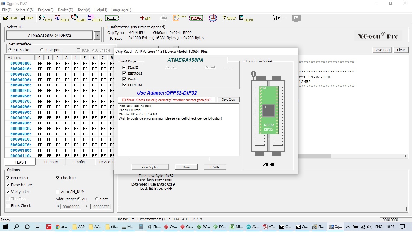

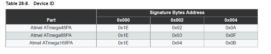

Why do you have new bugs in every new version? Why can't you make one stable version? I used version 11.00, it worked fine. Updated to 11.90 and can't program ATMEGA168PA properly. Writes ID ERROR. I have to disable ID verification.
图片附件: 1.jpg (2022-4-26 23:33, 290.32 KB) / 下载次数 12023

图片附件: 2.jpg (2022-4-26 23:33, 39.05 KB) / 下载次数 10376
