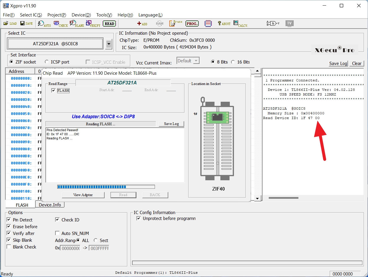

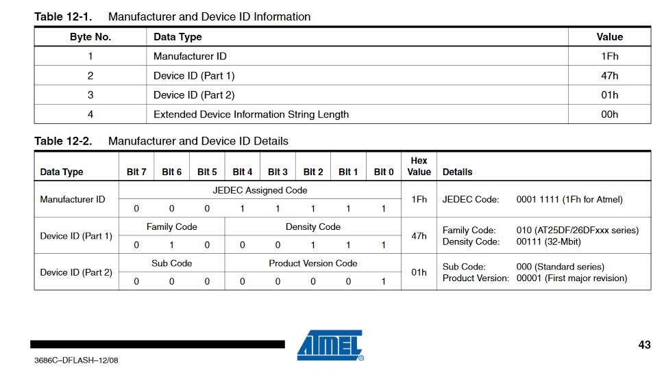

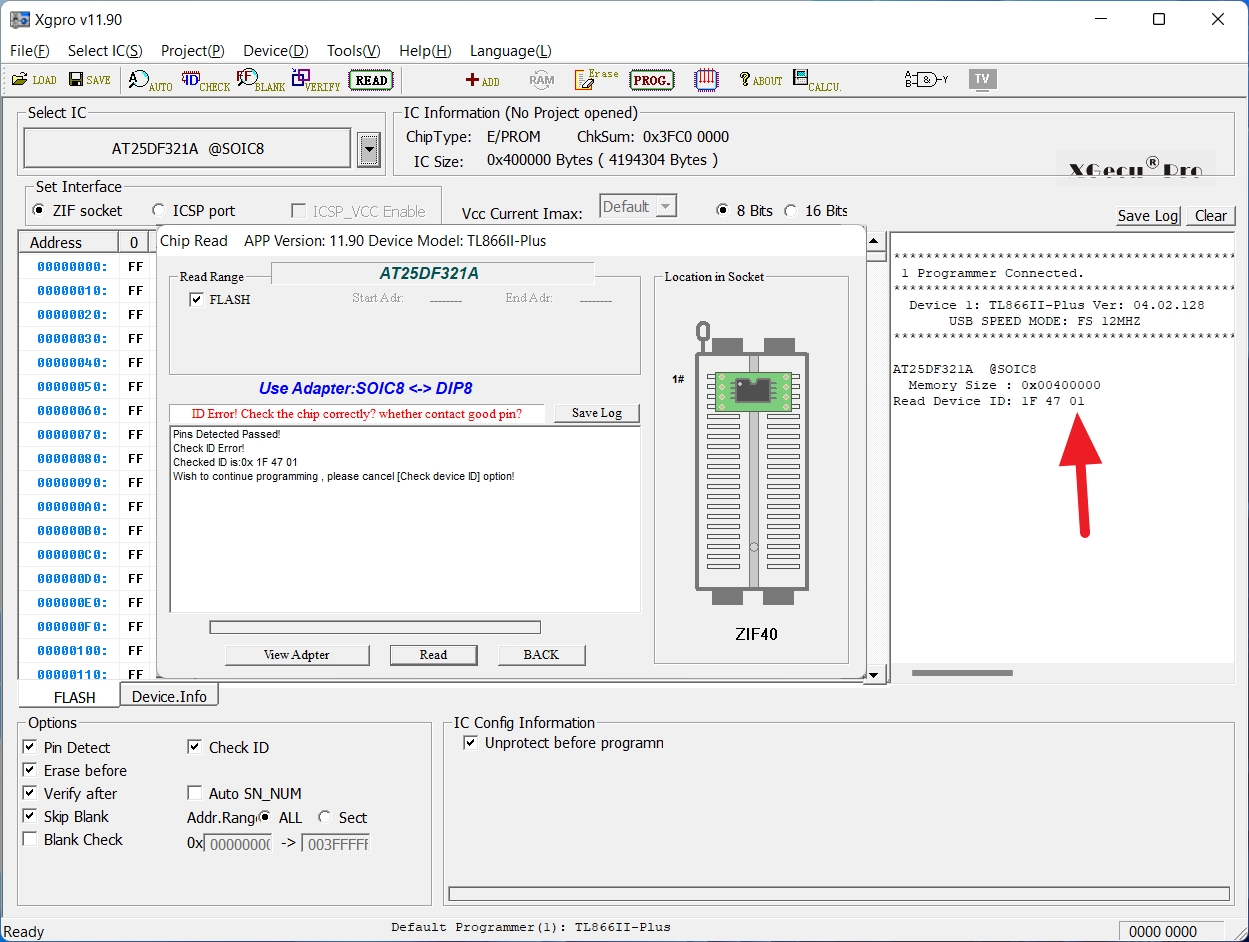

This chip has two ID numbers. Device ID: 1F 47 00 and Device ID: 1F 47 01.
The program only recognizes Device ID: 1F 47 00.

You can disable ID check. programming is the same.
