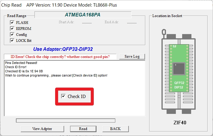

Hello. I have a problem. When programming ATmega168P and 168PA, it is not possible to pass the ID check. The program incorrectly specified the ID for these chips. Check the ID in the program for these microcontrollers.
Programming Atmega168 and 168A is correct.

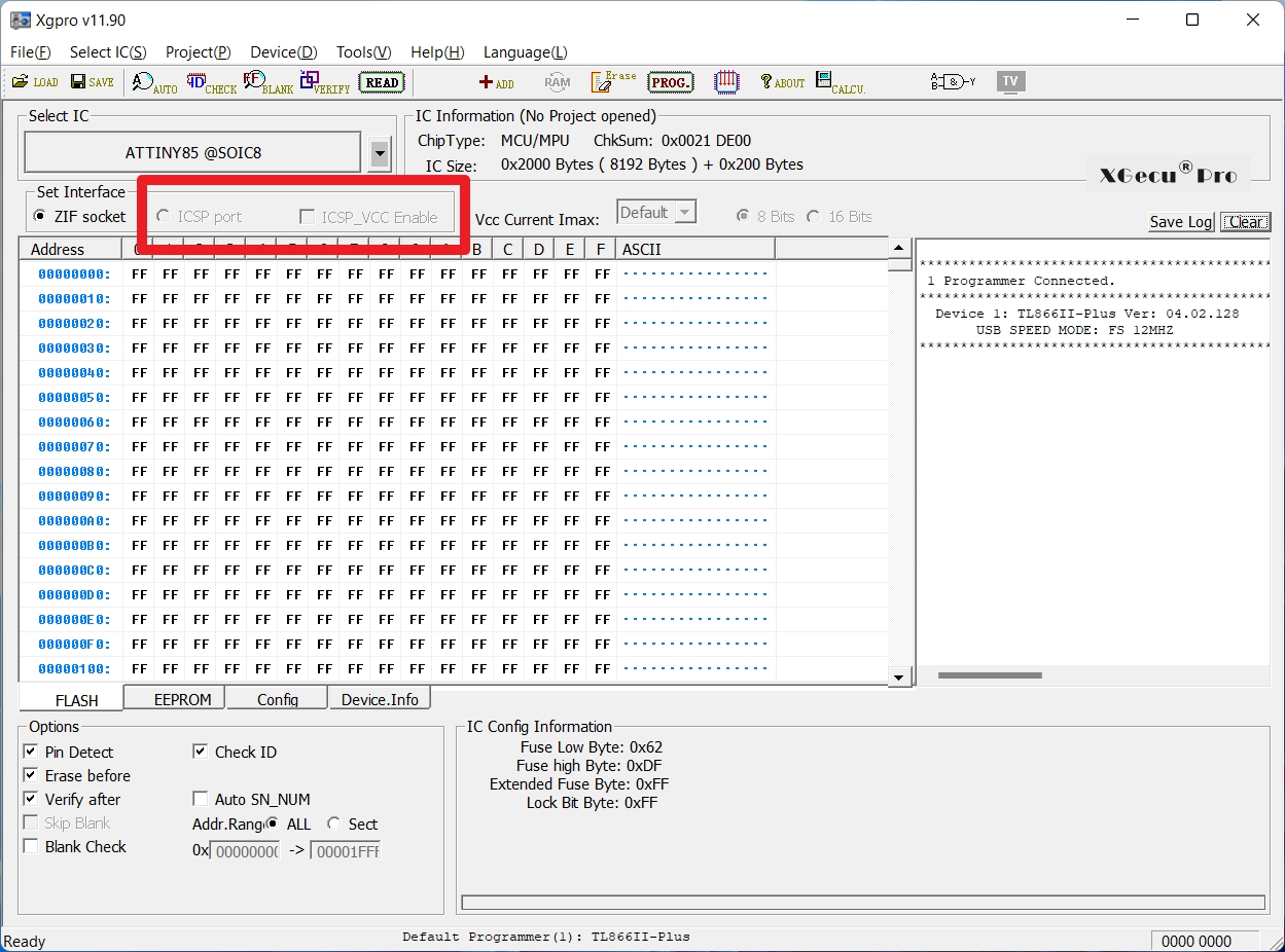

Add to the program the ability to program ATtiny25/45/85 microcontrollers via ICSP. Thank you.

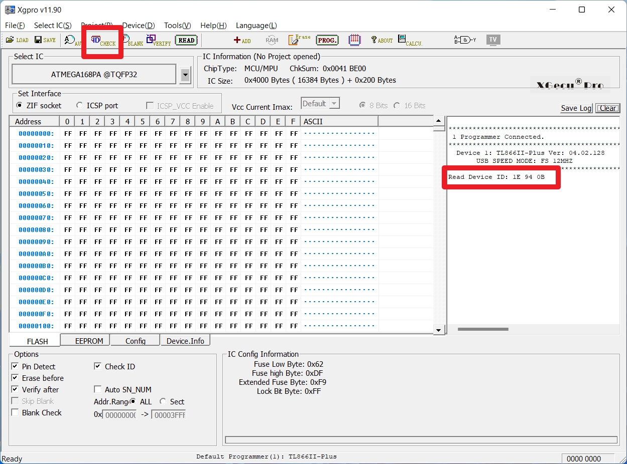

   As an user:                    Please, post the ID you are seeing in the log window (two bytes).
作者: Dimansion    时间: 2022-4-10 00:57
APP Version : 11.90   Model : TL866II Plus
Device : ATMEGA168PA @TQFP32
Read Device ID: 1E 94 0B
图片附件: Image 1649523268.jpg (2022-4-10 00:56, 617.75 KB) / 下载次数 35104
http://forums.xgecu.com/attachment.php?aid=1188&k=caeac9e2ff34b05adfc4a64bd3b95e48&t=1793839242&sid=T4d4D8
图片附件: Image 1649523286.jpg (2022-4-10 00:56, 136.3 KB) / 下载次数 28975
http://forums.xgecu.com/attachment.php?aid=1189&k=741f46f991447b03cc091c9e4fdfa0fa&t=1793839242&sid=T4d4D8
图片附件: Image 1649523343.jpg (2022-4-10 00:56, 136.95 KB) / 下载次数 29078
http://forums.xgecu.com/attachment.php?aid=1190&k=b3dcfbfc0342cd3445cb222bc1c83dd2&t=1793839242&sid=T4d4D8
作者: Albano.Matos    时间: 2022-4-10 12:13
Dimansion 发表于 2022-4-10 00:57
    Now i hope Admin say something, or correct the info for all, or whatever needed.With the ID, Admin usually comment  about it, sometimes equivalent IC rebadged,
new batch from newer manufacturer, bug, etc...hopefully

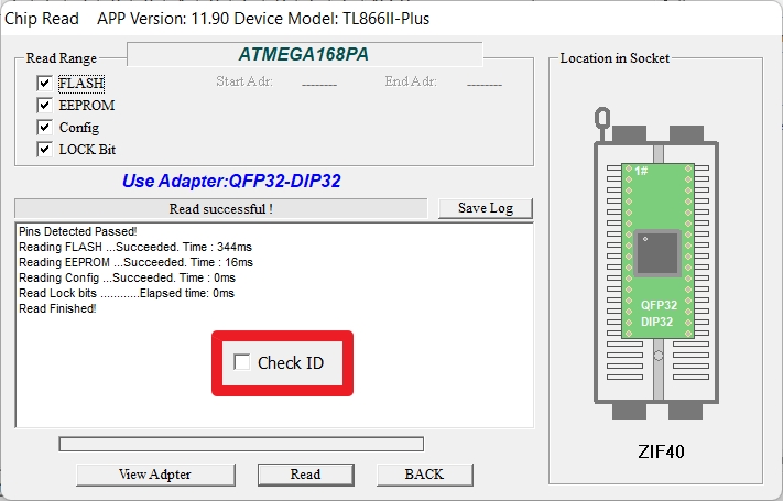

作者: admin    时间: 2022-4-11 15:20
回复 4# Albano.Matos
   This is an error in the software ID entry, the ID will be fixed in the next version.   Disable ID checking, no effect on programming.

Is it possible to add support ICSP for ATtiny25/45/85?
图片附件: Image 1649707471.jpg (2022-4-12 03:51, 610.79 KB) / 下载次数 34836
http://forums.xgecu.com/attachment.php?aid=1191&k=cd3a80717670aee038dd20acb037afca&t=1793839242&sid=T4d4D8
