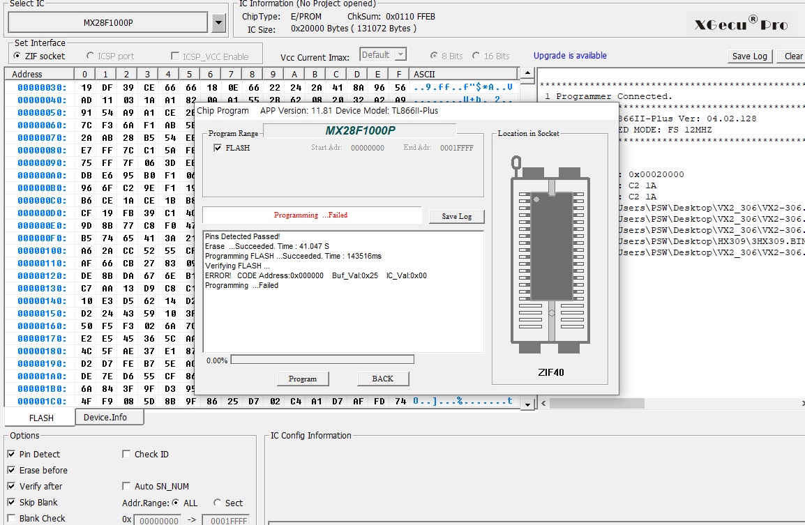

作者: beckham7    时间: 2022-3-12 00:16     标题: [solved]mx28f1000p programming failed plz help me!

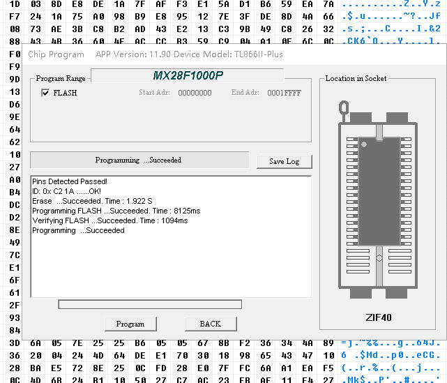

my chip was bad. programming has done well
图片附件: 22.jpg (2022-3-12 00:15, 288.27 KB) / 下载次数 11910

作者: Albano.Matos    时间: 2022-3-12 14:06
beckham7 发表于 2022-3-12 00:16
   As an user...It looks that you are running 11.81 version of Xgpro app. Have you tried to upgrade to 11.90 ? Sometimes, bugs are corrected even for already supported ICs...Download Newest XGecu T56/TL866II software(下载最新软件) - 编程器使用与软件下载 - XGecu Programmer Forums - Powered by Discuz!
Hope it helps, or not  :-(

作者: admin    时间: 2022-3-13 10:31
回复 3# beckham7
Bad pins connect? or bad chip.
why you disable <Check ID>?
图片附件: MX28P1000.png (2022-3-13 10:31, 24.88 KB) / 下载次数 10881
