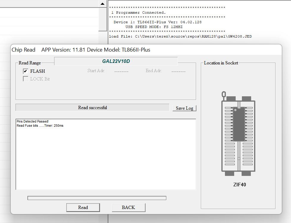

I am trying to program a GAL22V10 PLCC28 using a PLCC28->DIP24 adapter.
I can read / Blank the chip, but it fails when you program it. it also destroys the chip in the process.
I tested different combinations without success, burning thru 9 chips.
图片附件: [read and blanks ok] Screenshot 2022-03-10 222459.png (2022-3-10 22:26, 44.39 KB) / 下载次数 16470
http://forums.xgecu.com/attachment.php?aid=1172&k=fc87ba7afcb89ca0c465ca4ff9252e8e&t=1793364393&sid=HNZM6M
图片附件: [erases ok] Screenshot 2022-03-10 222544.png (2022-3-10 22:26, 38.84 KB) / 下载次数 16444
http://forums.xgecu.com/attachment.php?aid=1173&k=5a2072d16a834e5e46e746429f48960b&t=1793364393&sid=HNZM6M
图片附件: [programming failed] Screenshot 2022-03-10 222740.png (2022-3-10 22:26, 6.83 KB) / 下载次数 16009
http://forums.xgecu.com/attachment.php?aid=1174&k=48013ac65affb9a6d62de20fc068668d&t=1793364393&sid=HNZM6M
图片附件: [chip not usable after that.] Screenshot 2022-03-10 222805.png (2022-3-10 22:26, 6.26 KB) / 下载次数 16076
http://forums.xgecu.com/attachment.php?aid=1175&k=7ef79a63e7be71b1a0ba256e314104b0&t=1793364393&sid=HNZM6M
I can read / Blank the ch ...
terenceang 发表于 2022-3-10 22:29
    As an User....In the mean time, verify if you have any shorted line between IO pins in the adapter.You have a photo of adapter?
I've tested my adapter  one pin to pin, and any resistance between pins, using PDF GAL22V10 Data Sheet (mit.edu)  and seems to be ok. My adapter is the one here Plcc28 dip24 adaptador conversor ic soquete para tl866a tl866cs tl866ii plus ou outros programadores universais|Calculadoras| - AliExpress , but not one IC like yours to be tested. If programming error, or else, ADMIN will tell you.
Hope it helps, :-)
