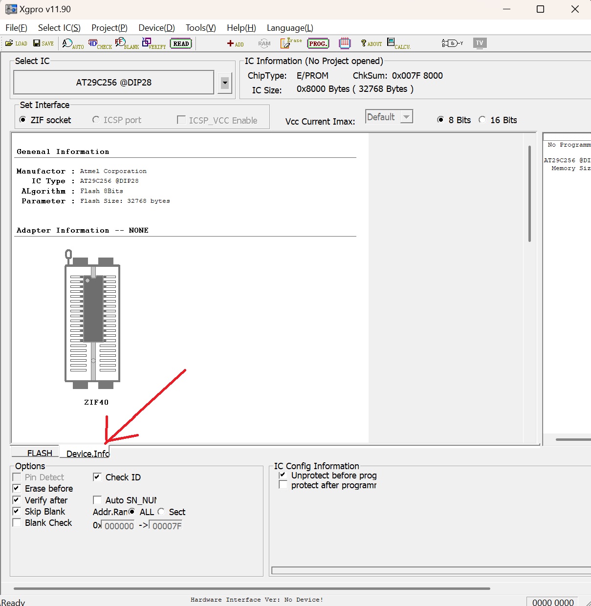

Is there support for bios chip Atmel AT29C256 @ PLCC32?
App Software Ver: 11.90
Firmware Ver: 04.2.128
Xgecu TL866II PLUS

As an user.... You may have already the adapter needed
Adaptador de adaptador plcc32 dip28, adaptador de soquete ic para tl866a tl866cs tl866ii plus ou outros programadores universais|Calculadoras| - AliExpress
Selecting the DIP28 Version, using this adapter, and in Xgpro APP , select 'device info' , insert pin 1 and 28, on top
AT29C256 datasheet (datasheetspdf.com)
Hope you have the adapter, and this little trick, you now know. The Jumper, as the IC is 5V,
should be there.
Hopefully, it will work for you  :)

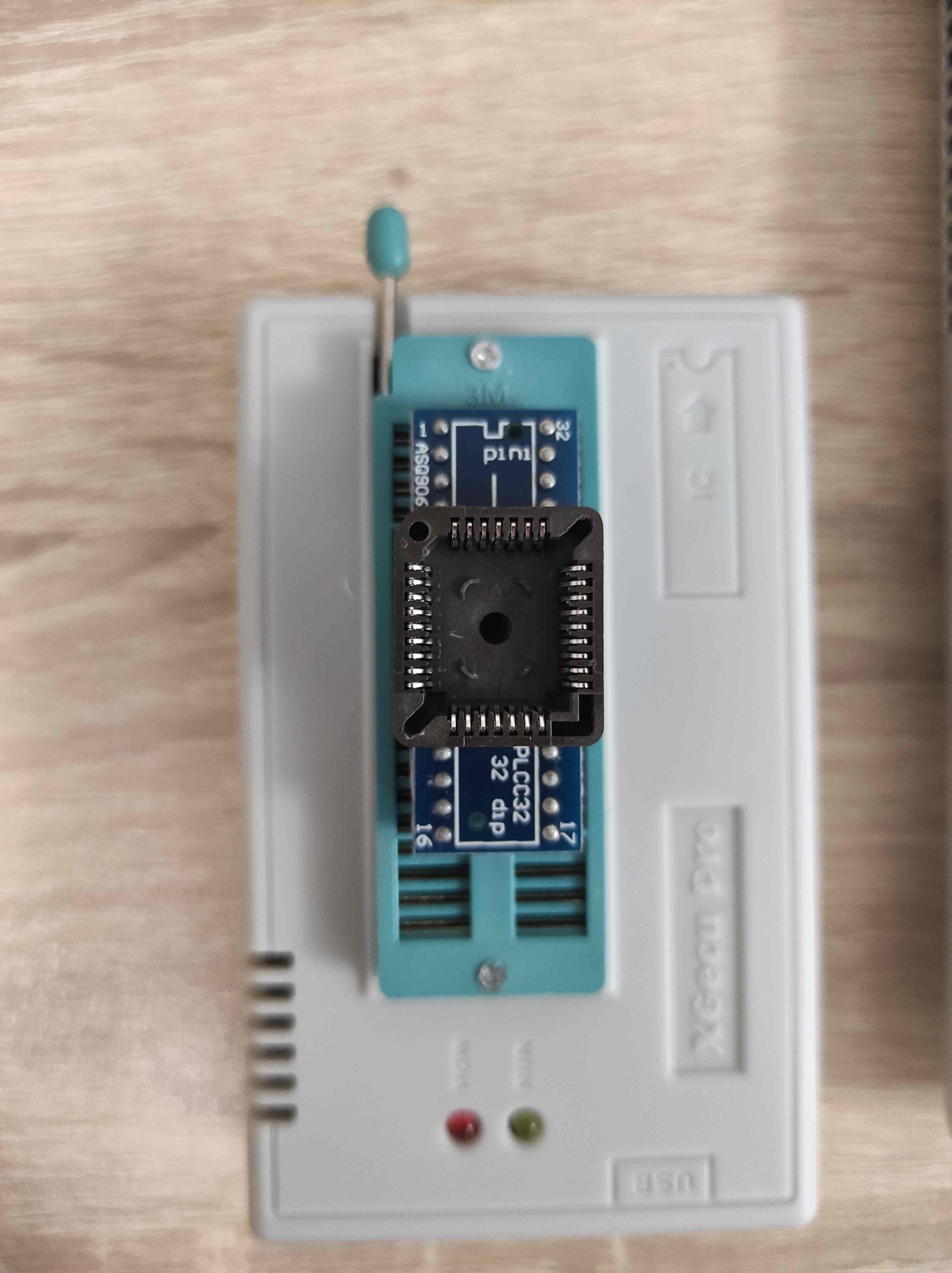

作者: apofview    时间: 2022-3-8 04:14
I have ASQ906 - PLCC32   adapter and did try with dip28 version but it did not work.
No jumper on my adapter?
Adapter is ASQ906 no jumper, Your is ADP-006.
So I need another adapter, thank You!

作者: admin    时间: 2022-3-8 08:50
回复 3# apofview
Use a special adapter:  PLCC32->DIP28

    As an User.....  The answer is yes, but it's a 'pain in the neck' not a single pin will remain in place, and the modified adapter may not work because of length of wiring, and the new adapter is less then 6

作者: apofview    时间: 2022-3-9 00:51
Thank You for Your act of kindness :victory:Xgecu official store responded under a day, and on aliexpress store added free shipping!
Adapter ordered.
