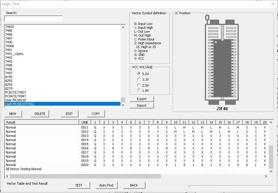

Hello, I have the same problem. I have tested more han 10 MC6821P chips and Autofind fails and Test fails by the TL866+.You can see here my 3 pictures attached.
Is there any specific setting to apply or something ?

Tl866 II, T48, T56, Not support this MC6821Chip.Best regards
作者: papi    时间: 2022-7-12 19:05
Thank you for your reply. But then why is it in the TL866II_List.txt ?
作者: admin    时间: 2022-7-15 15:21
回复 8# papi
Sorry.Because T48 and T866II is not a VCC on PIN20 , so it only Tested on T56.
and it is a bug we will fix it.
