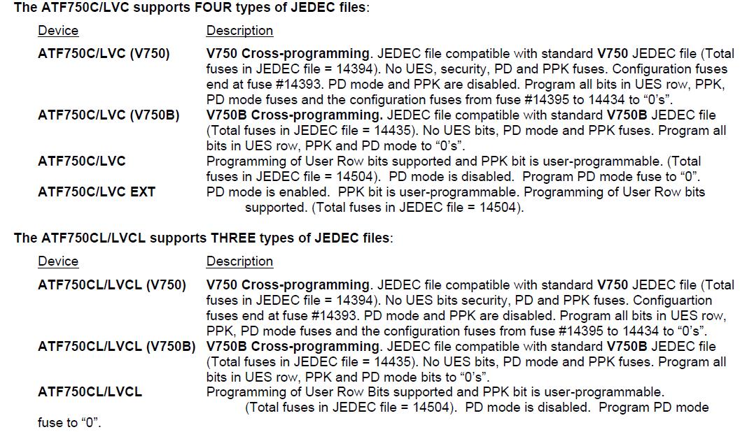

Use the correct JEDEC format file:
图片附件: ATF750C.jpg (2022-1-4 10:26, 166.63 KB) / 下载次数 19846

My chips are ATF750C-10PU, I generate JEDEC file for ATF750C (V750C in WinCUPL) (14504 fuses), and select ATF750C in Xgpro. I have tried many variations with generating JEDEC files for V750 and V750B and trying to program with the cross-programming options, but get eighter the same result or no working chip. test case.rar (4.97 KB)
I have made a new test case where each output pin (23 to 14) is toggled on clock pin 1 when pin 13 is low, or loaded with value from input (pin 2 to 11) when pin 13 is high. All outputs toggles correctly when pin 13 is low, but pin 18 to 14 allways loads low when pin 13 is high, even when all inpit pins are set high.

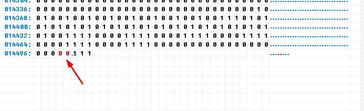

your JEDEC file only 14496 fuse .
try : chang 14499 14500  fuse into  0 0   after load jed file. then Programming it.
图片附件: 666.jpg (2022-1-5 10:00, 38.68 KB) / 下载次数 19091
http://forums.xgecu.com/attachment.php?aid=1132&k=756e09a5a78b68144823c4cf688499b4&t=1793836367&sid=8ZVjq5
作者: Harlon    时间: 2022-1-5 23:08
the last row of fuses (14496 to 14504) are all 0 and therefore not defined in the file, but the file seems to be defined for 14504 fuses with "*QF14504" on line 15. They are however all loaded as 0 in Xgpro. If i compile for input pin keeper (V750CPPK) fuse 14501 is set to 1 and has correct effect on the chip after programming (keeping input states), but no improvements on the logic for the flipflops.
