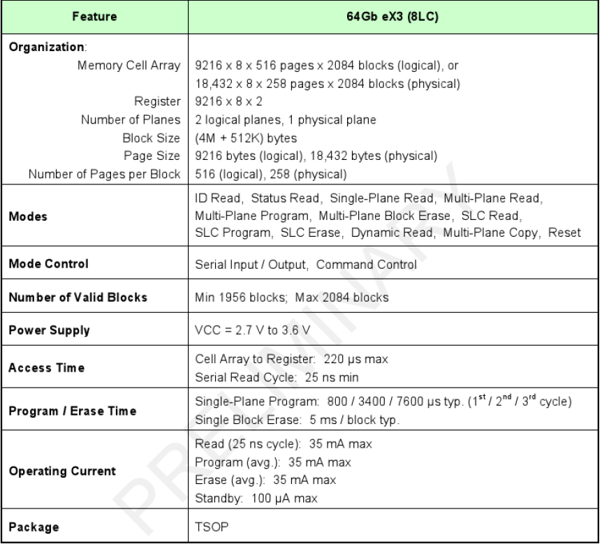

I have been trying to manually add a chip definition for the Sandisk SDTNPNAHEM-016G, but have had no success. I am using the settings gotten from the datasheet for the 008G model and increasing Page Size to get the larger chip.
XGecu crashes at various points during the read/verify phase on reading the chip. I have created both profiles for both the 008G and the 016G cersions but XGecu crashes on both.
I was able to get it to read with the 008G profile before updating the software, but I am not sure if that is the issue.
Any assistance would be greatly appreciated.

Thank you reaching out. I am not sure if it matters, but the chip in question is a 48-pin TSOP NAND.
I am at SW Version 11.71 and Firmware 00.1.51
I do not see a place to change the VIO in the Config tab, just the VCC, I have tried at VCC@2.5v (Below the operating voltage of 2.7v-3.3v) and VCC@3.0v to no luck.
I am not sure what 4bits mode is, unless it is Bit Flip Permission, which I tried as well at both voltages.
Attached is the Technical Specifications of the 008G version.
图片附件: Sandisk Snip.png (2021-12-30 03:33, 168.83 KB) / 下载次数 20019

Current Settings (Adjusted for the 016):
       PageSize :  16384
      SpareSize :  1024
Pages Per Block :  512
    Blocks Size :  8192KB + 512KB
   Total Blocks :  2084
    Device Size :  16GB + 1042MB
      Bus Width :  8
       nCE# Pin :  1
       nRB# PIN :  1
Is there anything that can be seen that I set up incorrectly in my settings, vs the datasheet?
作者: admin    时间: 2022-1-4 10:17
回复 6# SirA
this is 64Gb (8GB) memory:
Test:
PageSize :  16384
SpareSize :  2048
Pages Per Block :  256
Total Block : 2048
or
PageSize :  8192
SpareSize :  1024
Total Block : 2048
