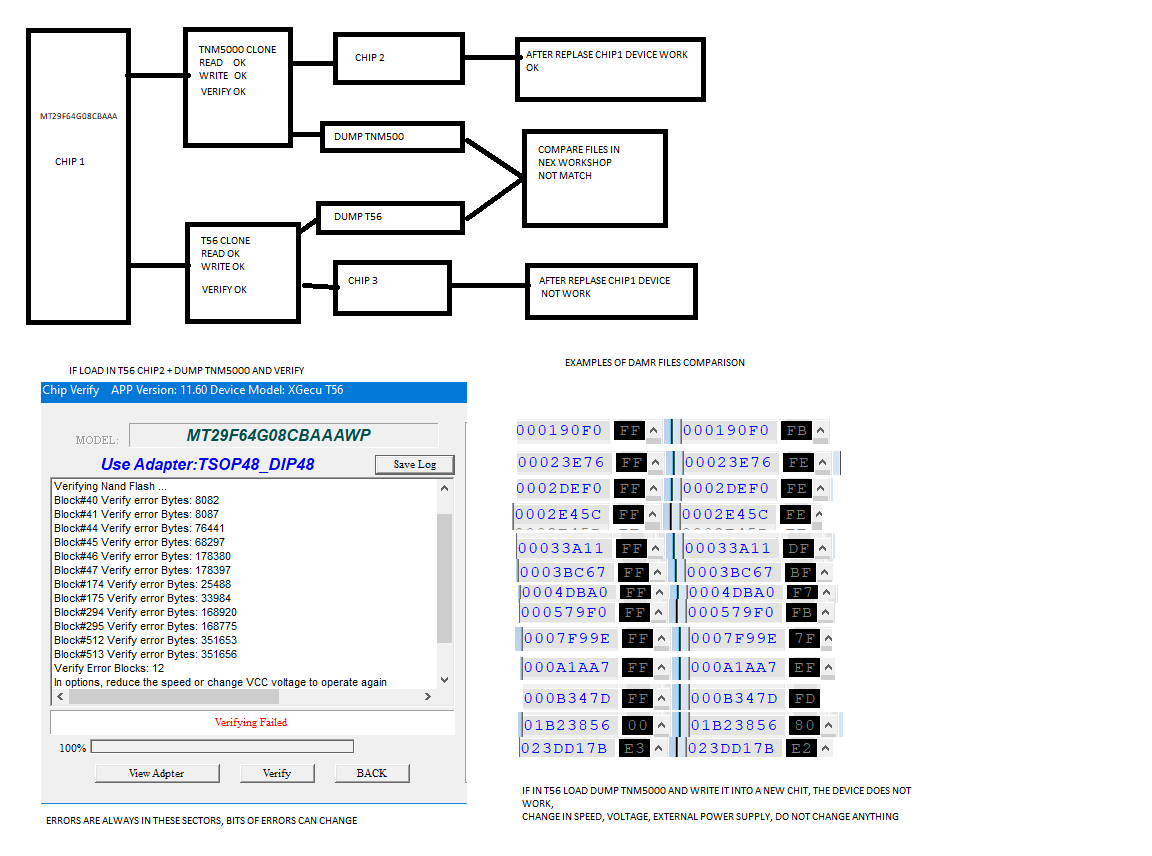

HI!!HELP ME)))Hi, I can't copy this microcircuit. the chips are in good working order, there are several of them and the result is the same with any of them. I took a TNM5000 from a friend to find out what was the matter,
maybe you can tell me something useful, with other microcircuits the programmer works fine
maybe you can tell me something useful, with other microcircuits the programmer works fine T56 ERR.png

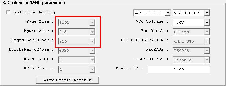

Compare whether the NAND parameters are the same as TNM5000
图片附件: NAND.jpg (2021-12-4 09:22, 32.75 KB) / 下载次数 28245
http://forums.xgecu.com/attachment.php?aid=1068&k=b434b249cff5d7e2aa6e2c2d55f453e2&t=1793245873&sid=4UoEx7

I will try to explain from the other side:
I take a working chip from a working device
clearing pins
insert and press ONFI
1-read & verify-ok, save dumpfile1.bin
2-read & verify-ok, save dumpfile2.bin
3-read & verify-ok, save dumpfile3.bin
between these actions, the chip and the programmer DO NOT TOUCH
when comparing, all files are different and all are verified on the programmer again
作者: admin    时间: 2021-12-11 08:00
回复 5# Artema
   this is normal,  Nand bits flip.  these error bits can be corrected by ECC correction when running.
  search on google about Nand bit flip.
  Related settings on the software:
  [Bit Flip Permission]
8b/512B  : Represent that it allow 8 bit errors in 512 bytes.

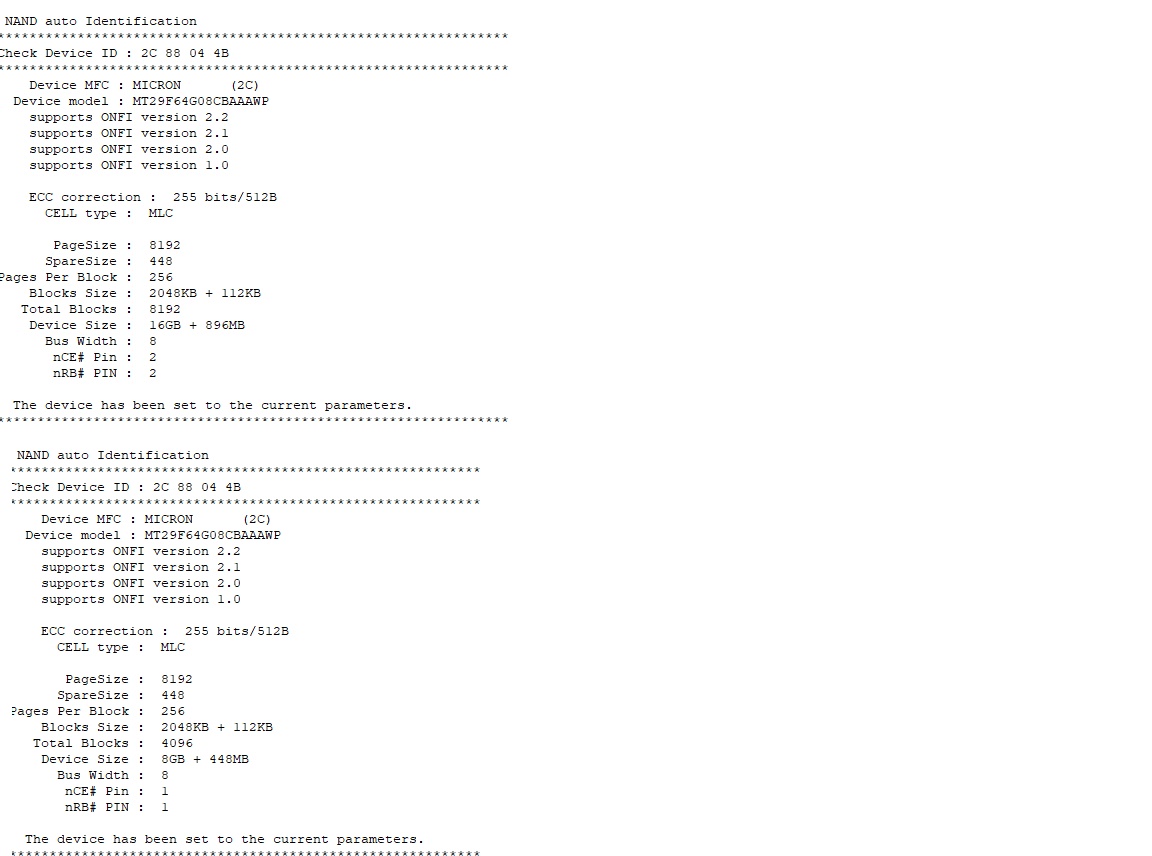

Hey! I tried to write a dump made by TNM5000 with different bit flip permission settings, the result is the same, the device does not work
it also happens that ONFI gives out incorrect data 16 instead of 8Gb
and ECC 255/512
图片附件: 000.jpg (2021-12-13 03:18, 154.52 KB) / 下载次数 29473
http://forums.xgecu.com/attachment.php?aid=1085&k=c9a1a14c4e538792d4862fb12dc994ff&t=1793245873&sid=4UoEx7
作者: admin    时间: 2021-12-13 13:45
回复 9# Artema
   ^^^^^Is it true?
I feel :
exactly the opposite , the file that TNM5000 read is wrong .
if T56 read wrong. It is impossible to pass the auto verification
for T56.
