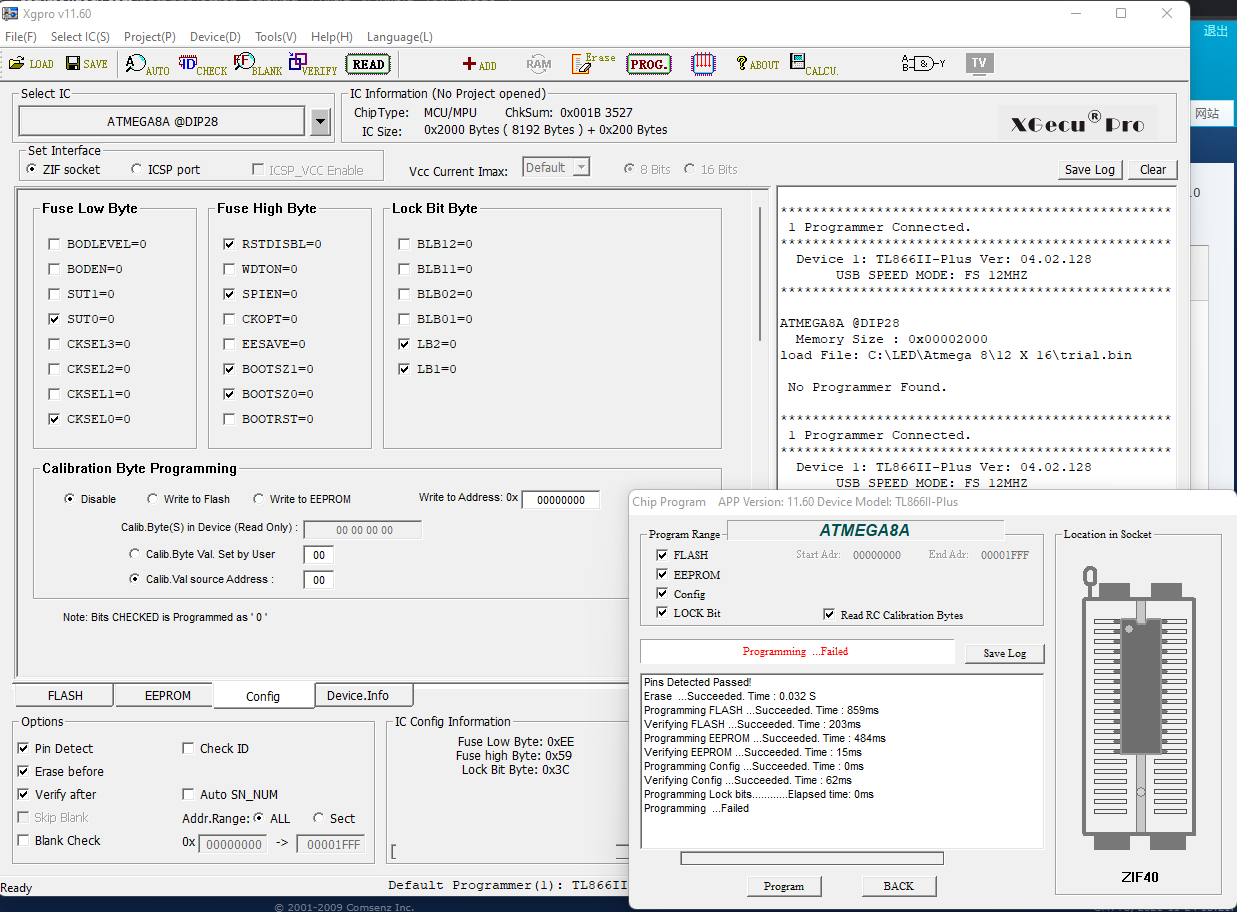

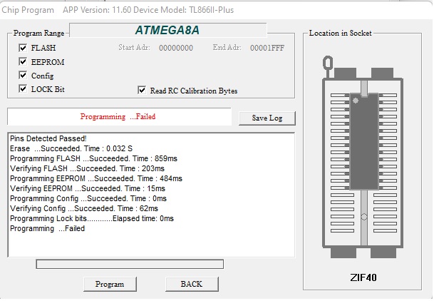

I am programming IC Atmega8A. While doing so, I am unable to protect it.
Program gets written in IC and works fine, but, IC remains unlocked.
Below is snippet of config and error. Please guide/help with resolution at earliest.
Regards,
Tejas S.
图片附件: Screenshot 2021-11-24 110631.png (2021-11-24 13:22, 120.35 KB) / 下载次数 18532
http://forums.xgecu.com/attachment.php?aid=1021&k=2e92f7bc2693c3bc1965f007f816d0c5&t=1793571265&sid=A633P6
作者: Tejas    时间: 2021-11-24 13:17     标题: Unable to protect Atmega8A
图片附件: Untitled.jpg (2021-11-24 13:19, 75.92 KB) / 下载次数 18165
http://forums.xgecu.com/attachment.php?aid=1020&k=54846481ca4a3968710b1d134578f3a3&t=1793571265&sid=A633P6
作者: Albano.Matos    时间: 2021-11-24 13:59
Tejas 发表于 2021-11-24 13:17
   Hello,            As a user.... I'll recommend the reading of thread atmega328p isuue - TL866II使用问题解答 - XGecu Programmer Forums - Powered by Discuz!  as it appears to be related, not the same, but maybe the same cause, that lead to the replacement of main exec of 11.6 app. Hopefully helps.
作者: Tejas    时间: 2021-11-24 15:13
It worked....Thanks!!!
