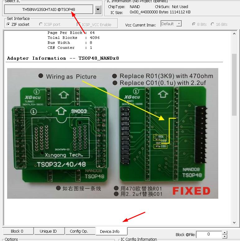

I am having constant pin error on any 48 pin chip, even new ones and good ones removed from a working TV, check adapter pins to IC with DMM and pass OK, did short test on adapter and passed too, I do not see this device send any power to the pin 12 and 13 in the toshiba TH58NVG3S0HTAI0 as this ones are the power pins, it just trow pin errors.

   Hello , I think , sorry if i'm wrong, the adapter you are using is for old models of TL866A-CS and not for TL866IIplus
I've ordered this one, link below,  and works ok , V2 the newer one, does not need modification (v1, does and is documented
in 10.30 software, if you press device info)

see <device Info>for correct adaper,

   Hello,            After select the correct IC to program, sometimes there are the same reference,
but different case, always do the way that Admin recommend.
As an example , selecting IC ... AC39LV088   and pressing 'device info', you will see the image
of adapter you already have. As most adapter have 2 stages, sometimes, the very same base
can be used with several top adapters. For TVs i prefer not shaping parts on critical parts, to
avoid bad contacts, and other damages, that's why i got V2.
Hope not confused you :-(

After I ordered the adapter I was able to read and write ,Thanks to all.
