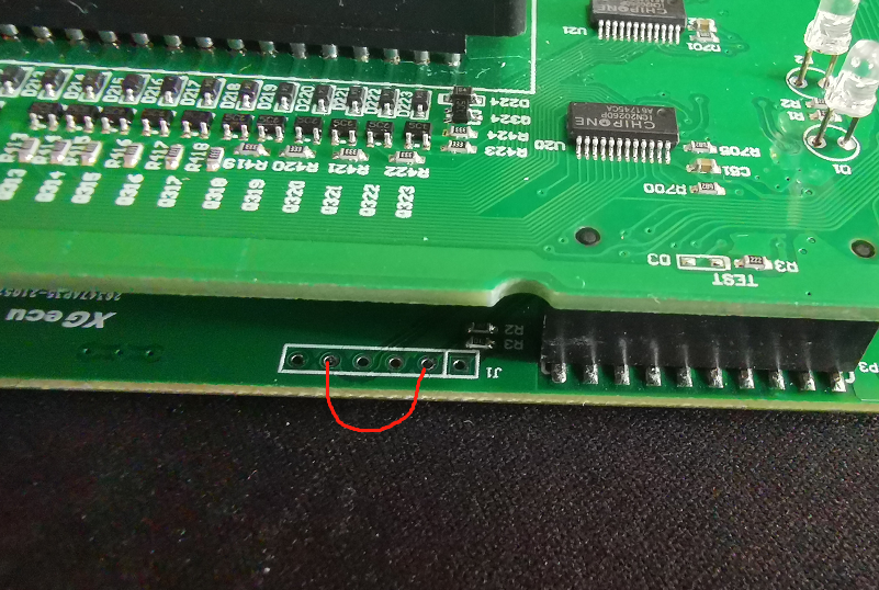

Hello.My T56 has stopped working. I bought it a few days ago and made a few copies of the DUMP on the 29F400BC. (version V1212 on Win 10) everything was ok, but unfortunately the day before the XGpro application did not want to open and I had to open the application twice but somehow it worked. today I connect the T56 unit to the pc and it was not detected? I replaced the USB cabel, checked another computer, did an apdate to V1215 and nothing. The device is not visible in the device manager? not even recognized? POW and RUN diodes are on all the time without blinking after connection.
作者: admin    时间: 2022-8-23 09:47
回复 4# CrisELDi
Disassemble the programmer and connect the ports PIN2 and PIN5 of J1 connector.
Power on the programmer, it will enter BOOT.if it is normal . reflash firmware.
then diconnect pin2 and pin5 of J1
图片附件: T56_BOOT.png (2022-8-23 09:46, 1016 KB) / 下载次数 30091
http://forums.xgecu.com/attachment.php?aid=1408&k=e3d342b356ea059326539e391532902b&t=1793741095&sid=qSc64d

Hi. I'm from Poland. A few days ago on Aliexpres I bought a new XGecu T56 programmer. I have a problem with him. The programmer is not recognized in any computer.
The latest software is properly installed.
I tested on different USB cables and on different computers with different operating systems.
After connecting to the computer, both LEDs (power and run) are on continuously. I didn't connect to the computer even once, I didn't do "Reflash firmware", because there was no such possibility. I'd rather save the hassle of returning to the store. Please help, is it possible to damage the programmer or rather the firmware?
I saw on the forum a description of how to go to BOOT mode by shorting J1 PIN2 and PIN5. Therefore, I have a question, where is the re-uploaded software? Thank you.

   Hello,            As a user.... As i know, jumpering pins as stated can recover the programmer from an incomplete flash,
as it will ( maybe) be recognized but not functional, and reflash option did not become available after Xgecu
software start, or if flash fail in early stages, and programmer isn't recognized at all, leds always on,
(if no hardware failure) it will be recognized and allow reflash to latest level within xgecu software.Normal Leds start sequence is 'Run' blinks a little and turn off, only 'power' stays on, starting xgecu software it will blink 'Run' briefly,
blink more often, when doing communication with programmer, or work with eprom in socket.
If you need permission to do it, wait, please, for ADMIN answer of ask the seller.
Latest firmware from Xgecu 12.50 , in my case, is now at version 1.68.
Hope not confused you.
