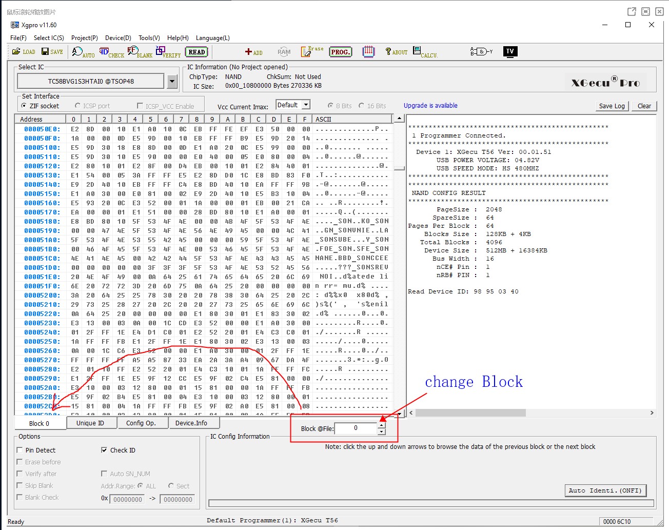

作者: krz1    时间: 2022-2-6 11:02
Hi, so somebody made for me a proper adapter board (see attached), I have soldered the flash chip, managed to read the ID and some data.
The chip is probably 512 MB judging as the user accessible filesystem is 251 MB.
However, only the first block of data is read. What could be the problem?
Also the user readable strings in the first block are all incorrect.
Could you give some advise on configuration? Current configuration is on screenshot.

作者: Albano.Matos    时间: 2022-2-6 12:52
Hi, so somebody made for me a proper adapter board (see attached), I have soldered the flash chip, m ...
krz1 发表于 2022-2-6 11:02
   As an user... have you tried upgrade to latest version of XGpro ?  It seem that you are running 11.6 and 11.81 is already out. Be careful, and try on another computer, to keep everything you are doing now...Hope it helps!
Download Newest XGecu T56/TL866II software(下载最新软件) - 编程器使用与软件下载 - XGecu Programmer Forums - Powered by Discuz!
作者: krz1    时间: 2022-2-6 18:19
The issue of user-readable strings appears to be the difference in little-endian - big-endian.
I will try the new version of xgecu.
作者: krz1    时间: 2022-2-6 19:01

作者: admin    时间: 2022-2-8 16:10
回复 30# krz1
图片附件: 阿里旺旺图片20220208162416.jpg (2022-2-8 16:10, 398.44 KB) / 下载次数 33907
http://forums.xgecu.com/attachment.php?aid=1153&k=ecbd48d7fe34b0dda4b29110aa32dc4d&t=1793384966&sid=qWxtwk
作者: krz1    时间: 2022-2-9 00:26
回复  krz1
admin 发表于 2022-2-8 16:10
Probably, I was not clear enough. Only the first block (or "0" on your image) has any significant data.
All the other blocks (1 through 4095) show "FFFFF", that is they are read as empty. This cannot be, as there was at least 64 megabytes of user data on that phone.
作者: krz1    时间: 2022-2-9 04:38
As far as I can tell, this is the correct config.
However it still reads empty space past first block.
Also bug - this custom configuration cannot be saved. It defaults to bus width 8 bits, page size 2048, spare size 64, and page number 4096. Other data is saved.
Config file and dump attached. Config file is either being saved or loaded incorrectly!
