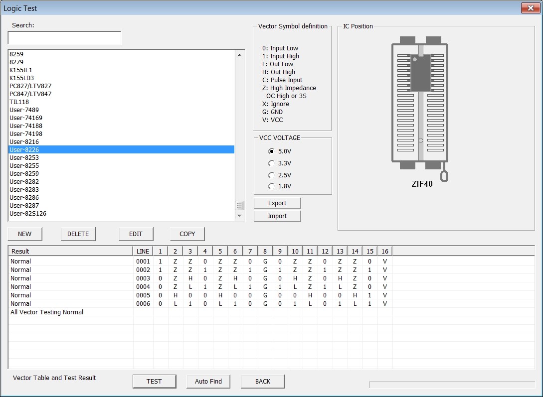

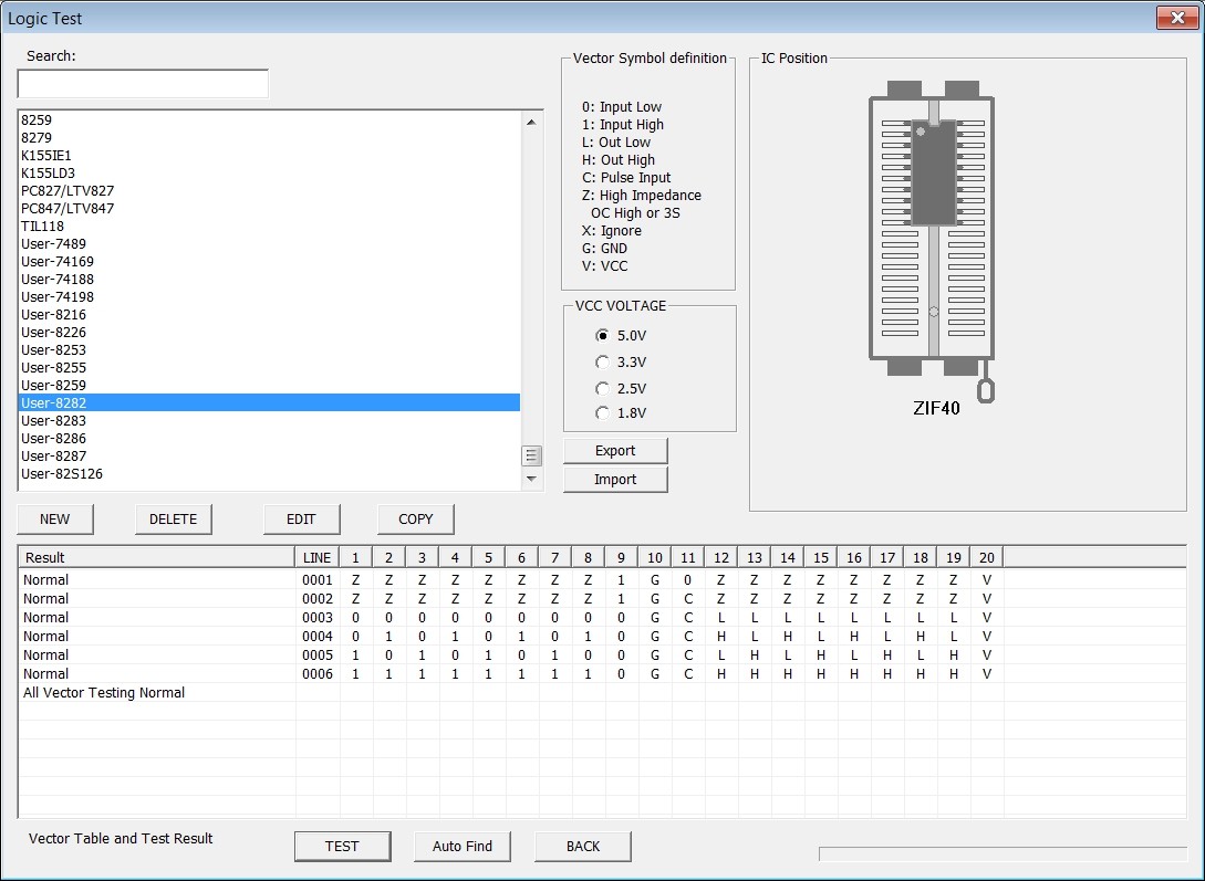

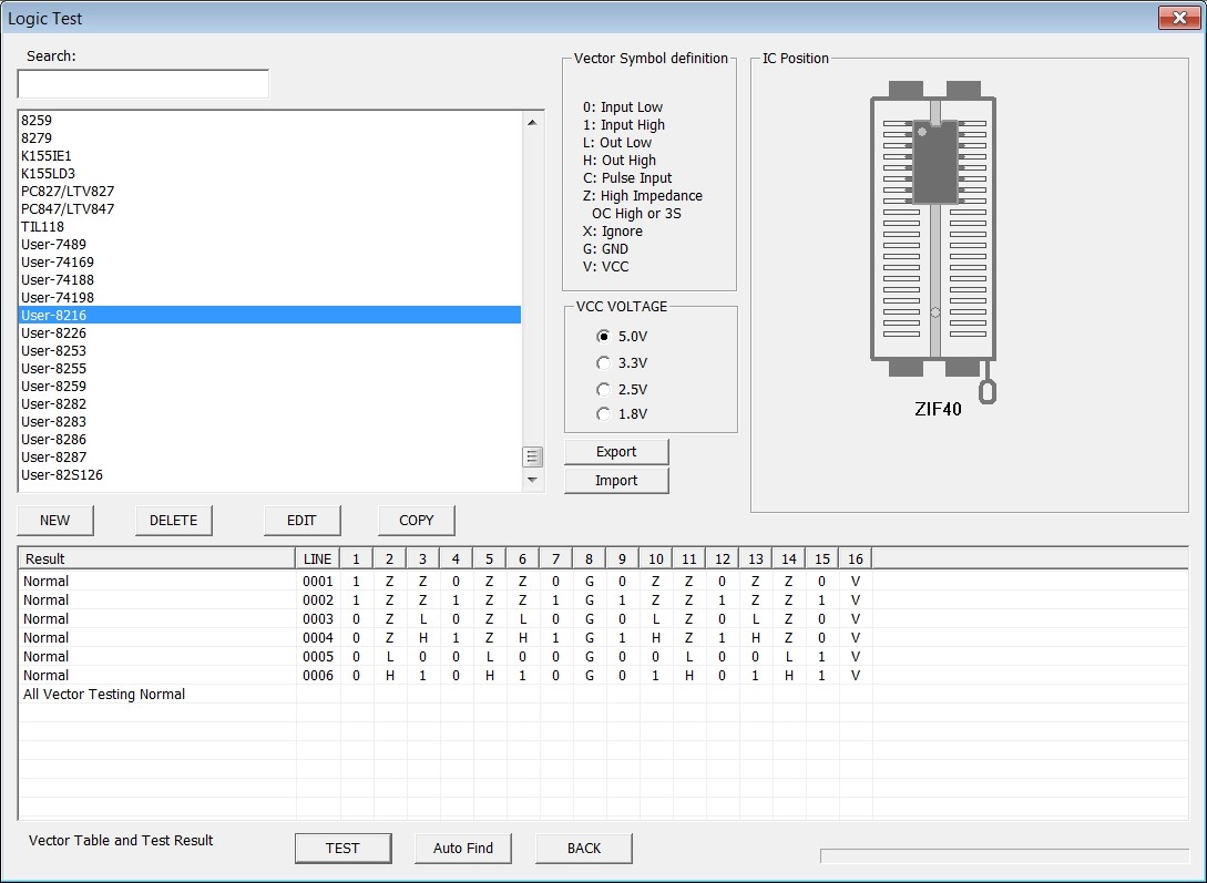

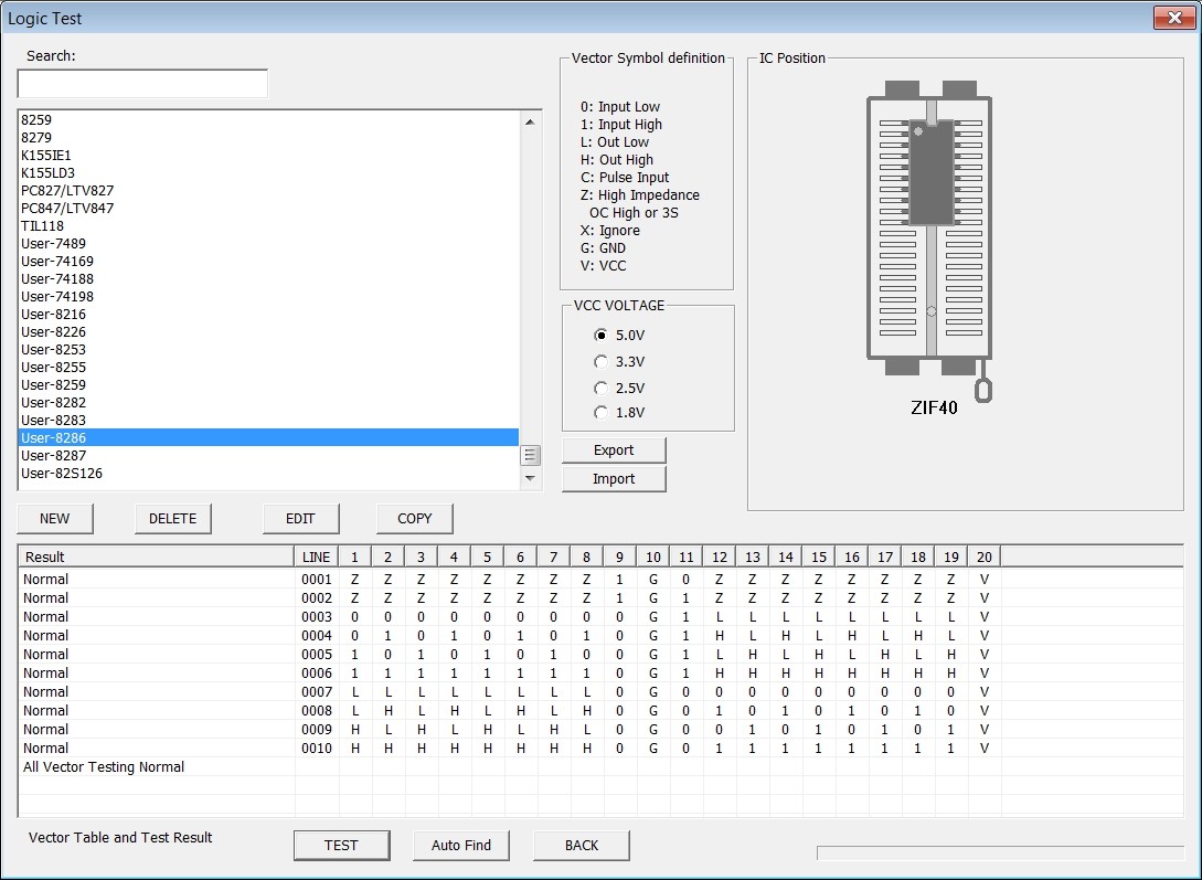

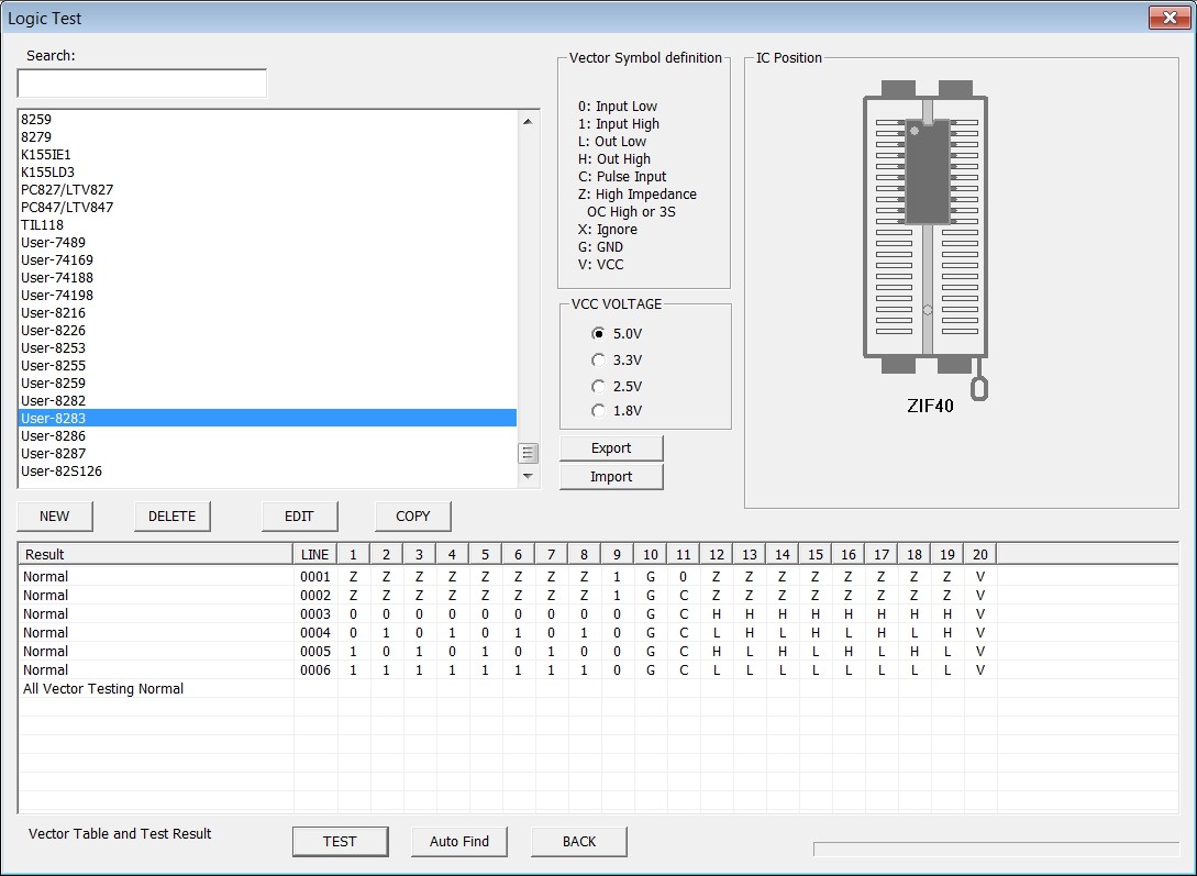

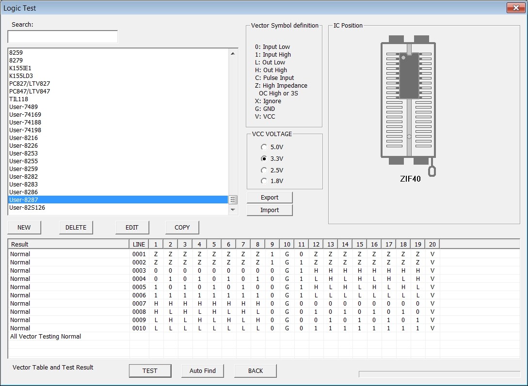

标题:
New Logic Test - 8216, 8226, 8282, 8283, 8286, 8287 Vector Table
