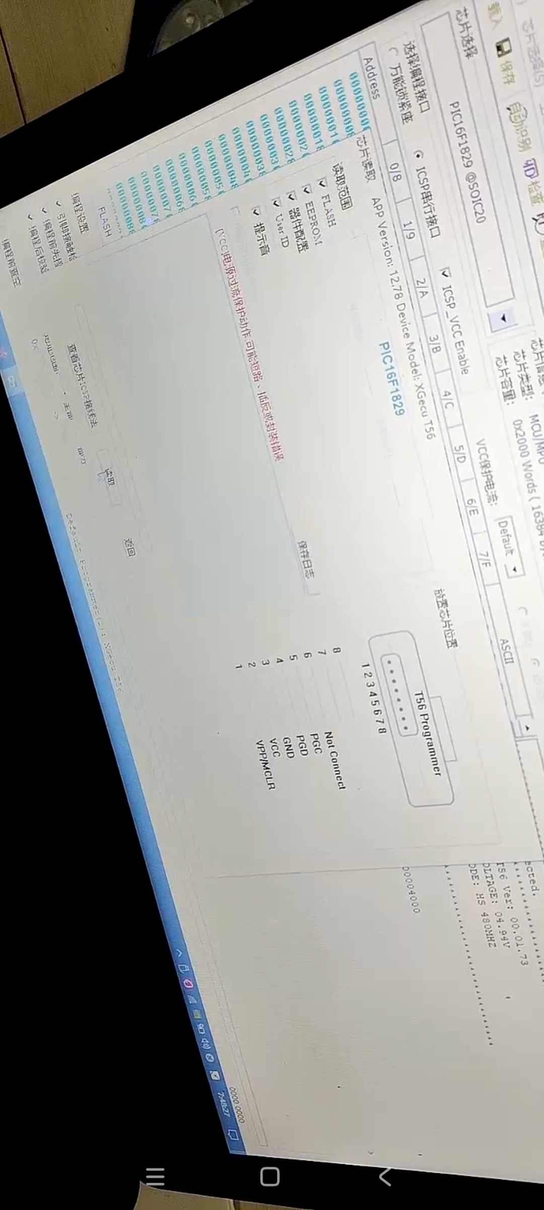

作者: 佳维    时间: 2026-2-9 20:02     标题: T56编程器ICSP读写PIC单片机过流,不接目标板也过流,自检又是正常的
T56编程器ICSP读写PIC单片机过流,不接目标板也过流,电流调最大(目标板工作电流10ma)也是过流,去掉勾选vcc enable也会过流(偶尔能正常,外接供电能正常读写),试过12.78后所有版本现象均一样,编程器自检又是正常的,24年6月购买后固件已首次更新,现有版本软件固件更新均为灰色,已求解决方案

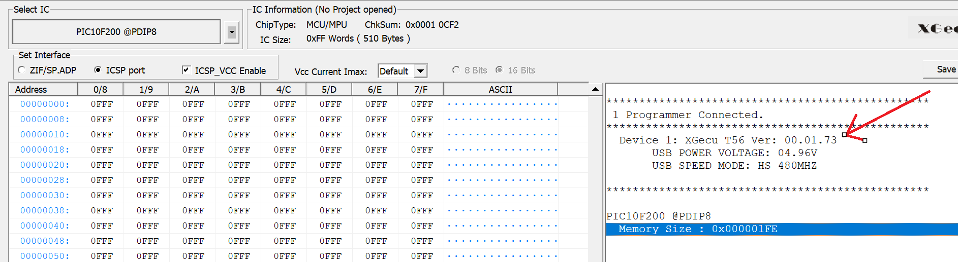

作者: Albano.Matos    时间: 2026-2-11 07:31
T56编程器ICSP读写PIC单片机过流,不接目标板也过流,电流调最大(目标板工作电流10ma)也是过流,去掉勾选 ...
佳维 发表于 2026-2-9 20:02
Hello Javi,
               As a user like you, and trying to understand if i can help.
When you connect the T56, look to arrow in the picture for the fw version, please post it, and the voltage you see displayed.
Also post were you get the messages for overcurrent, and version of software you use now.
Also, please post the IC were you see the problem, just to try the same here.
   Rgds

作者: 佳维    时间: 2026-2-11 11:17
空编程器都报短路,开关vcc都会报,固件1.73,12.66等老版本软件会提示硬件固件不支持,usb电压4.94V,换电脑换USB线均没有用,偶尔能关vcc才能目标板外接电源读写,如实拍视频截图(手机上传可能有重复)[attach]2438[/attach]

作者: 佳维    时间: 2026-2-11 11:23
Screenshot_2026-02-11-11-09-55-837_com.tencent.mobileqq.jpg 回复 3# 佳维
图片附件: [空编程器] Screenshot_2026-02-11-11-09-49-533_com.tencent.mobileqq.jpg (2026-2-11 11:19, 985.63 KB) / 下载次数 2867
http://forums.xgecu.com/attachment.php?aid=2443&k=9c857902f5231a861f48e64c26a7c08d&t=1793230462&sid=y8Leal
图片附件: [ICSP过流保护,开关vcc均过流] Screenshot_2026-02-11-11-09-55-837_com.tencent.mobileqq.jpg (2026-2-11 11:20, 640.03 KB) / 下载次数 2917
http://forums.xgecu.com/attachment.php?aid=2444&k=f4b80bccc791718e130bf93f7ffa6765&t=1793230462&sid=y8Leal
图片附件: [自检是正常的] Screenshot_2026-02-11-11-22-34-823_com.tencent.mobileqq.jpg (2026-2-11 11:22, 789.4 KB) / 下载次数 2845
http://forums.xgecu.com/attachment.php?aid=2445&k=76f2d52bee53cede7bb3625419283fe3&t=1793230462&sid=y8Leal
作者: 佳维    时间: 2026-2-11 11:24
每次烧录要花费很长的时间,半天难得碰到一次正常,急求解决方案,谢谢
作者: 佳维    时间: 2026-2-11 11:27
以上视频12.78--13.10所有版本均已测试,ICSP过流报警不能操作的情况一样
