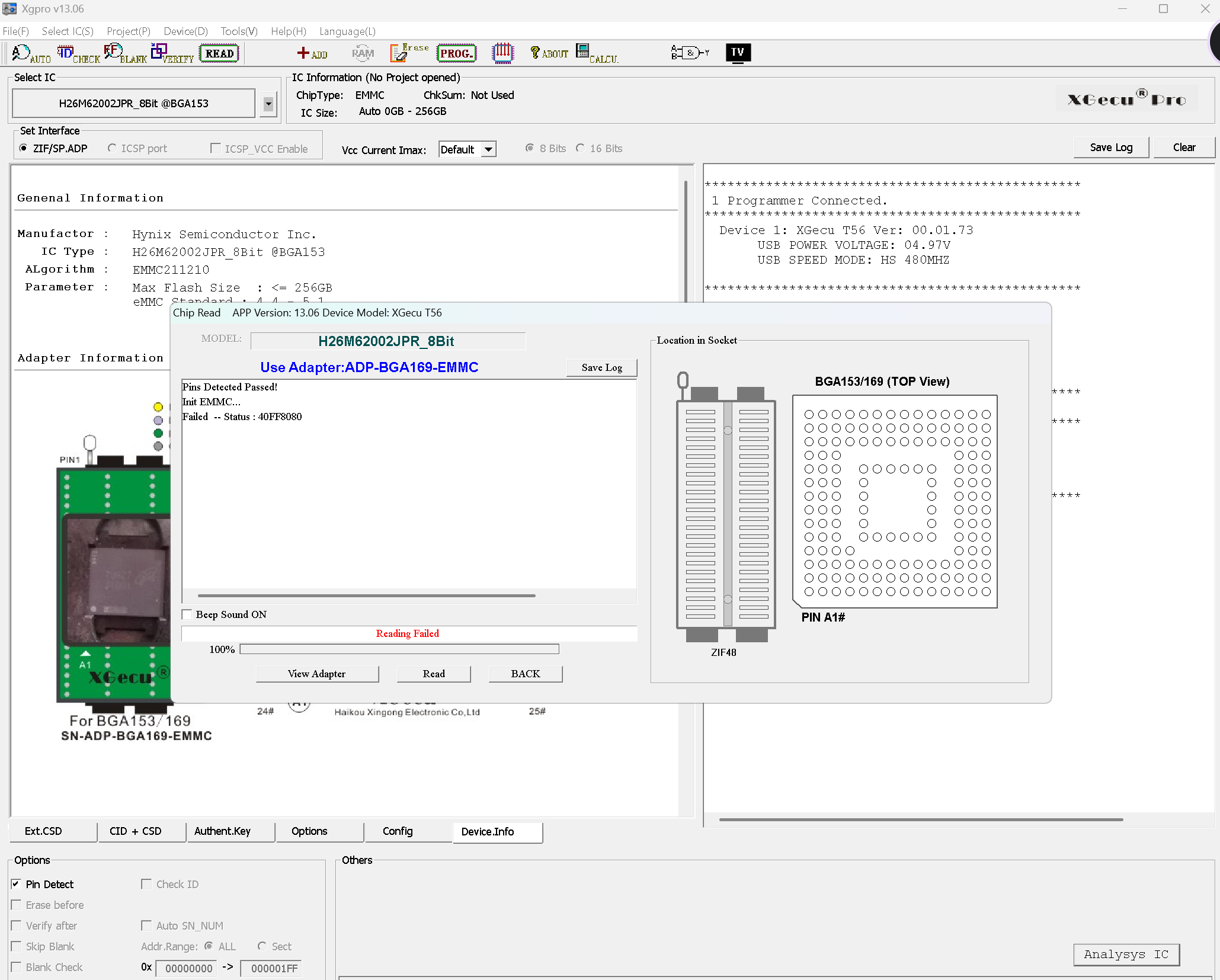

作者: luzmina    时间: 2025-11-24 04:56     标题: T56 Error reading H26M62002JPR
I got a used and a brand new with same error, no able to Analyzed or read the EMMC.
APP Version : 13.06   Model : T56  MFG:2022-03-06
     Device : H26M62002JPR_8Bit @BGA153
1 Programmer Connected.
  Device 1: XGecu T56 Ver: 00.01.73
       USB POWER VOLTAGE: 04.70V
       USB SPEED MODE: HS 480MHZ
  < Analysis  IC >
    Pin Detected Passed.
      * Clock Frequence is 8.000 MHZ   *
      1..Emmc Initialization ......
      Failed  -- CMD1 Respond error Status: 40FF8080 ERROR CODE: 1
Reading error:
Pins Detected Passed!
Init EMMC...
Failed  -- Status : 40FF8080

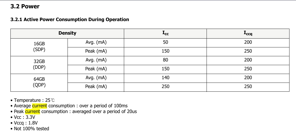

             Trying to see in datasheet https://datasheet.lcsc.com/lcsc/2204261415_SK-HYNIX-H26M62002JPR_C3002776.pdf  if any helpful info is there, but so far do not yet  find a reason. Hopefully it can be fixed for you, or if bad ICs, or any software limitation that prevent read, but that shouldn't occur in new, but never used Ic.
In the mean time, found this info that can be relevant, that may indicate that the IC draw a bit more current then default and need an adjustment of 'vcc current imax' ...
图片附件: Screenshot 2025-11-29 032754.png (2025-11-29 11:28, 87.6 KB) / 下载次数 2451
http://forums.xgecu.com/attachment.php?aid=2419&k=33608d00e4c040ea8a1ab1af379d8454&t=1793223378&sid=u166z6

Using my adapter, same as yours, got same inititialisation error return code,

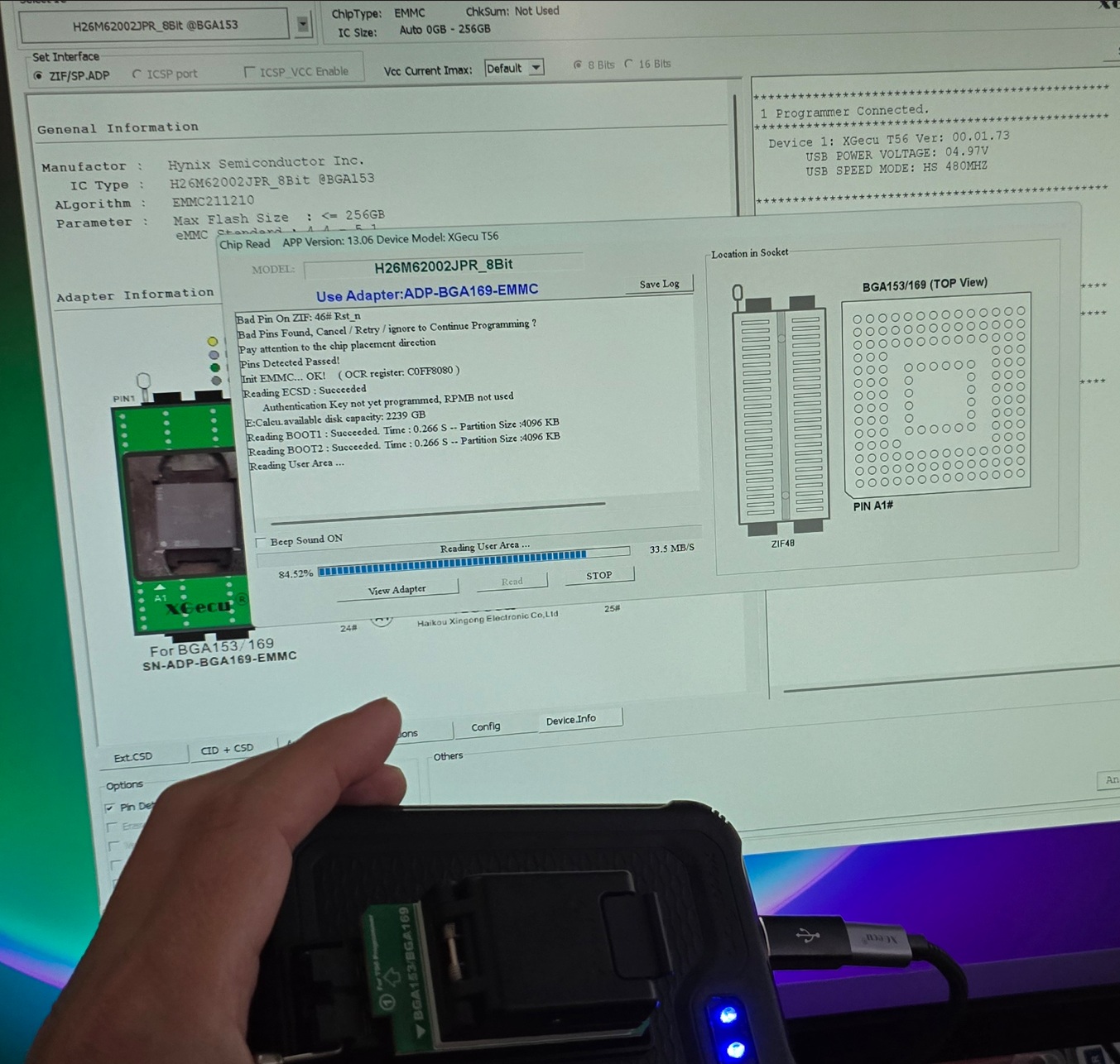

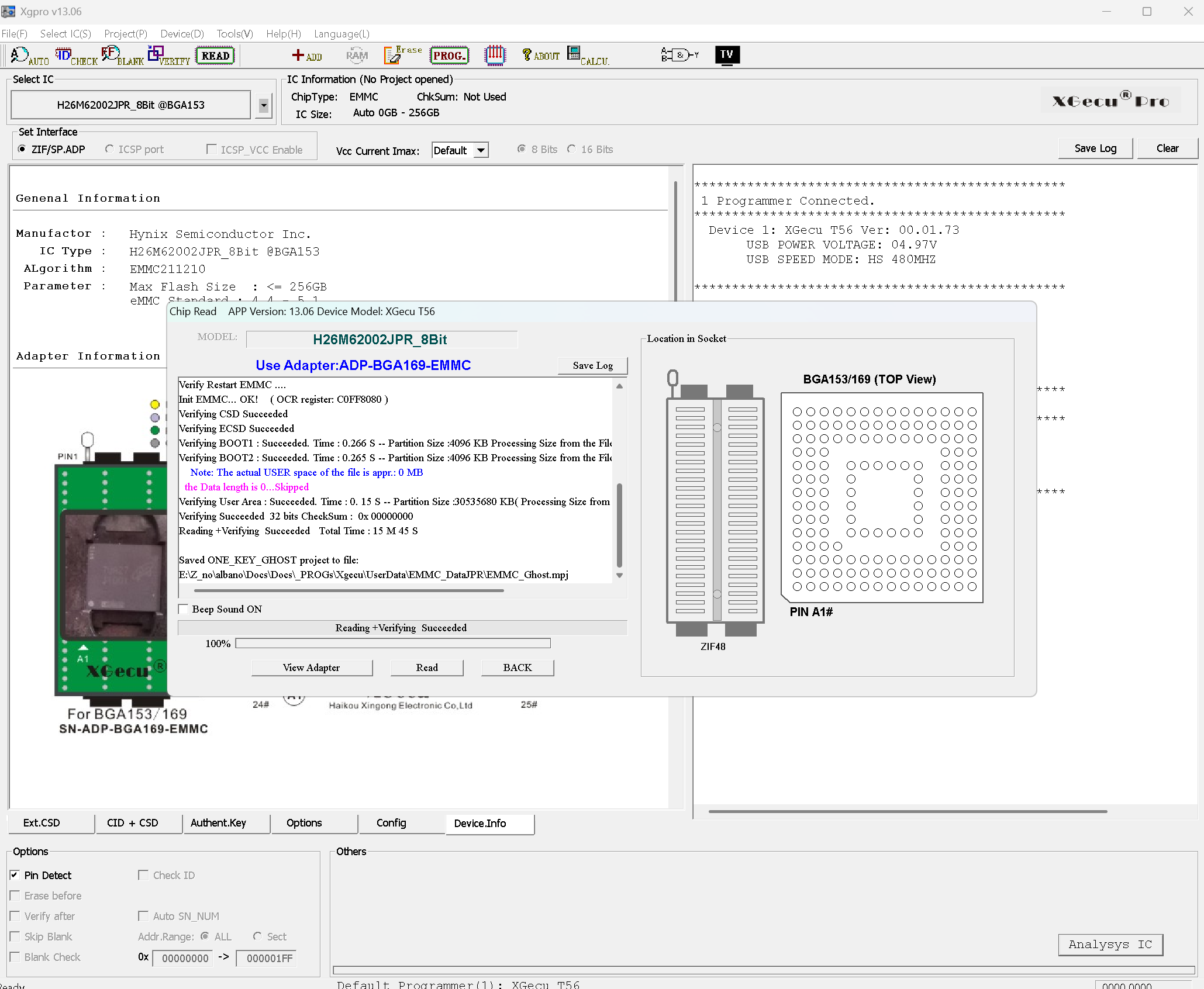

but, as i've told you, T56 have several adapters to read BGA153, and have it here and tested both and it works with latest one
https://xgecu.myshopify.com/products/emmc-bga153-bga169-adapter-ic-socket-for-xgecu-t56-programmer-with-du
Maybe this help ADMIN to fix issue,  give a tip, or an answer that isn't expected at all....

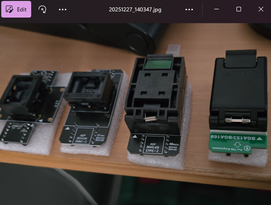

    Hello again,
                      I've asked Ali XGECU store to help. The first answer i receive was i was the only one complaining :'(...
and accept to test the very latest two BGA153/169 adapters, cheaper ones with only one format, not 3 or five with different
size adapters provided as previous.
And all those adapters fail the simple read test with H26M62002JPR, except adapter number 4, that is, currently, discontinued.
Hoppefully, or they update the software, and or firmware, a new hardware adapter, discontinued for T56 is needed to read this IC. Lets wait to see the development. I've sent them all picture tests from failure and sucess.
Best Regards
图片附件: Screenshot 2025-12-27 145453.png (2025-12-27 23:10, 672.18 KB) / 下载次数 2481

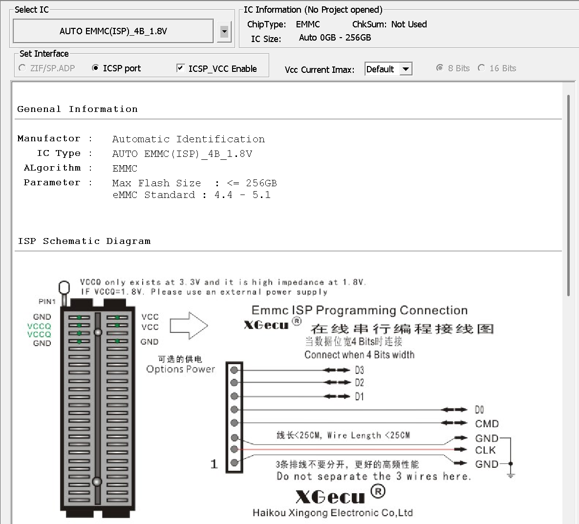

My plan is to use the last adapter and rewire to use the ISP connector and see if the T56 can read the chip, they do not provide the schematic of the adapter, so it will take me a few hours to do it. Thanks
作者: Albano.Matos    时间: 2026-1-17 10:11
My plan is to use the last adapter and rewire to use the ISP connector and see if the T56 can read t ...
luzmina 发表于 2026-1-17 05:25
Using ISP.... till 4 bit only, slower, and select auto  xxxxxxx, see picture
图片附件: Screenshot 2026-01-17 020529.png (2026-1-17 10:11, 234.07 KB) / 下载次数 1918
http://forums.xgecu.com/attachment.php?aid=2432&k=0d9a956cf2190f194345e78fed0d6d49&t=1793223378&sid=u166z6
