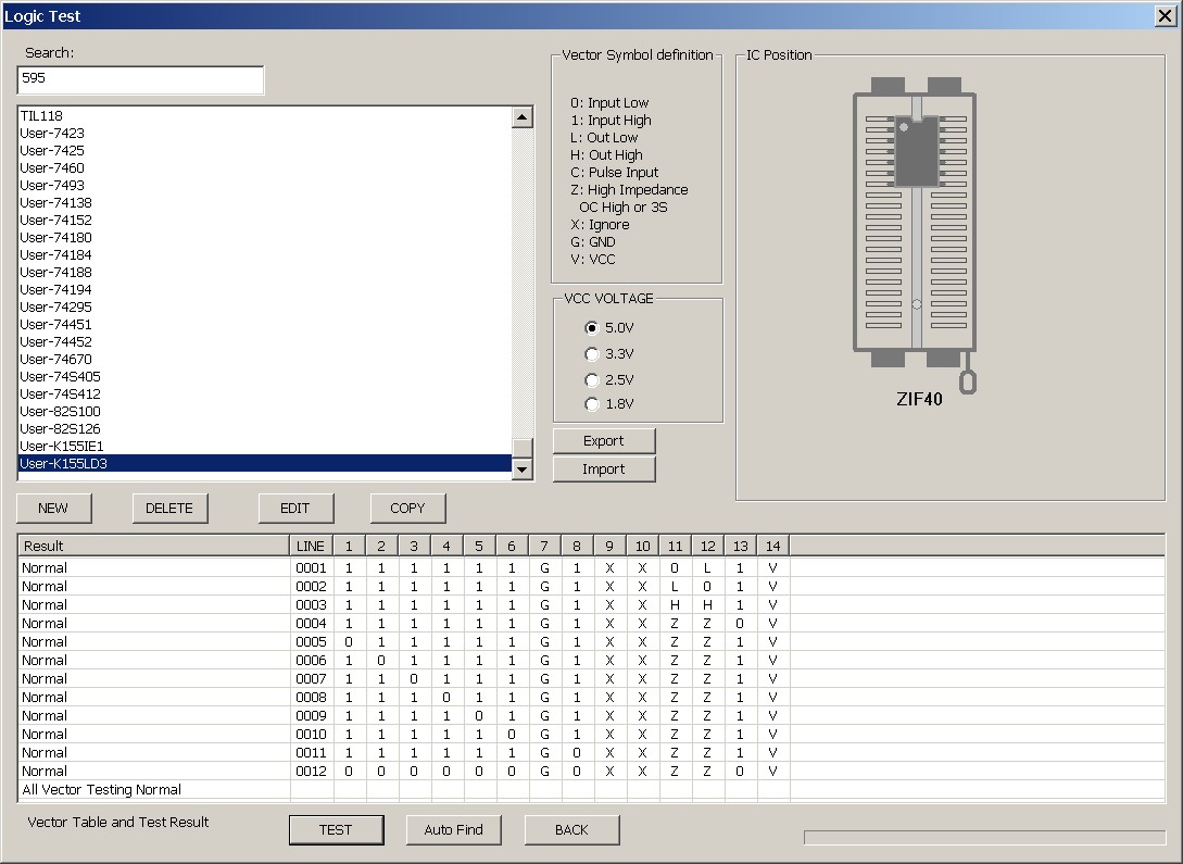

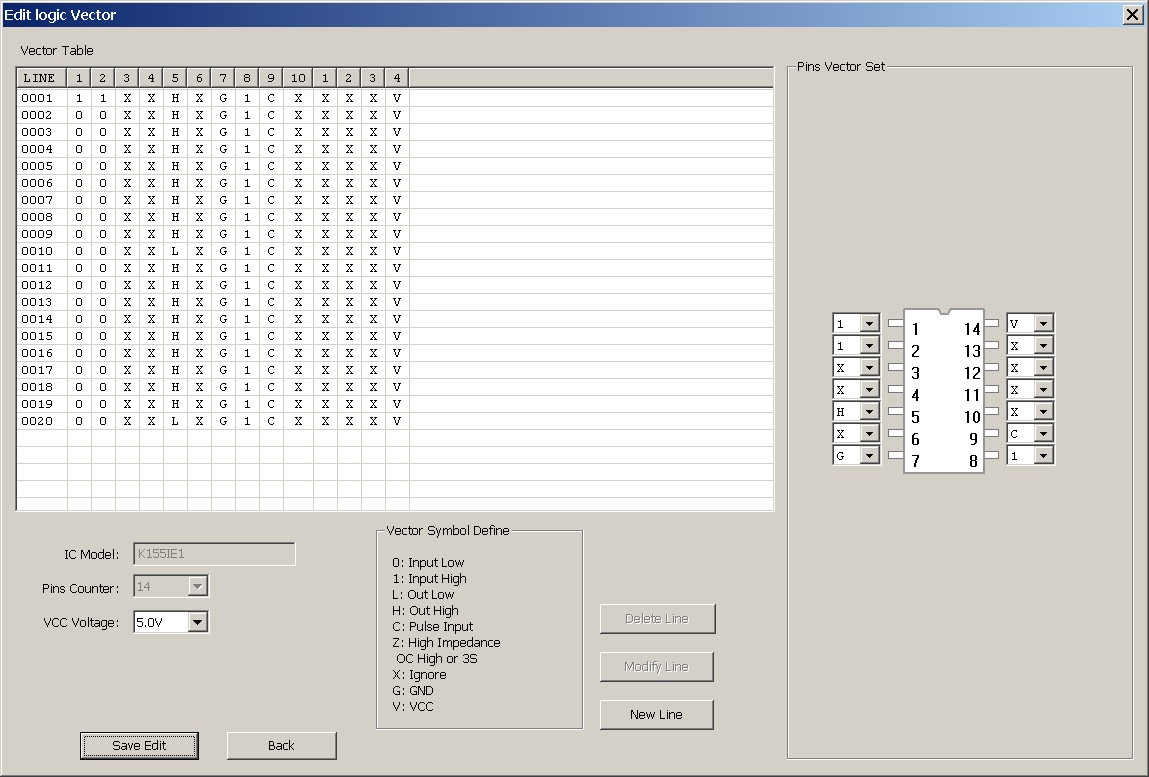

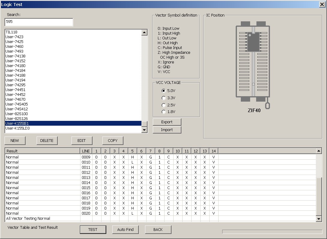

The test was performed on the K155IE1 (
DECADE COUNTER
(148.33 KB)
2025-8-19 03:33
(152.2 KB)
2025-8-19 03:33
K155IE1.lgc
(2.53 KB)
下载次数: 1866
2025-8-19 03:32

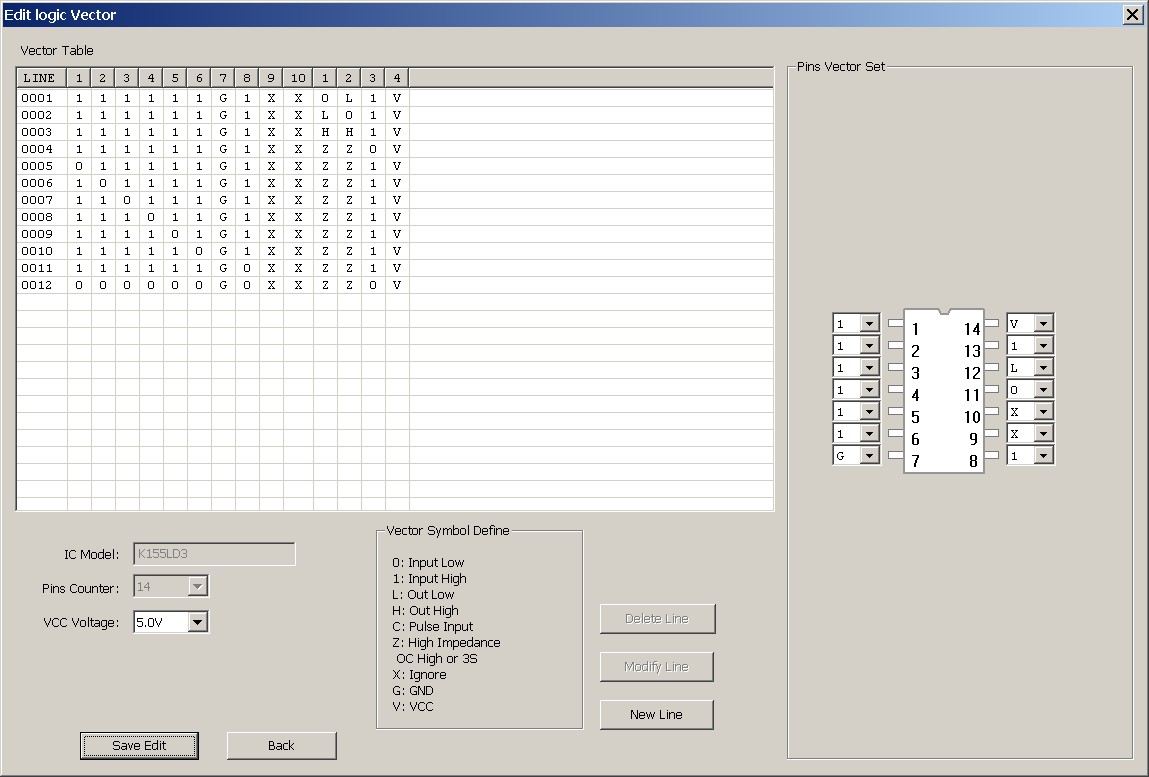

The test was performed on the K155LD3 (
8-INPUT EXPANDERS
(123.77 KB)
2025-8-19 03:33
(148.21 KB)
2025-8-19 03:33
K155LD3.lgc
(2.34 KB)
下载次数: 1814
