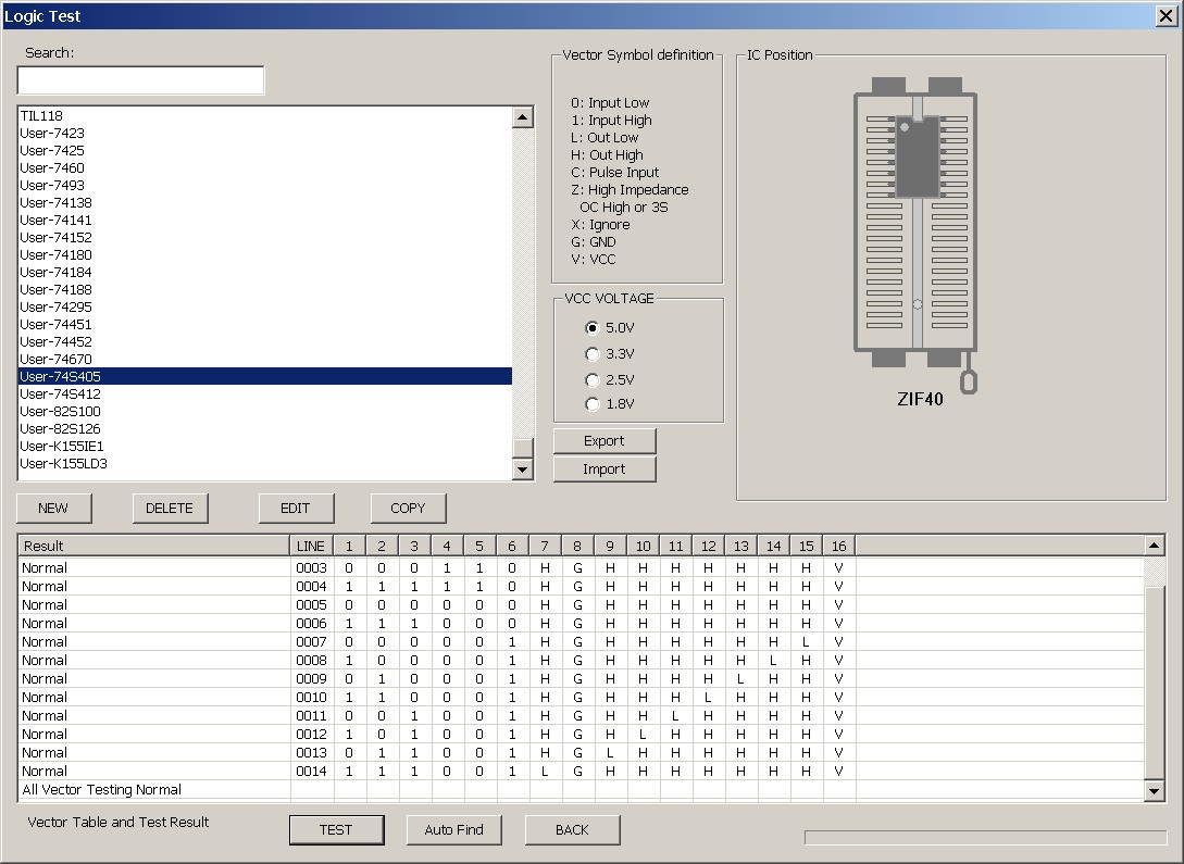

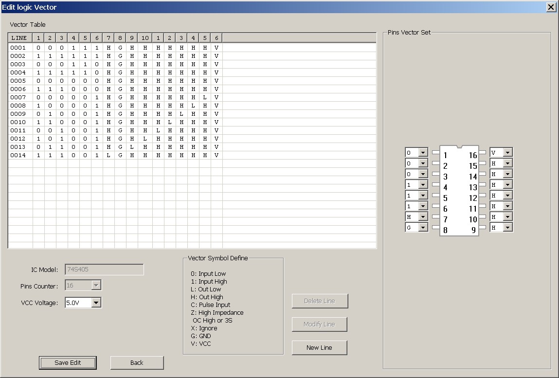

The test was performed on the UCY74S405N (Dekoder binarny 1 z 8):
(140.86 KB)
2025-8-13 02:13
(153.8 KB)
2025-8-13 02:14

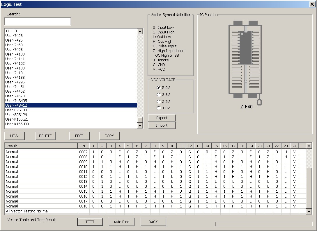

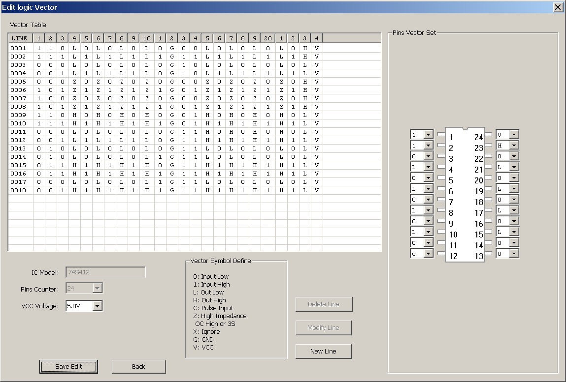

The test was performed on the UCY74S412N (8-bitowa brama We/Wy):
(174.84 KB)
2025-8-13 02:17
(168.04 KB)
2025-8-13 02:17
