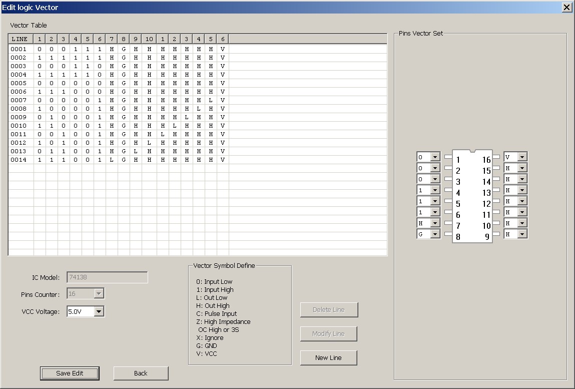

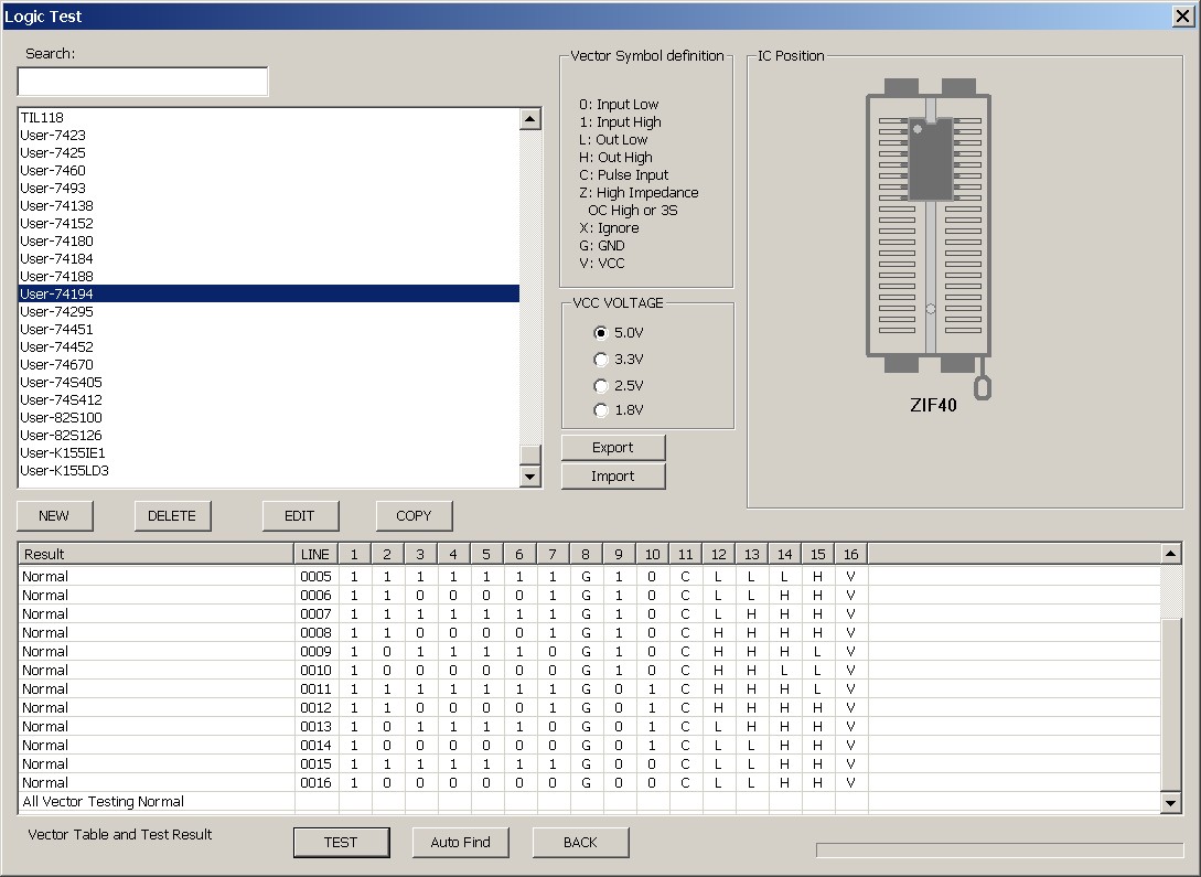

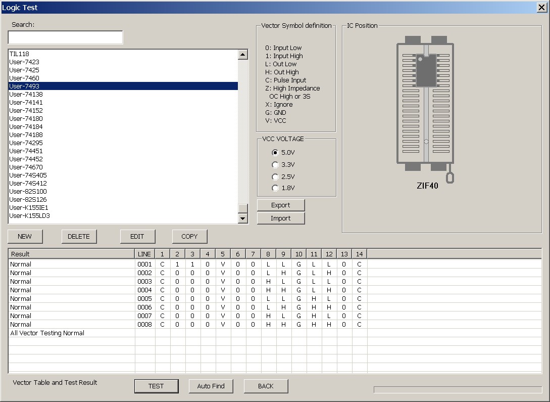

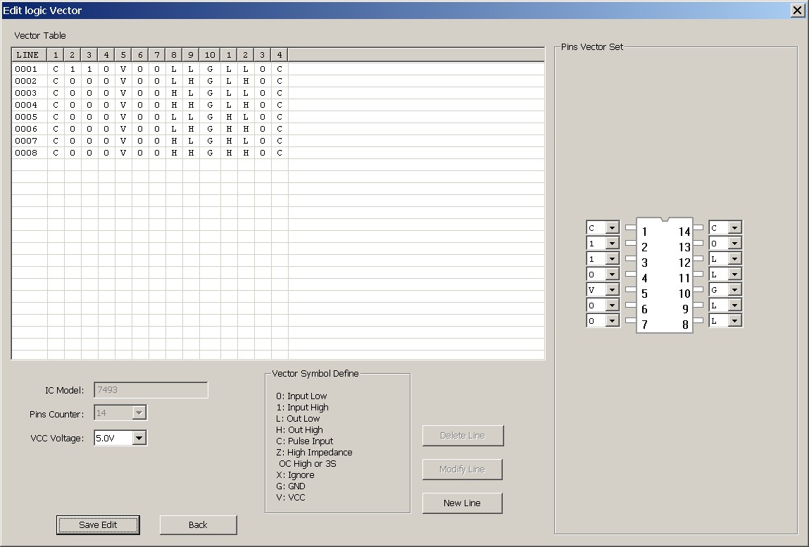

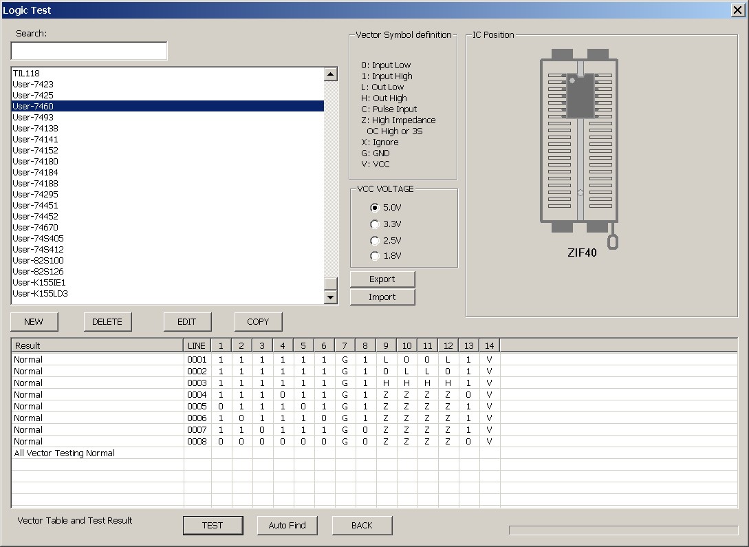

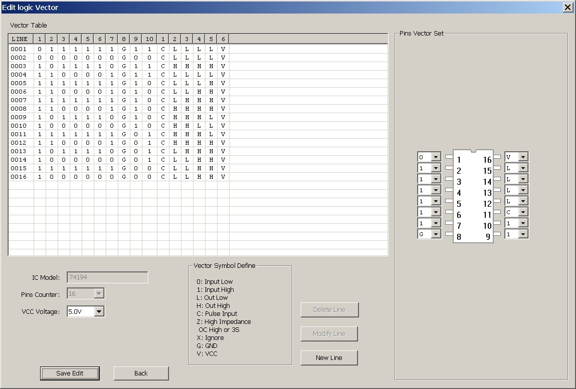

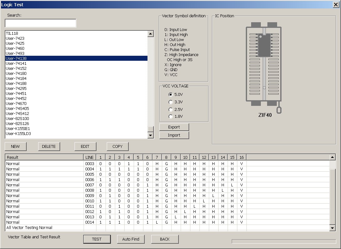

Corrected Logic Test - 7460, 7493, 74138, 74194 Vector Table
Attached is a revised Vector Table for the 7460, 7493, 74138, 74194 logic IC.
