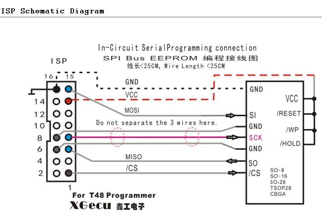

I have been trying to program a M95640-W for a while using ISP and the connections stated for the chip. I can read the chip but when I try to program the chip (just the status register) I get the reply during the verification phase that the programmed value is not identical to the one on the chip. Even though the xgPro program states the operation was successful.
I have connected a logic analyzer to debug the communication. I can see that a WREN (Write enable) operation is send, but it is followed by a RDSR (Read status register) operation, while I expected a WRSR (Write status register). What am I missing here?

I have added some images that hopefully should explain what I am doing. I am trying to program the status register to see the operations. However, I can see that I am missing the WRSR (Write status register) operation after WREN (Write Enable)

图片附件: [Schematics] M95640-W schematic connection - no test connections.jpg (2025-3-20 01:08, 49.33 KB) / 下载次数 3651
http://forums.xgecu.com/attachment.php?aid=2275&k=2a523bf49f6bf317c8ea3894e597cce6&t=1793663751&sid=IWJZ03

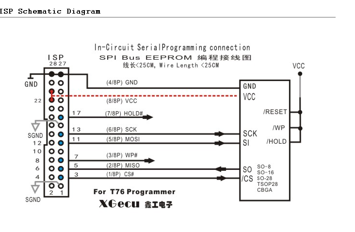

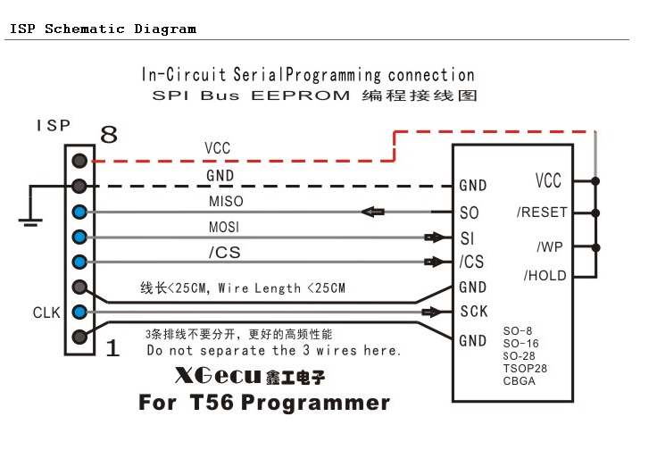

作者: Albano.Matos    时间: 2025-3-21 22:48
Thanks for the suggestion about the cable length. The current cable length is more like 30-40 cm.
Test 发表于 2025-3-21 20:38
Hello, voltage can be stable for M95640W, from 2.5 to 5.5v, but 'stable'
as per datasheet, but in circuit with other ICs can be higher or lower....
[attach]2277[/attach]
You can see that they recommend lower then 25cm... For T76, T56 or T48, and recommendations
for clock lines....
Screenshot 2025-03-21 143857.png Screenshot 2025-03-21 144058.png Screenshot 2025-03-21 144220.png
You show, in the proto board the IC in an adapter that may fit the programmer socket directly,
then length cables at the lowest :-)
If any software change that may help you, hopefully Admin read this, and implement.
Rgds

作者: Test    时间: 2025-3-22 01:59
Sorry,I haven't specified that I am using a T48.
I am following the guide for the clock. The M95640W is shown in the schematic and could be wrongly interpreted as being in a programmer socket, but it isn't. I have used in-circuit (ISP) using a similar probe as 1PCS Ultra long spring clip burning needle burning writing cable download cable no disassembly chip freeing hands - AliExpress 13.
I will try with a shorter cable to see if that makes a difference.
