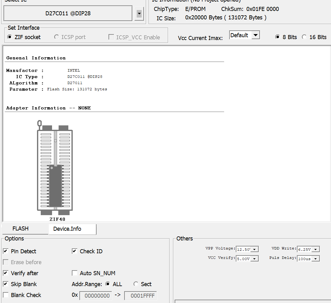

    Dear Richard,                         As you say that new version did not work, can you, please tell us,
as you have a patch to get it to work, as they have included new a D27C011, that use same algoritm
as D27011, which values are shown in the 'others' section at bottom of app window?
for me it shows... the voltages show the same as defaluts on both ICs, normal and 'C' versions.
Yesterday cleaned the label from more then 50 ICs, but still no luck with a 27011 to test :'(
Best Regards
图片附件: Screenshot 2024-06-16 101001.png (2024-6-16 17:17, 46.42 KB) / 下载次数 34386
http://forums.xgecu.com/attachment.php?aid=2230&k=06e7f3c7f1e0fc5950f320cf1ddb2e66&t=1793840578&sid=2AicaH

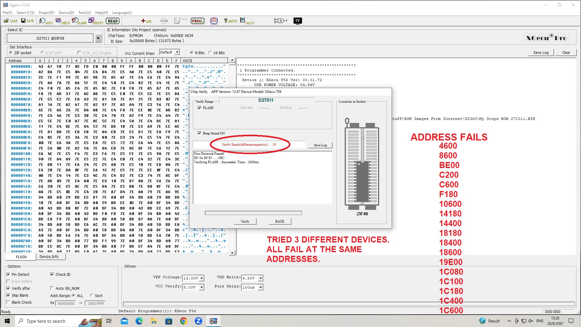

作者: lungchard    时间: 2024-7-11 12:35
Hello Sir,
I have returned the unit to XGecu agent in china. They will send it to the factory for testing.
I have sent them a 27011 and a 27C011 Eprom to test the unit.
I have also sent them the .bin file I am trying to write to the Eprom.
I see from your post you are using different voltages than what I used.
Do not use the defaults, they do not work.
VPP must be 13v and VDD must be 6.5v.
See the device data sheet at the end of page 4-192.
This shows the required voltages for quick pulse programming which I believe is what the T56 is using.
17.75V VPP is not an option on Xgpro so use 13V. The device maximum is 14V so OK to use 13V.
6.25V VCC is also not an option on Xgpro so use 6.5V.
These settings do program the device but with 18 repeatable errors. See my screen shot.
Once I get feedback from XGecu I will post the news here.
Bye for now,
Richard.
[attach]2234[/attach]
[attach]2235[/attach]
附件: Intel D27011 EPROM Datasheet.pdf (2024-7-11 12:35, 450.9 KB) / 下载次数 28627
http://forums.xgecu.com/attachment.php?aid=2237&k=7e25409aa6eb05d5cf1b1629e17b6f03&t=1793840578&sid=2AicaH
作者: lungchard    时间: 2024-7-11 12:50
Hello Sir,
Typo in first reply.
VPP is not 17.5V on the data sheet, it is 12.75V.
6.25V for VDD write is selectable but I used 6.5V. Device maximum is 7V on data sheet.
Also my screen shot was not attached. I will try to attach it again.
Hope this update includes picture, it is important information.
Richard.
图片附件: Verify Fail.jpg (2024-7-11 12:48, 599.69 KB) / 下载次数 43259
http://forums.xgecu.com/attachment.php?aid=2238&k=b4b92225e3d19535bdcf27af75a02a76&t=1793840578&sid=2AicaH

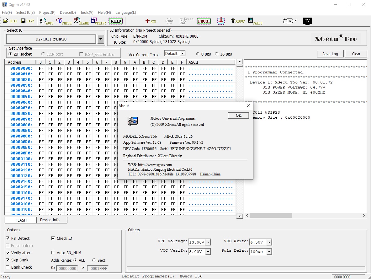

作者: lungchard    时间: 2024-8-3 11:49
Hello All,
I have received my T56 back from XGecu and I can now programme 27011 and 27C011 eproms.
Not sure what they did to the unit but it now works.
The version of app software is 12.68 and the firmware version is 00.1.72.
Not sure if these are updated versions as I do not recall the version numbers from before I sent it back for repair.
Anyway, the good news is it now works.
XGecu assistance with this problem has restored my faith in their after sales service.
Best wishes
Richard,
Thailand.
作者: Albano.Matos    时间: 2024-8-3 13:52
Hello All,
lungchard 发表于 2024-8-3 11:49
    Hello Richard,                         I guess the problem was only the software needs update, you mention ver 12.68, firmware still the
same as 12.67. As version 12.68 isn't yet available for download, it will soon for sure. Lets wait for it.
I think you made the very best, sending the samples with the programmer.
For worst cases, as many versions/batches available, having samples for test is the best way for quality work, Admin request

作者: lungchard    时间: 2024-8-3 16:54
The software versions I have are shown in the attached screen shot. T56 Version Numbers.jpg
图片附件: T56 Version Numbers.jpg (2024-8-3 16:53, 361.72 KB) / 下载次数 38403
http://forums.xgecu.com/attachment.php?aid=2248&k=02a959d27429b9f313829f7073d08ef3&t=1793840578&sid=2AicaH
作者: Test    时间: 2024-8-4 00:41
Отговор 21# lungchard
As the screenshot shows V12.68 I assume this is an insider engineering version of the software with disabled restrictions. Where can it be downloaded from, there is no such version officially?
作者: lungchard    时间: 2024-8-4 11:24
You can find the download on the website www.hklrf.comSearch for T56 and you can find download option there.
They are an official XGecu agent and do NOT sell cheap Chinese copies. They sell original genuine product only.
