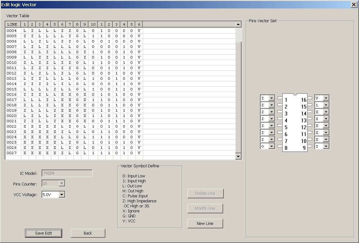

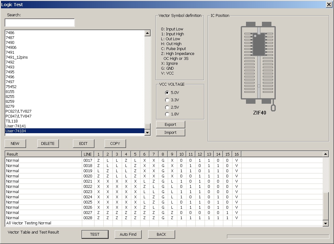

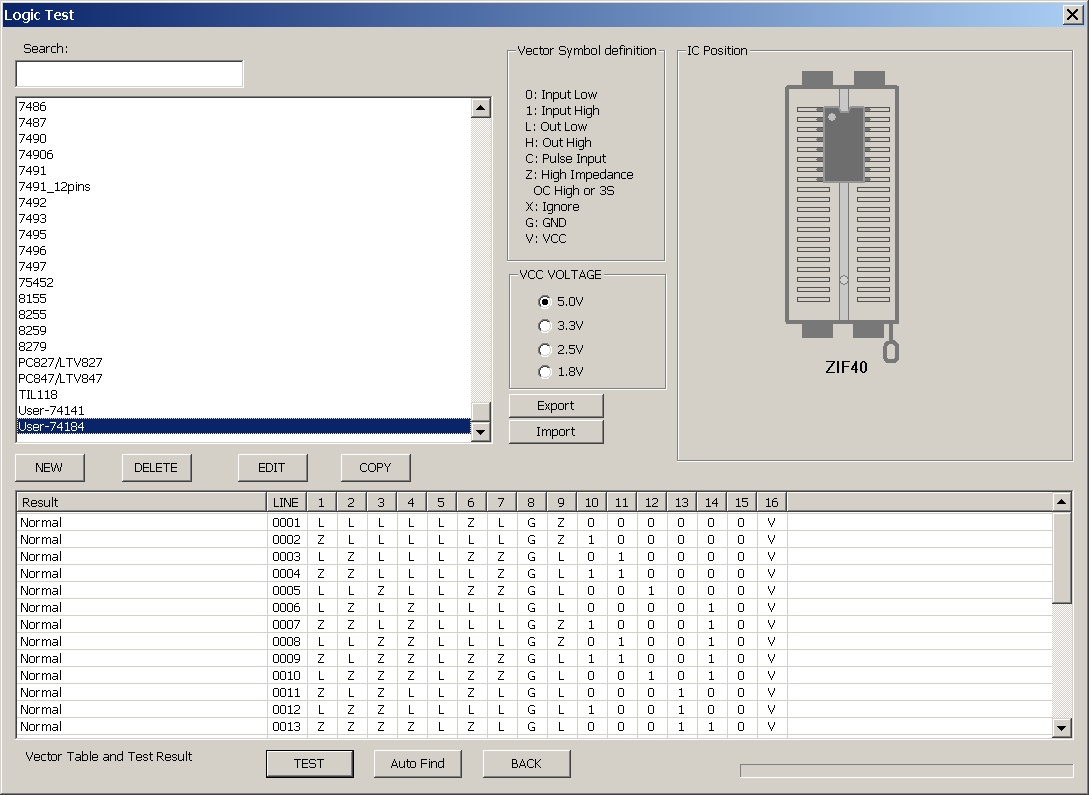

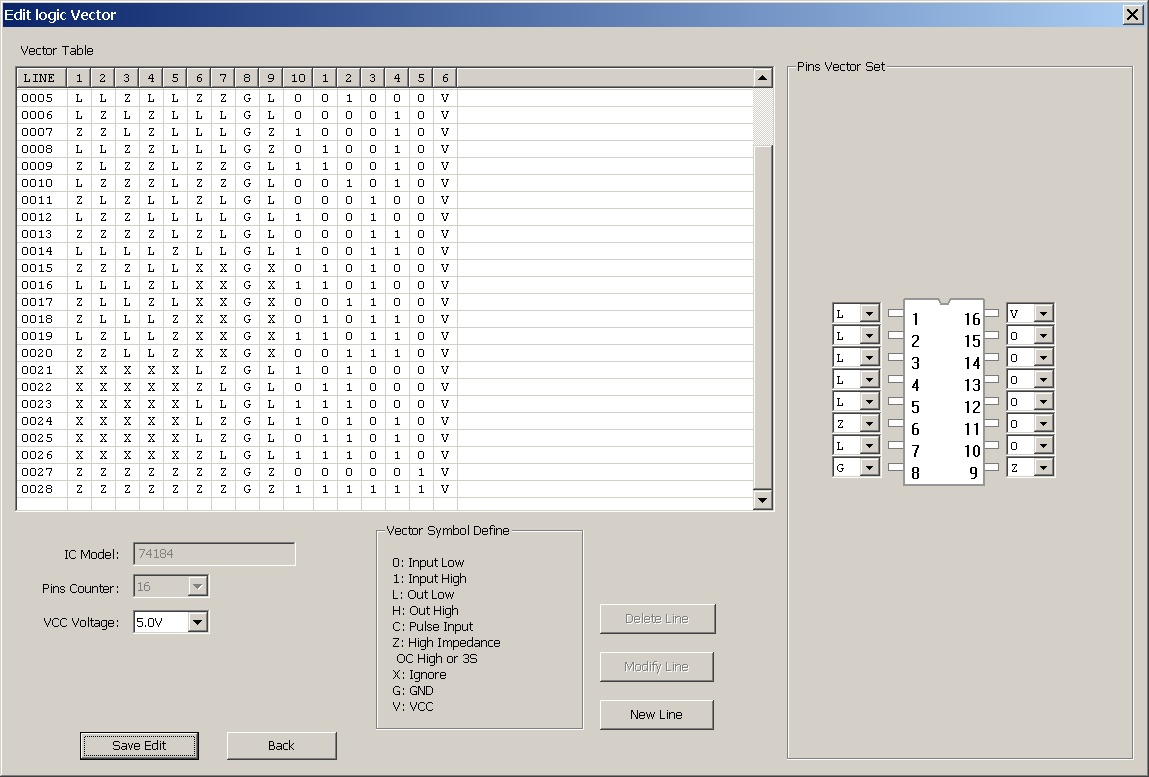

The test was performed on the SN74184N (BCD TO BINARY AND BINARY TO BCD CONVERTERS).
