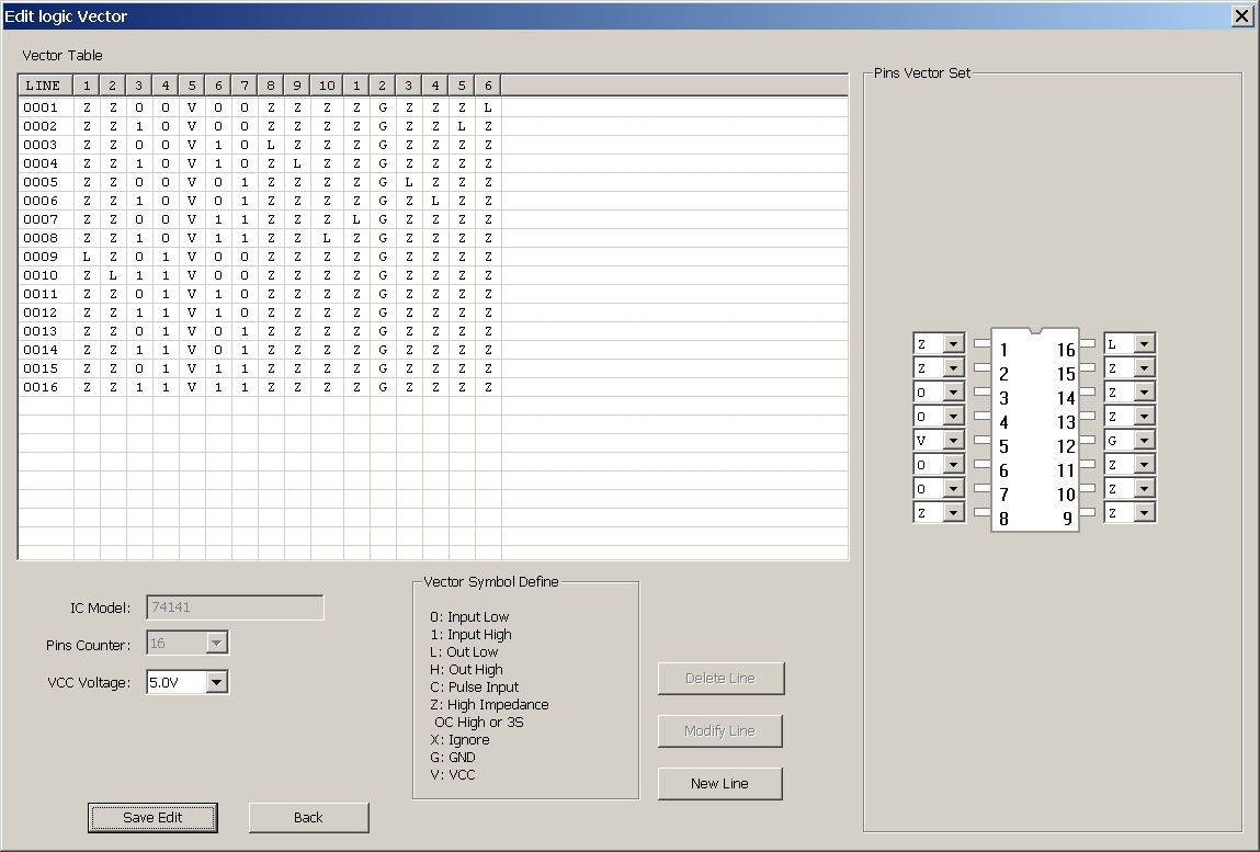

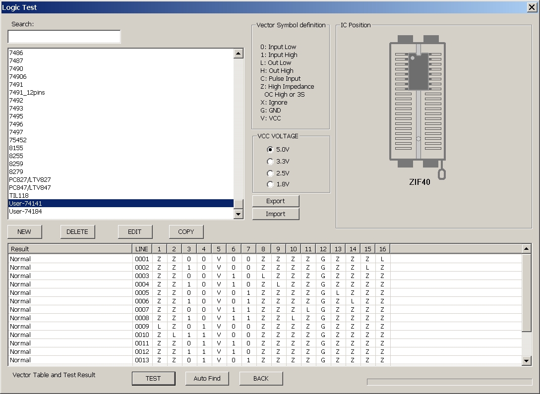

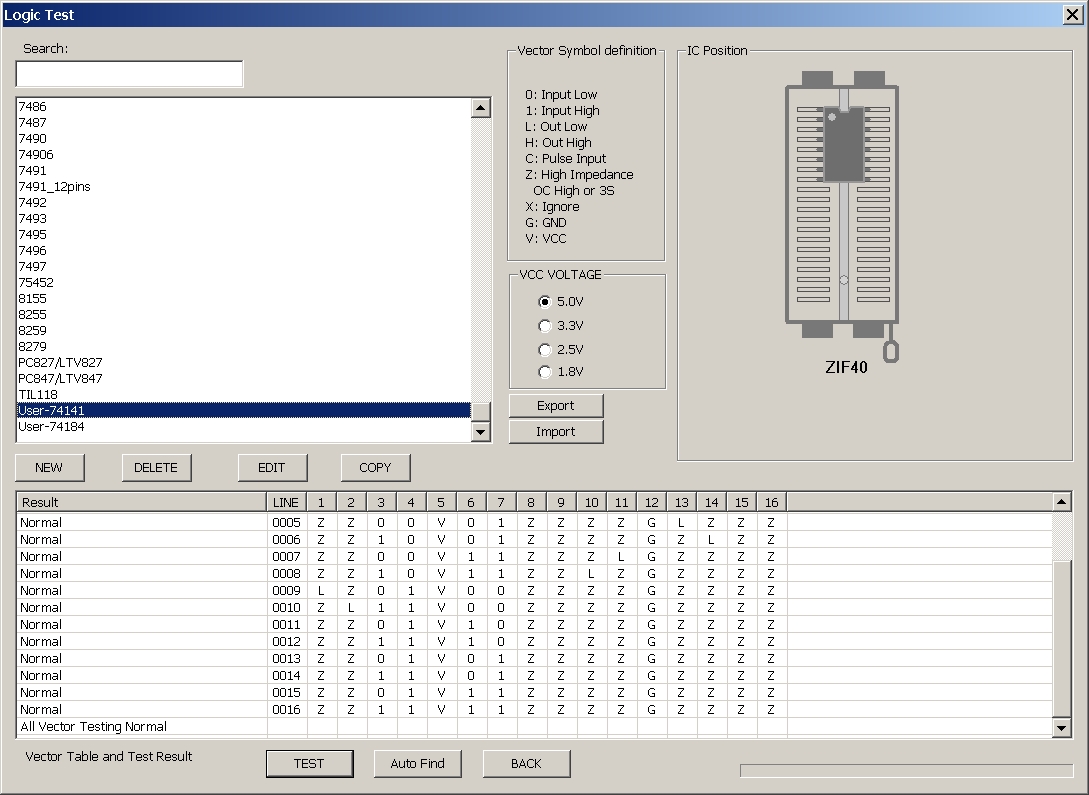

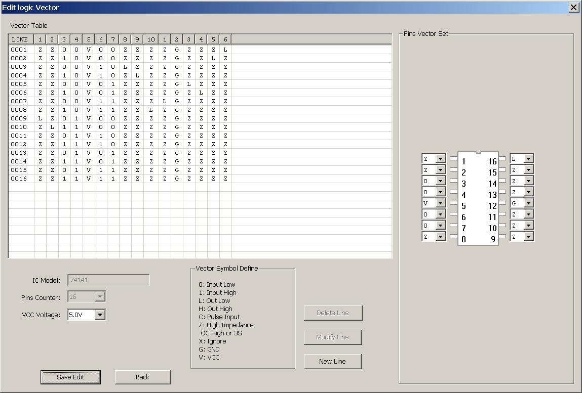

Enclosed is the new layout to be added to the logic tests (add in XGecu).
The test was performed on the SN74141N (BCD to Decimal Decoder/Driver).

图片附件:
(2025-8-10 18:45, 172.17 KB) / 下载次数 6686
http://forums.xgecu.com/attachment.php?aid=2325&k=29046685db8e44350e700096bccaa0e6&t=1795583820&sid=Y35Y22
图片附件:
(2025-8-10 18:45, 178.97 KB) / 下载次数 6643
http://forums.xgecu.com/attachment.php?aid=2326&k=d2b2da4d456d2150fcae6f1376854576&t=1795583820&sid=Y35Y22
图片附件:
(2025-8-10 18:45, 180.04 KB) / 下载次数 6644
http://forums.xgecu.com/attachment.php?aid=2327&k=557a3d70b3d178f107143b1cc90959b4&t=1795583820&sid=Y35Y22
