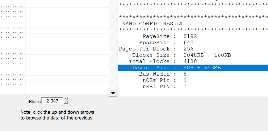

- crashes by clicking on "Add IC by user", cant find any log to attach- NAND H27UCG8T2ATR-BC
https://datasheetspdf.com/pdf-file/845970/Hynix/H27UCG8T2ATR-BC/1
has 4180 total blocks
(24.89 KB)
2024-2-24 02:45
but using arrows I can reach only 2047 block number maximum.
(Manually I can't input any number from 0 to 4179)
Windows 11
图片附件:
(2024-2-24 02:45, 24.89 KB) / 下载次数 21062
http://forums.xgecu.com/attachment.php?aid=2136&k=b49d4a054c0087ce8c393f59996ed5f0&t=1793414649&sid=NwmK8D
作者:
lexand
时间:
2024-2-24 03:00
and one more update
when I manually enter, for example block number 1000
then click on spinner arrow to go to the next block (1001) it jums to anywhre but not to the 1001 block
