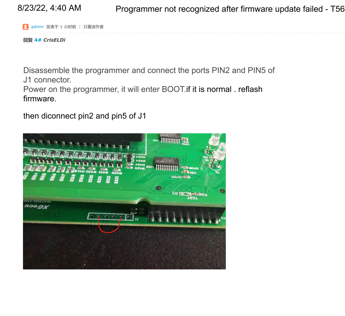

   You can use the procedure to recover, first jumper it and if it appear ok, reflash it,and if sucessful do a self test.Do it if you want at your own risk :(

   Does not help.
The programmer behaves like a brick. When a jumper is made, the LED blinks a little more intensely and nothing happens.
As you can see the incoming cable, the lines will enter the PIC chip, perhaps there is a problem with it or its firmware?

It looks an hardware error. Sometimes Admin post a tip, hopefully. :(
