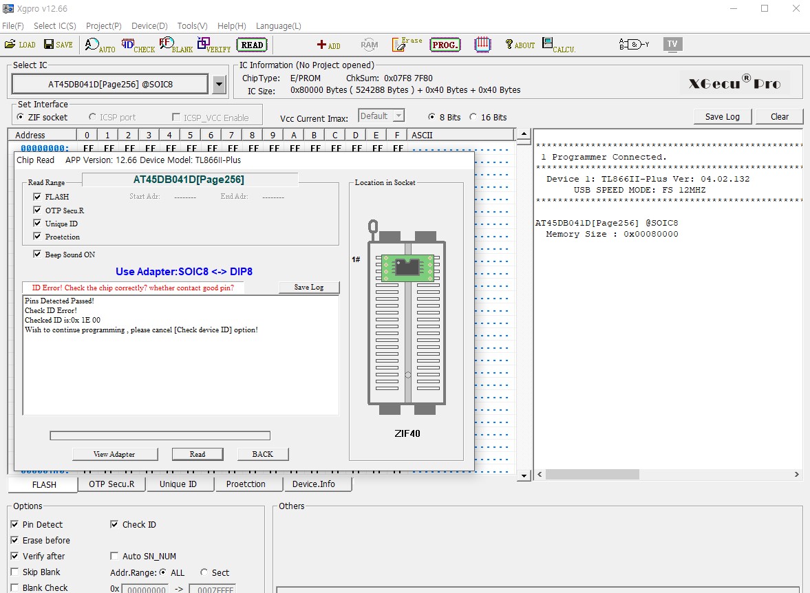

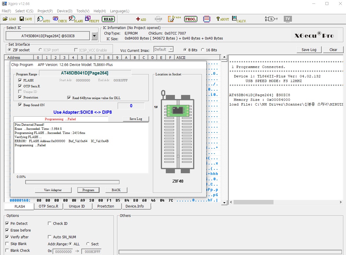

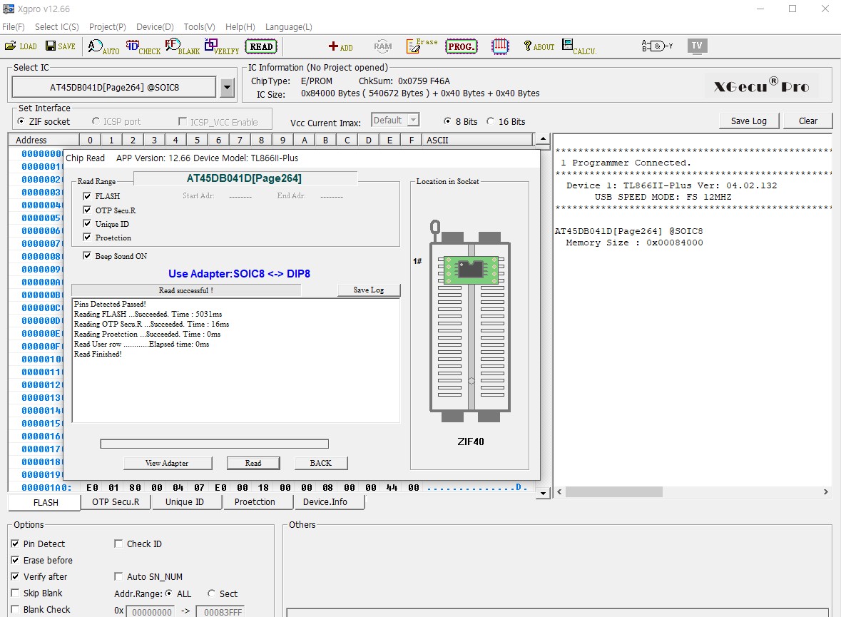

adesto 45DB041D SOIC8
Programming is not possible.
There is an ID error.
Please check.

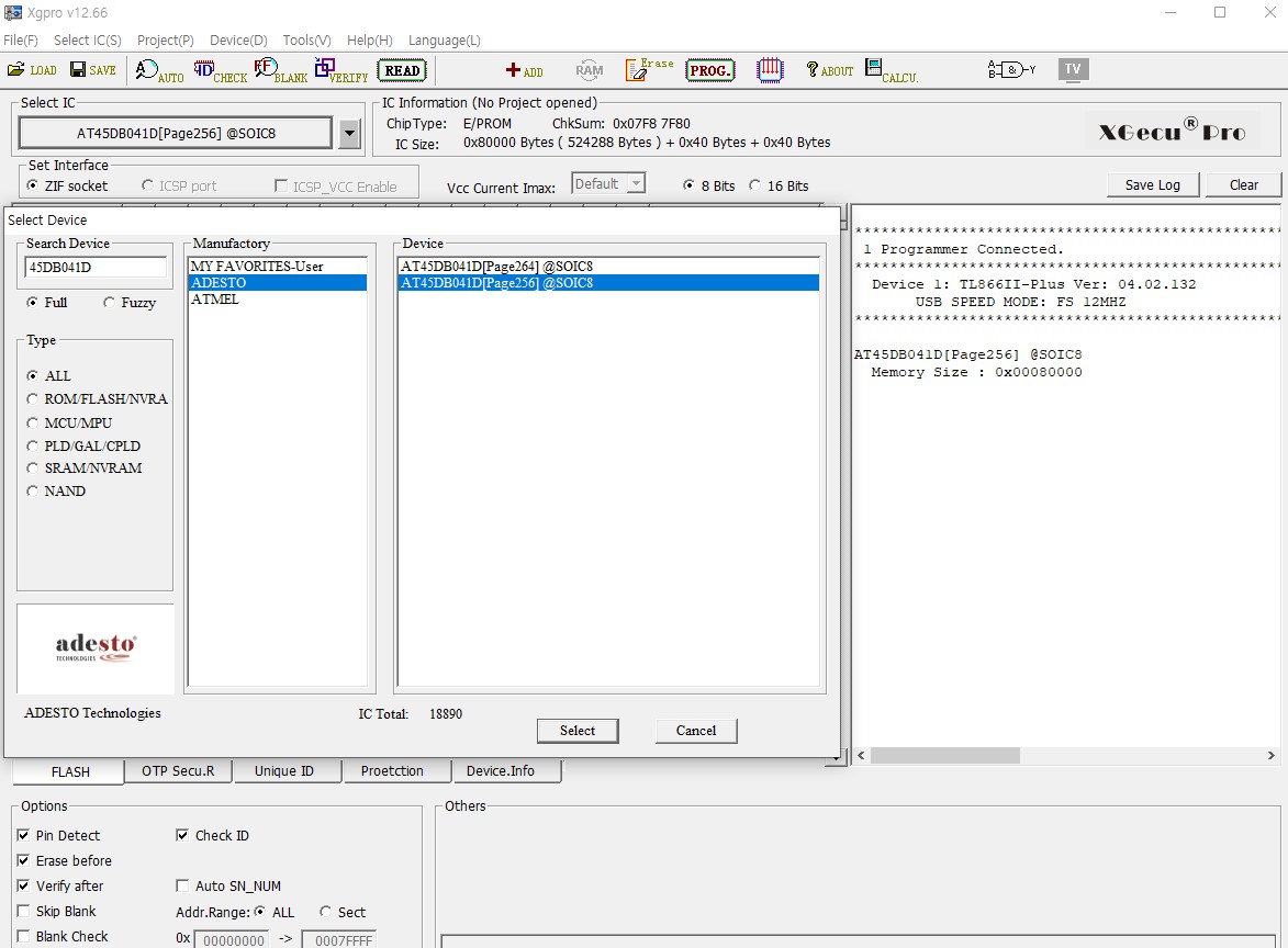

作者: Albano.Matos    时间: 2024-2-20 14:08
Please check.
wolfdol2000 发表于 2024-2-20 13:27
         As a user... There are 2x 45DB041D in the selection, verify.
You can always 'uncheck' CheckID , bottom left in the Options of Xgpro App.
Post image or copy text and put here what IDs appear,
maybe ADMIN need to correct, or add new version :)
作者: wolfdol2000    时间: 2024-2-20 14:44
화면 캡처 2024-02-20 152715.jpg 화면 캡처 2024-02-20 152802.jpg 화면 캡처 2024-02-20 152929.jpg 화면 캡처 2024-02-20 153125.jpg
图片附件: 화면 캡처 2024-02-20 152715.jpg (2024-2-20 14:43, 168.68 KB) / 下载次数 18845
