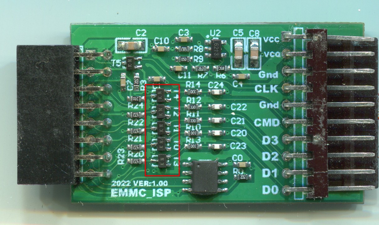

作者: AlexShen    时间: 2024-1-19 04:08     标题: T48 EMMC isp adapter does not work.
Hi! I already used this adapter, it was worked, but now it doesn't work correctly. The lines to the device's CPU are cut off and do not interfere, but the connection to the EMMC is unstable. Using an oscilloscope, I see a distorted signal on the lines. Is it possible to find out what transistors are installed in the adapter? This is a transistor in a SOT-323 package marked K N. Is this 2sk3018? Identical transistors are checked differently with a multimeter.

作者: AlexShen    时间: 2024-1-22 02:54
Please help me solve this problem. For checking, I use a TV board that I previously read and write through this adapter, but now it doesn’t work. AnalisisIC gives an error. I removed the T5 transistor and replaced it with a jumper - the analysis worked, but the reading did not work. I removed transistor T0 and replaced it with a jumper. After this the EMMC is read. What is causing this problem? The adapter worked previously.

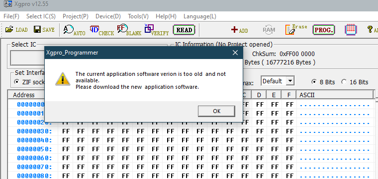

作者: AlexShen    时间: 2024-1-22 22:54
With Ver 12.55. I click the Read key.
图片附件: Screenshot-48(4).png (2024-1-22 22:53, 20.62 KB) / 下载次数 23510
http://forums.xgecu.com/attachment.php?aid=2107&k=562cfad742438440e401d9c76a547fb7&t=1793446933&sid=w1si59
作者: Albano.Matos    时间: 2024-1-23 01:03
AlexShen 发表于 2024-1-22 22:54
          Thank you for post message. Software 12.55 , as i know and you can confirm,
date is 14 APR 2013. 12.63 is 07 of September 2013, then sooner, all of us will have same message,
even with 12.63. If you want to try, setting the date back from your machine just for a try....
Hopefully they will post a new version before latest version expire. Sorry for that....

作者: AlexShen    时间: 2024-2-22 00:37
I replaced the 2sk3018 transistors on the CLK and D0 Lines and now the adapter works again, problem solved.
