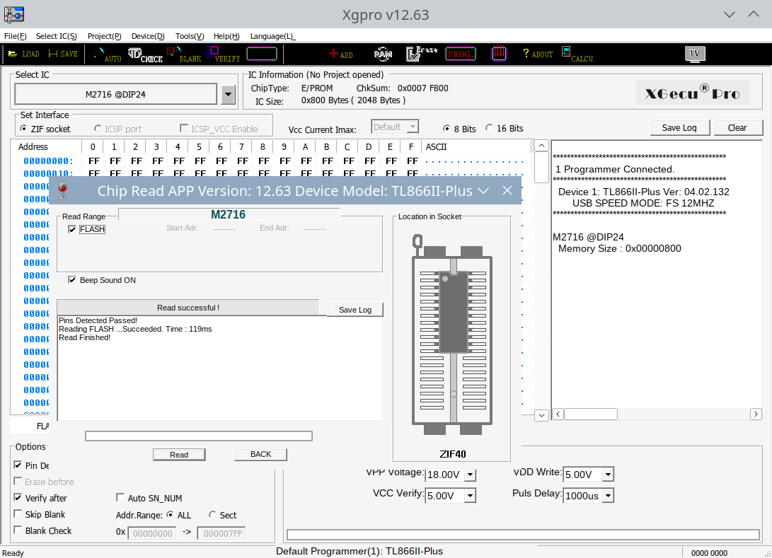

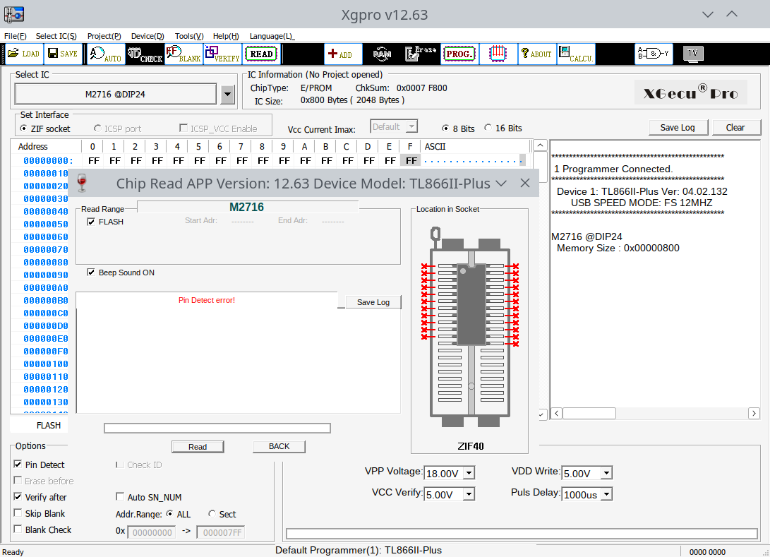

This is reading one of the Apple ROMs
and this is the NEC D2716D EPROM
what exactly means the pin error and what can I do about it?
thank you

Hello,         Sorry for delay. If you are sure about pins , voltages set ( at bottom center)
unchecking Pin Detecting lower left may help to continue.
