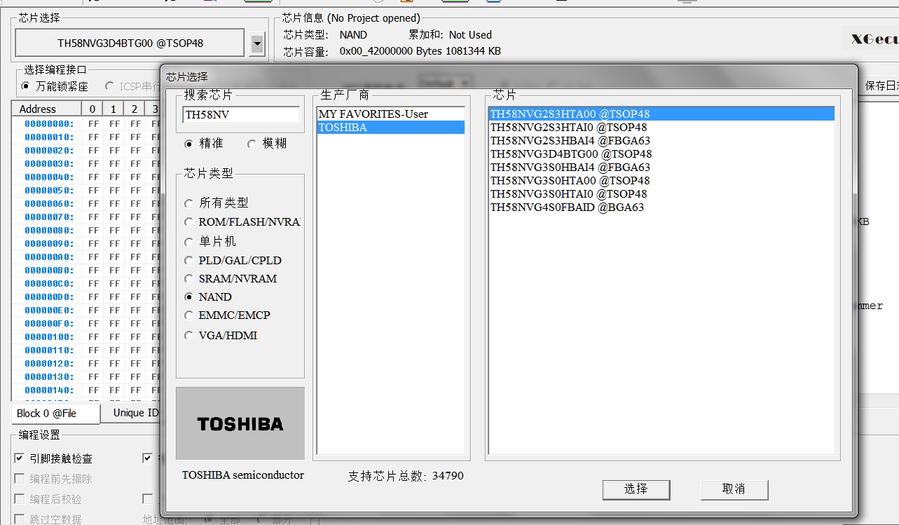

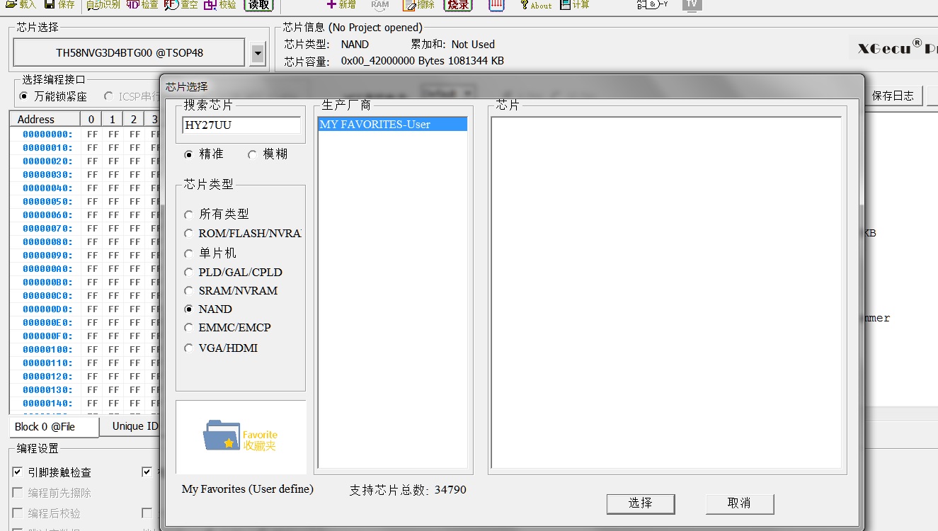

有发现同样问题的吗?譬如支持列表里有 HY27UU08AG5A @TSOP48                HY27UU08AG5M @TSOP48
譬如支持列表里有   TC58NVG5D2FTA00 @TSOP48             TH58NVG5S0ETA20 @TSOP48
等等好多支持列表里有的打开软件里都没有,这是怎么回事,这里面实际有支持3万多个吗?难道都需要自己手工添加?
图片附件: 56.jpg (2023-11-22 14:22, 206.98 KB) / 下载次数 31798

图片附件: 5601.jpg (2023-11-22 14:25, 248.34 KB) / 下载次数 32967

作者: Albano.Matos    时间: 2023-11-30 17:34
does
someone answer gavinbx Posted on 2023-11-30 11:32
   As a User,                  You can try, starting Xegu application without  any programmer connected.
Select T56, choose the IC you need, enter it and verify device info. Close the program
connect the programmer and start the app,  it will in both cases show now the correct
adapter for T48.
I think, this is  a flaw in the software, i'm guessing.
Hopefully it will be solved in the next version of software that i feel a complete new version
with all those annoyances solved, or not :(
Hope it helps, if it works ok, is a workaround not a fix as i do not have the T48 or the proper adapters to check.  :)

作者: Dmitry    时间: 2025-1-14 22:43
there really is such a problem if you don't use t56. I checked it on my old tl866 plus. The problem is already one year old
