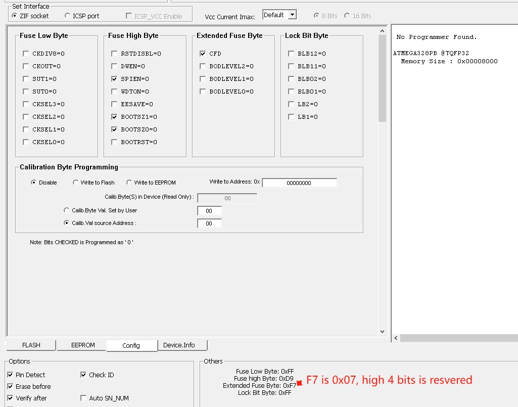

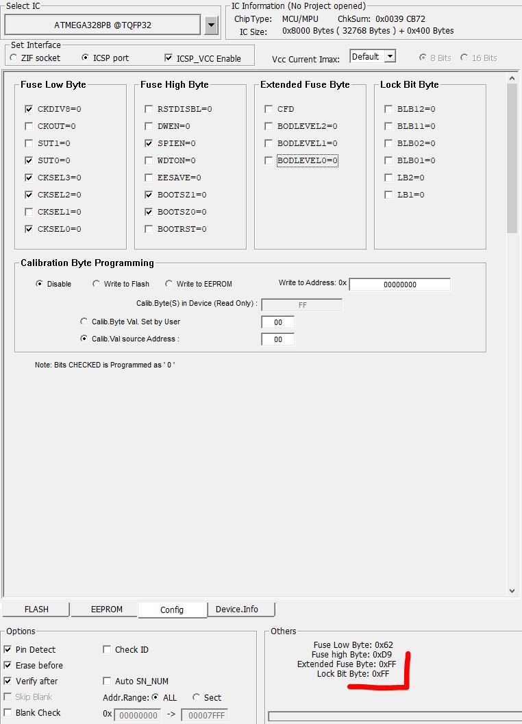

Hi,
I have T56 and just tried to flash MEGA328PB microcontroller, but failed miserably.
I was required to set:
Lock: 3F
High: D9
Low: FF
Ext: 07
But you can't set it with checkboxes.
Is there any option to manually set the hex values?
javascript:; t56fuse.JPG
图片附件: t56fuse.JPG (2023-9-23 19:20, 103.3 KB) / 下载次数 22689
http://forums.xgecu.com/attachment.php?aid=2017&k=bb94796ebb9840aec14f8ecc4b1c15c8&t=1793240821&sid=zki5c1
作者: admin    时间: 2023-9-24 08:01
and Lock byte is same .high bits is RES bits.
图片附件: 1.png (2023-9-24 08:01, 144.66 KB) / 下载次数 23500
http://forums.xgecu.com/attachment.php?aid=2018&k=add05c3bfb24b63f048f5f82af80308c&t=1793240821&sid=zki5c1
作者: Marcin_Sz.    时间: 2023-9-24 19:02
Thank you!
I thought the whole bitmask is important. So I understand RES bits are disregarded on programming and don't influence anything.
So I must had failed elsewhere :D
