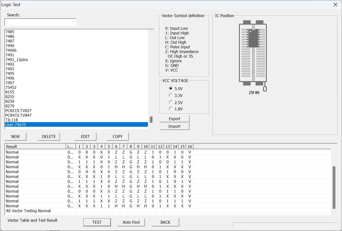

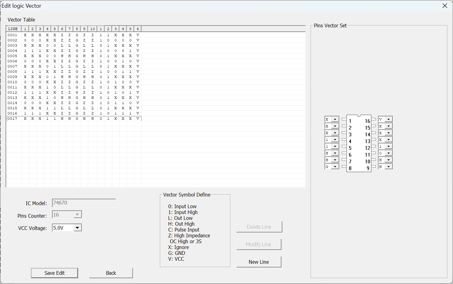

标题:
New Logic Test - 74670
Test vectors:
(49.32 KB)
Test vectors
2023-9-10 19:06
Device test:
(141.4 KB)
Device test
2023-9-10 19:06
