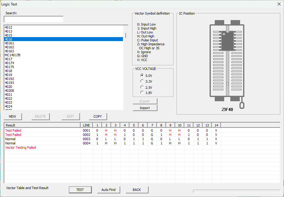

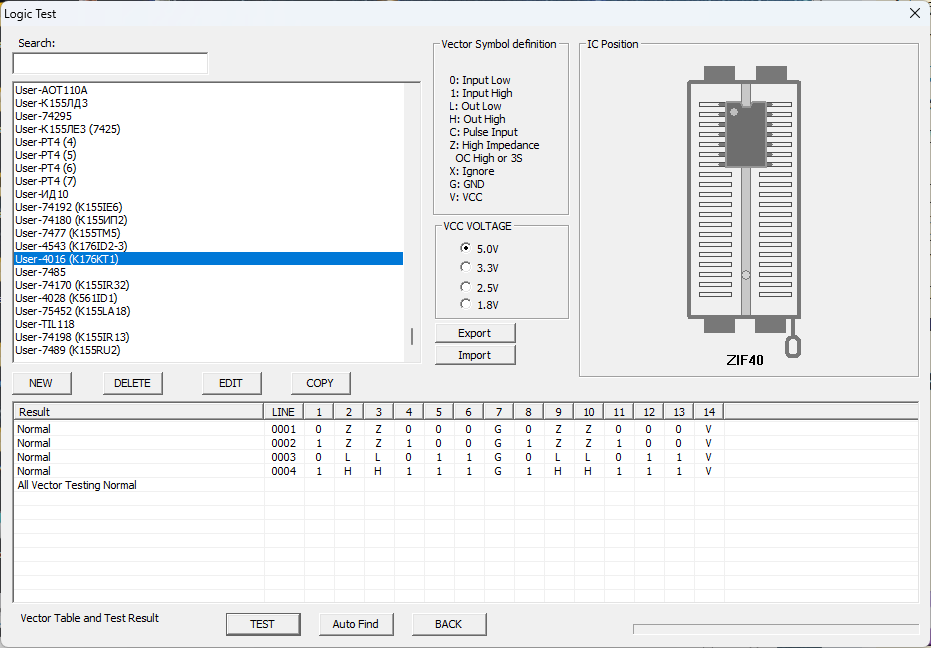

Share my new logic tests:

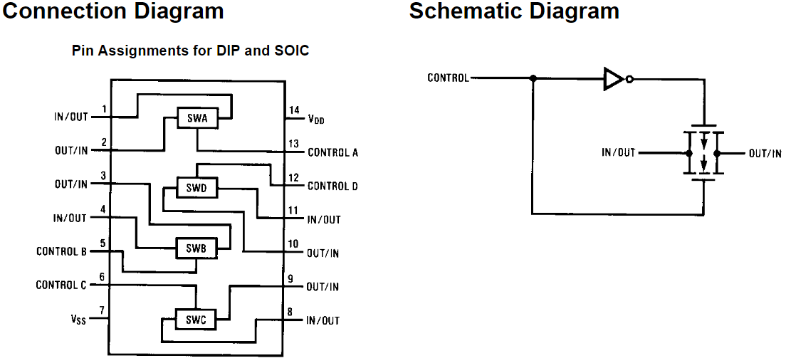

1) 4016 (К176КТ1), test in programmer is false (when "Control=0" pin 5,6,12,13 -> In/Out = Z (OC))

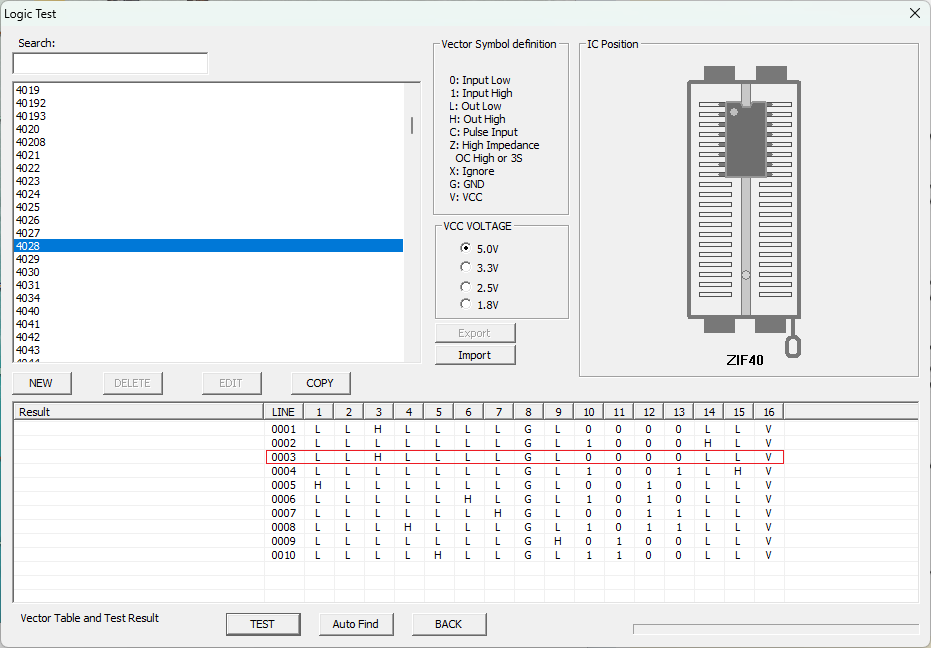

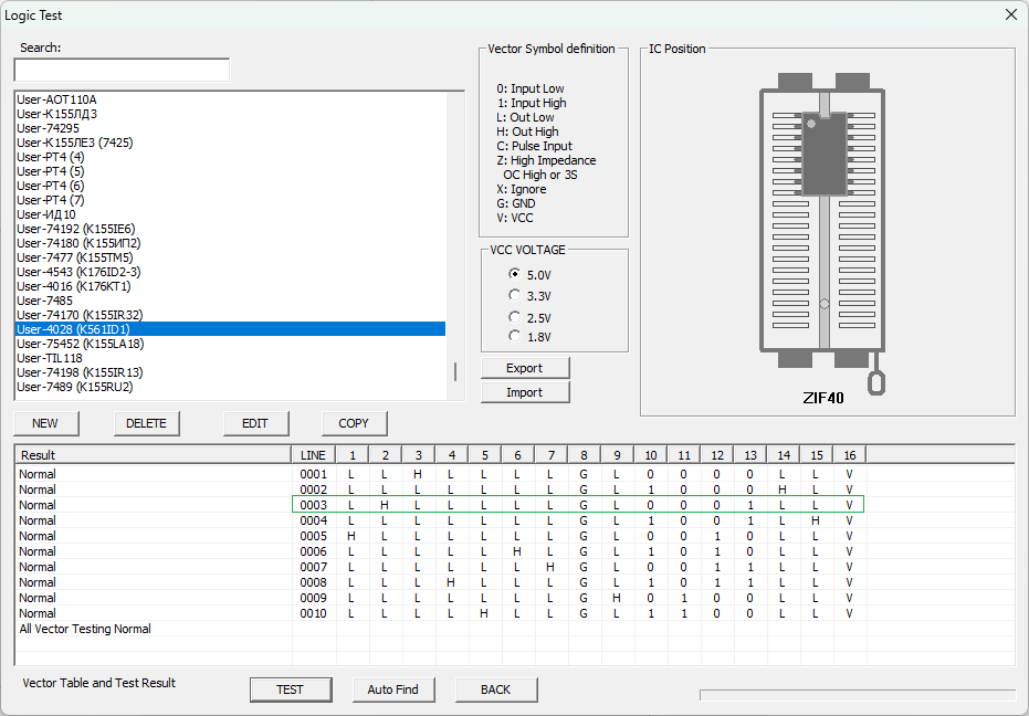

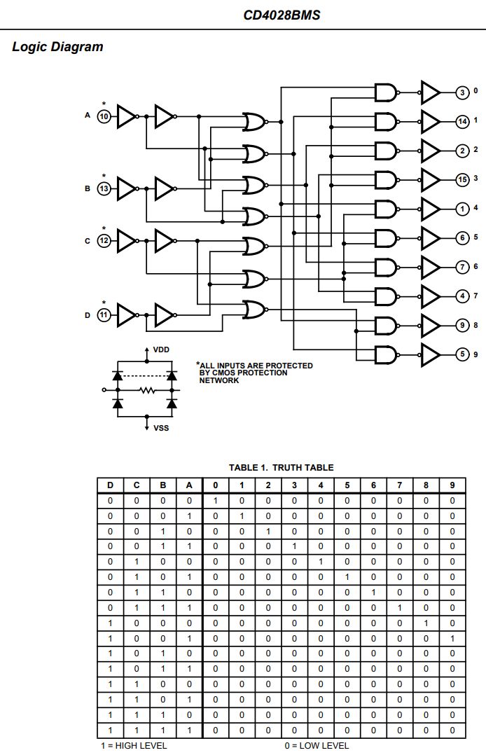

2) 4028 (К561ИД1) error in a prog.test, "line 3"="line 1"
(36.36 KB)
2023-7-23 23:37
(42.11 KB)
2023-7-23 23:37
(116.8 KB)
2023-7-23 23:37

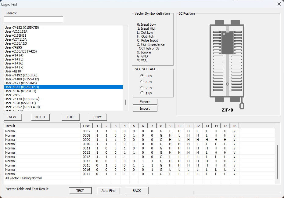

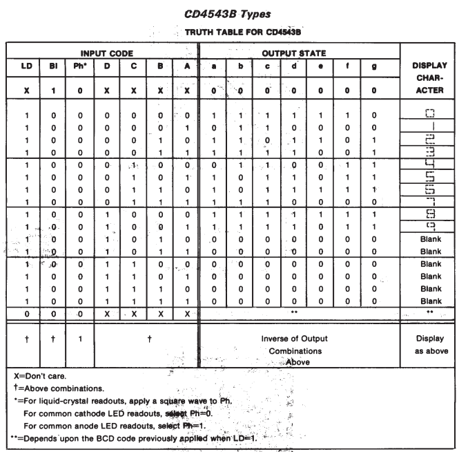

3) 4543 (К176ИД2),
more complete test
(47.57 KB)
2023-7-23 23:53
(155.08 KB)
2023-7-23 23:53

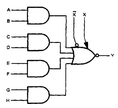

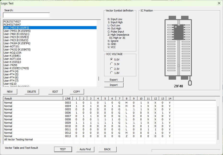

4)7453 (К155ЛР3)

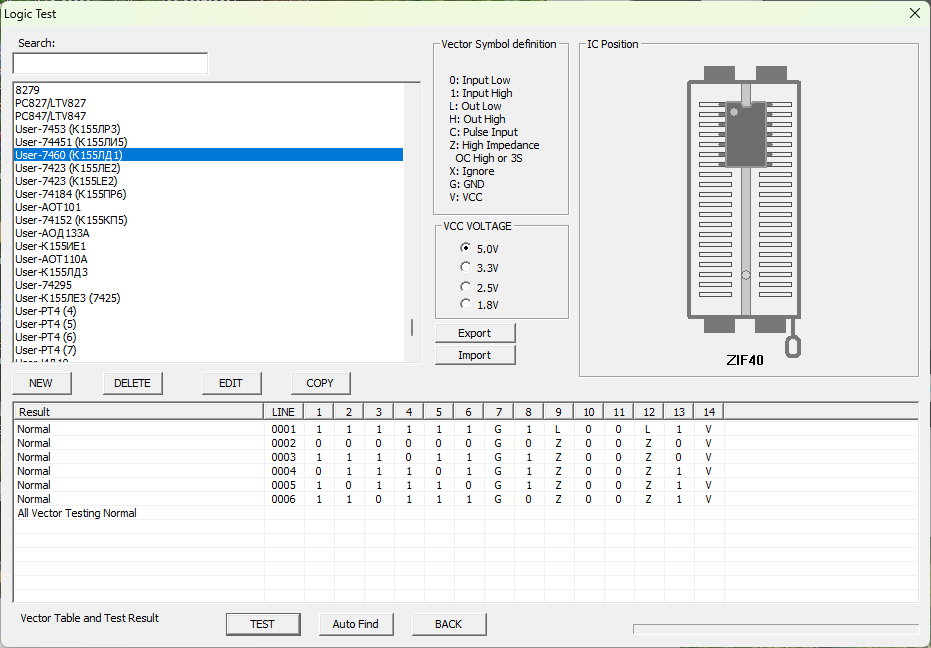

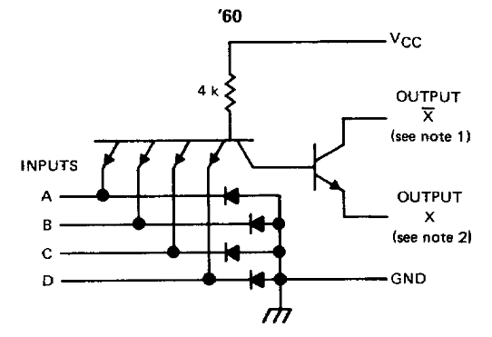

5) 7460 (К155ЛД1) Correct test
(45.53 KB)
2023-7-23 23:58
(20.96 KB)
2023-7-23 23:58

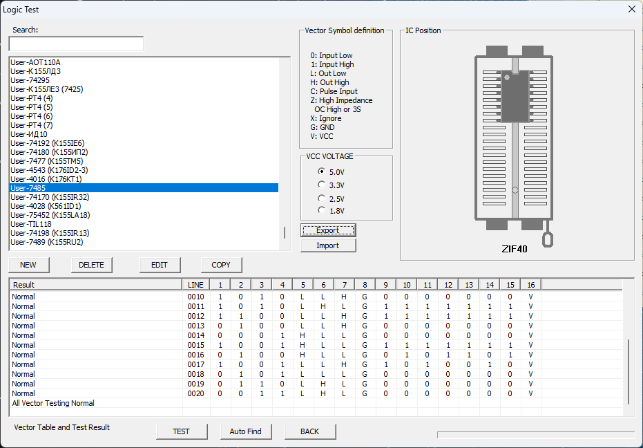

6) 7485 Full test
(48.81 KB)
2023-7-23 23:59

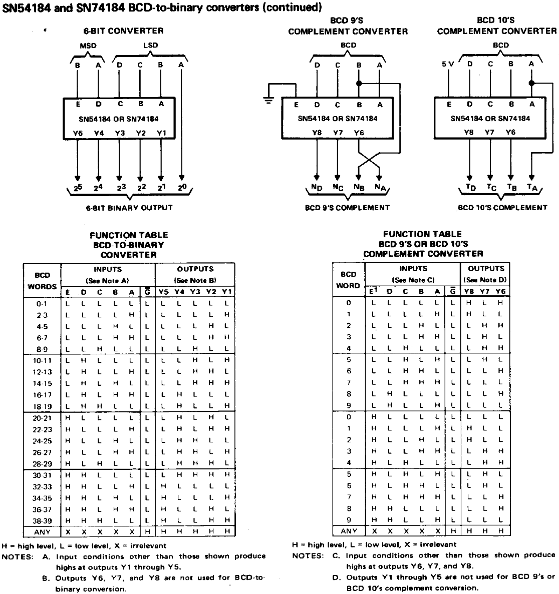

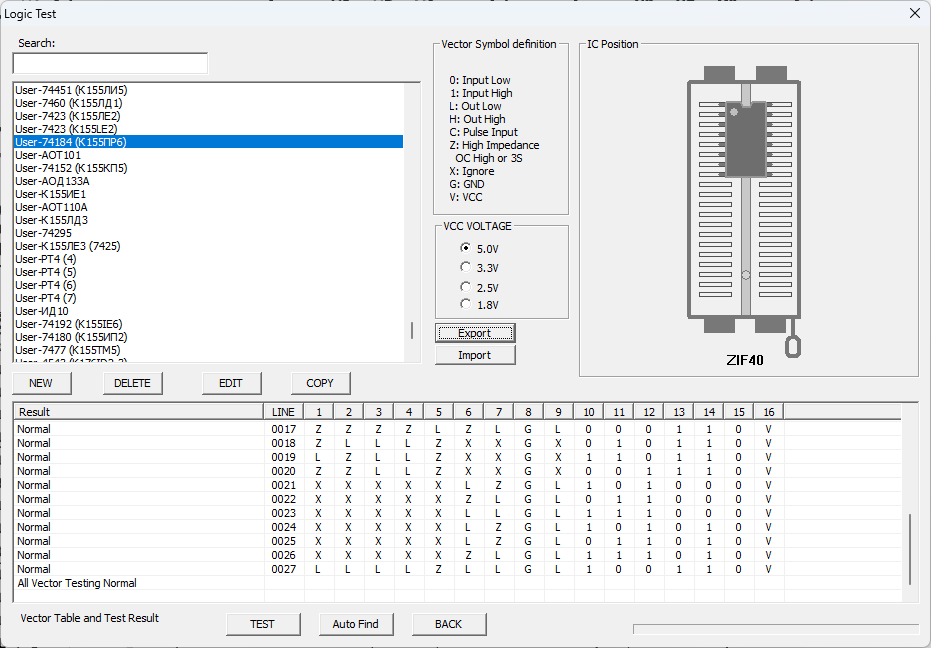

7) 74184 (К155ПР6)
(46.02 KB)
2023-7-24 00:02
(177.96 KB)
2023-7-24 00:02

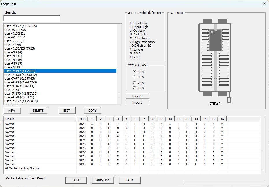

8) 74192 (К155ИЕ6) Full test
(45.17 KB)
2023-7-24 00:05

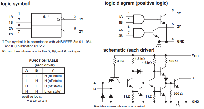

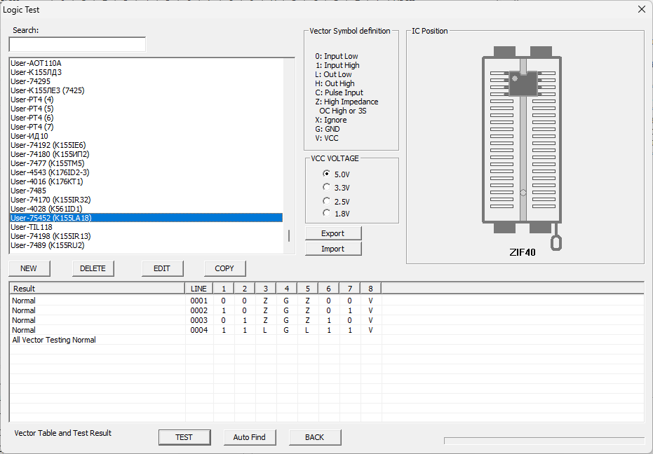

9) 75452 (К155ЛА18)
