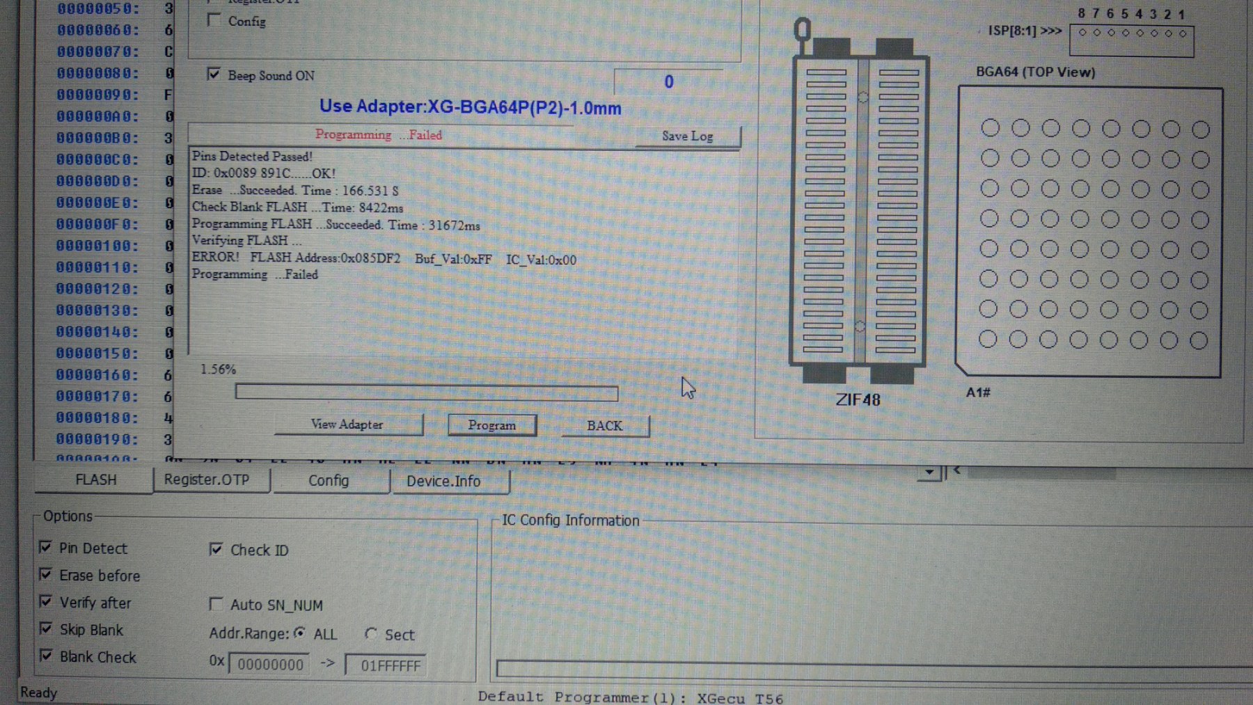

Unfortunately, I'm unable to program PC28F256P30BF (BGA64) with adapter XG-BGA64P2-1.0mm
Each time I have error buf_val 0xFF but ic_val 0x00 with different addresses.

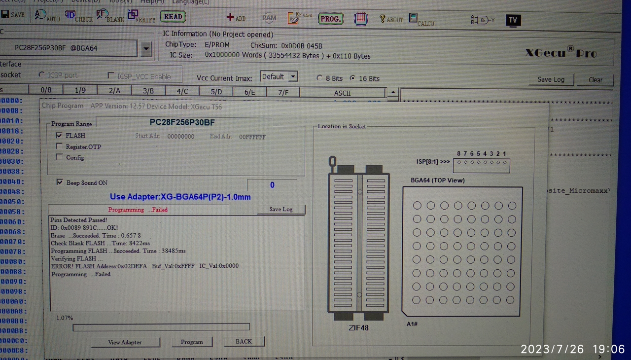

作者: Test    时间: 2023-7-27 02:35
I bought a programmer from another manufacturer with an BGA64 adapter, PC28F256P30BF was erased and programmed normally.
I repeat the same procedure on the T56 and I have error.
图片附件: Error.jpg (2023-7-27 02:35, 781.64 KB) / 下载次数 37335
http://forums.xgecu.com/attachment.php?aid=1939&k=564cb53455bfede77ebcdf5fae279f05&t=1793839586&sid=q066ku

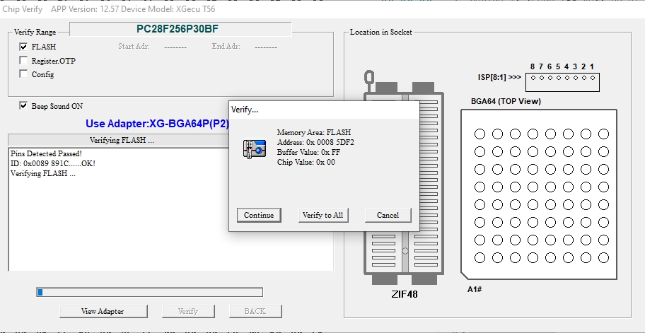

作者: Test    时间: 2023-7-27 03:47
Chip erased with T56 and blank verified on other programmer successfully.
Chip programmed and verified on other programmer.
Then I read chip on T56, after I pressing verify I got error on address A, I close verify window, open it again, press verify and got error on address B, ....... got error on address C.
图片附件: 1.jpg (2023-7-27 03:46, 122.94 KB) / 下载次数 26890
http://forums.xgecu.com/attachment.php?aid=1940&k=717622b7df4b8d76572815918bc6894f&t=1793839586&sid=q066ku
图片附件: 2.jpg (2023-7-27 03:46, 126.91 KB) / 下载次数 26810
http://forums.xgecu.com/attachment.php?aid=1941&k=8d0ce38711e0a9e276bda927af4a82d6&t=1793839586&sid=q066ku
图片附件: [C] 3.jpg (2023-7-27 03:47, 137.5 KB) / 下载次数 27130
http://forums.xgecu.com/attachment.php?aid=1942&k=4984f2975aee1dad3f2eadbd6ddea236&t=1793839586&sid=q066ku

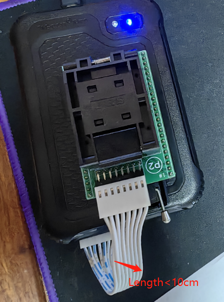

作者: admin    时间: 2023-8-13 17:16
回复 5# Test
Please cut the ISP cable length to below 10CM.
图片附件: 1.png (2023-8-13 17:16, 590.45 KB) / 下载次数 35247
http://forums.xgecu.com/attachment.php?aid=1959&k=7733b7c43e88da5f285030861c77878d&t=1793839586&sid=q066ku

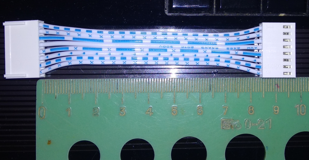

作者: Test    时间: 2023-8-14 18:57
Unfortunately, the length of the cable is 8 cm (cable comes with adapter)
图片附件: [Length is 8 cm] Cable.jpg (2023-8-14 18:56, 384.49 KB) / 下载次数 31414
http://forums.xgecu.com/attachment.php?aid=1961&k=c00072affdaccaccb37dd44f8e8ce304&t=1793839586&sid=q066ku

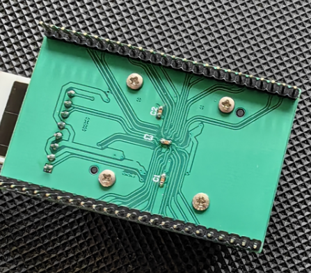

作者: admin    时间: 2023-8-15 14:07
The back of adapter C1,c2  C3 all is 0.1uf.Have them been soldered  on?
图片附件: 1.png (2023-8-15 14:07, 394.22 KB) / 下载次数 31480
http://forums.xgecu.com/attachment.php?aid=1962&k=93a4844bfa4dac348e7d69b295df4379&t=1793839586&sid=q066ku
作者: Test    时间: 2023-9-3 04:15
I unsoldered all capacitors and checked. Capacitance is 0.1uF of each.
What else can I check?
