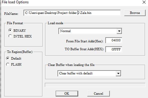

I have many 27C512 EPROMs, and data that normally would be used with 27c256, If I understand correctly, 27c512 can be used as replacement for 27c256, but the code needs to be allocated at the lower part.
Question:
How do I set the software to dump the code from 00004000 -> end?
作者: teevee    时间: 2023-7-11 14:23
Some help would be nice, please :)

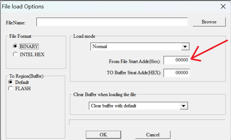

作者: Albano.Matos    时间: 2023-7-11 14:48
I have many 27C512 EPROMs, and data that normally would be used with 27c256, If I understa ...
teevee 发表于 2023-7-10 19:45
    As a user,                   I hope it's this function.... At load screen you can choose the mode and start address lo load the file Screenshot 2023-07-11 073732.png hope it helps you.

作者: teevee    时间: 2023-7-11 16:24
As a user,                   I hope it's this function.... At load screen you can choose t ...
Albano.Matos 发表于 2023-7-11 14:48
I tried this, but the .bin is not being loaded into the software starting from 04000. Am I doing something wrong here?
图片附件: Capture.JPG (2023-7-11 16:23, 32.49 KB) / 下载次数 20652
http://forums.xgecu.com/attachment.php?aid=1900&k=5dacd2599287f8ddbf08239bd6058b75&t=1793839597&sid=q066ku
作者: teevee    时间: 2023-7-17 05:42
Hallo, is the software defect?
作者: Albano.Matos    时间: 2023-7-17 15:01
teevee 发表于 2023-7-17 05:42
    Maybe Admin helps more. In the meantime don't know if it works for you,Create offline a Bin file mirrored in both half segments:
In a command line as an exemple:
copy /B out.txt+out.txt outnew.txt
And then use it as a normal 512 chip size.
Hope it helps
