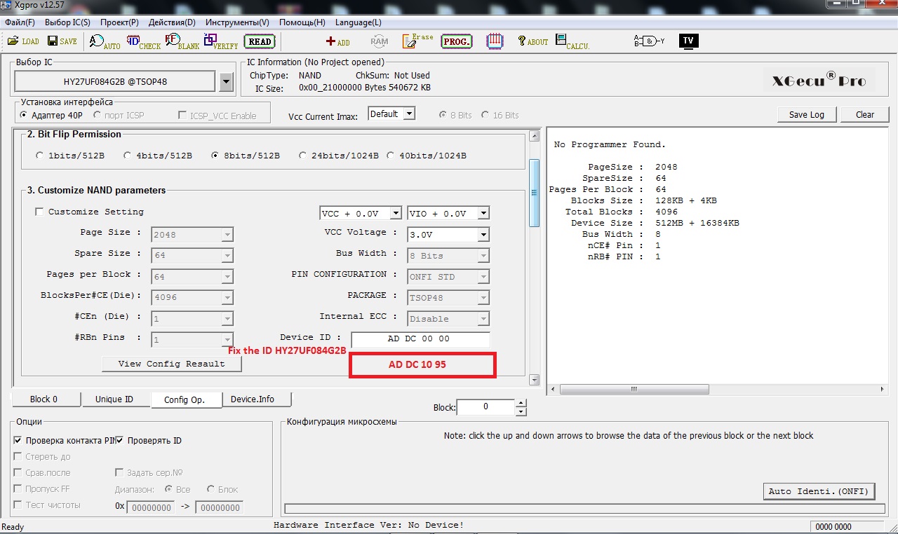

Fix ID HY27UF084G2B from AD DC 00 00 to AD DC 10 95 Fix the ID HY27UF084G2B.jpg
