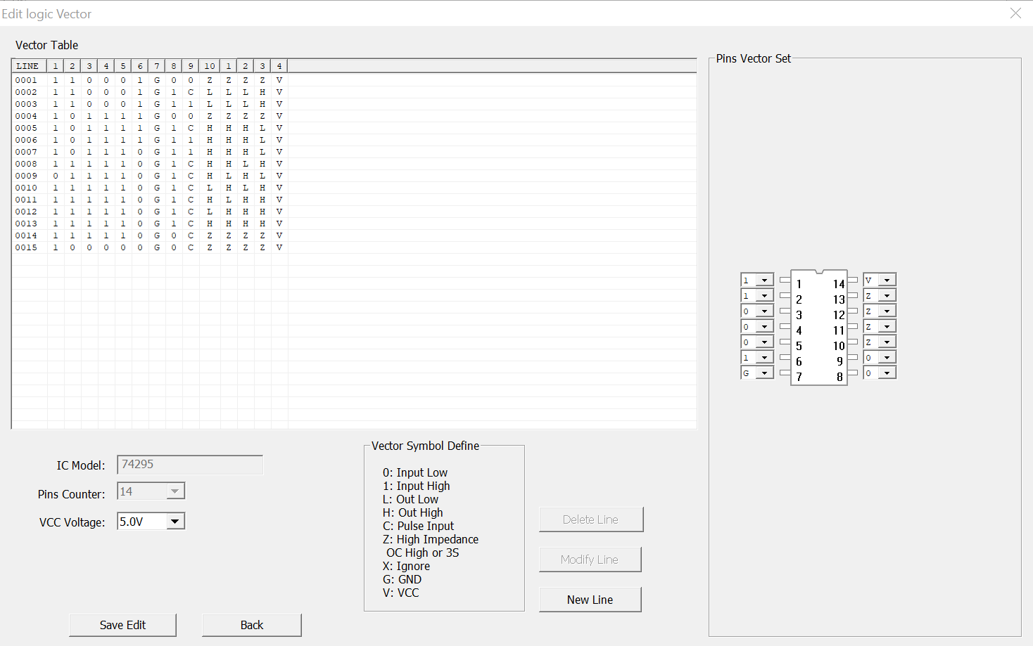

New Logic Test - 74295 Vector Table
New Logic Test of 74295 (555ИР16) IC.
(39.67 KB)
