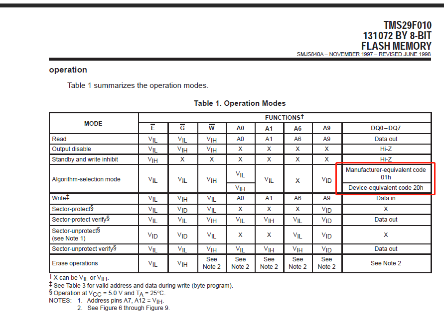

hi, i've problem with my XGecu T48
i can't read  TI TMS29F010 @PLCC32
Error Log
------------------------------------ID ERROR! Check the chip Correctly? whether contact good pin?
     Device : TMS29F010 @PLCC32
Pins Detected Passed!
Check ID Error!
Checked ID is:0x 97 97
Wish to continue programming , please cancel [Check device ID] option!
-----------------------------------------I have tried others device model, but end with the same result.
I have disabled Check ID, but end with diferent ChkSum when read two times.
The PLCC32-DIP32 adaptor has been tested.
Read Device ID: 97 97
Thanks for help.

作者: admin    时间: 2023-6-7 09:30
回复 1# RubbVandal
   TMS29F010 ID is 01 20.

Solved. Turn out that the zip adapter had a short in two data lines.After fixing it, the memory could be read no issue with the AM29F010 algorithm.
This was the same issue that causes the problem covered in this other post:
