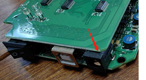

hello i have xgecu T56 programmer and won't be detected with Usb Cable only tested on many computer and same .
when i add 5V from psu extern the programmer work and test ok .??
any suggest for any parts need to be replaced or checked thank you in advance .
ps: firmware was updated to laste version and not resolve probleme .
think have 5v from the usb cable not working good
iam novice on electronics repair
regards

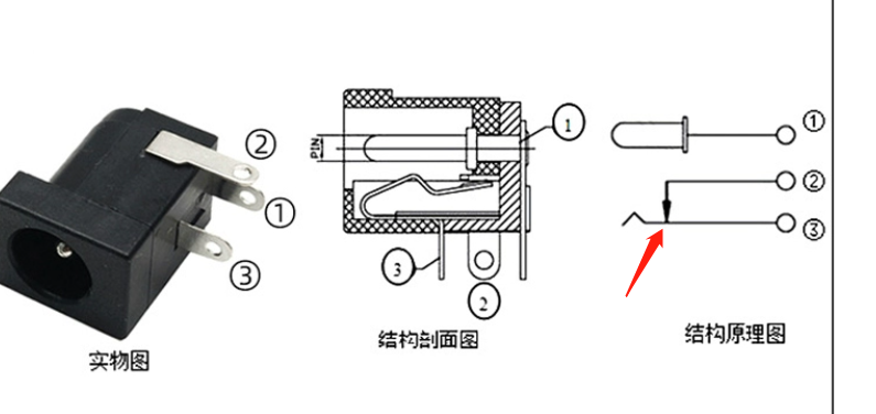

作者: admin    时间: 2023-5-30 15:02
回复 3# foulou0238
Check this DC socket, it is possible that the contact is not working

作者: foulou0238    时间: 2023-5-31 00:10
hello Admin
Thank you so much for your message
and solution work great .
my programmer work again and connector solveed my issue .
many thanks boss you are awesome.
