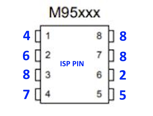

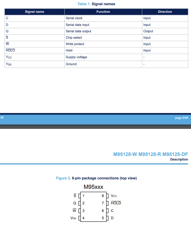

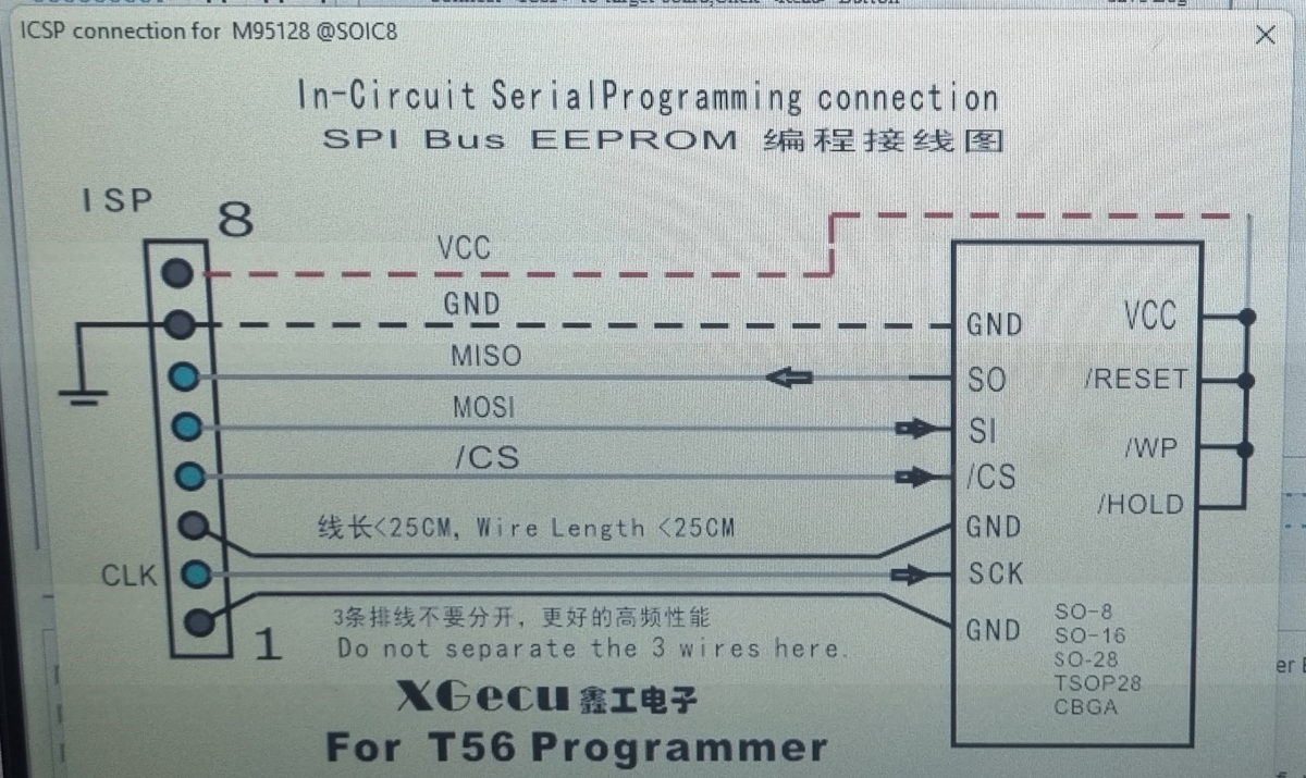

Hi, I am trying to work out which ISP pins on the T56 connect to which pins on a ST95128 SOIC chip.The pin connection in the software does not match up with the data sheet.
thanks

回复 1# Jaybee
   /S->/CS
  C->SCK
  D->SI
  Q->SO
  W->WP
  HOLD->HOLD
  VSS->GND
作者: Jaybee    时间: 2023-5-23 20:06
Thank you!This picture may help somebody in the future.

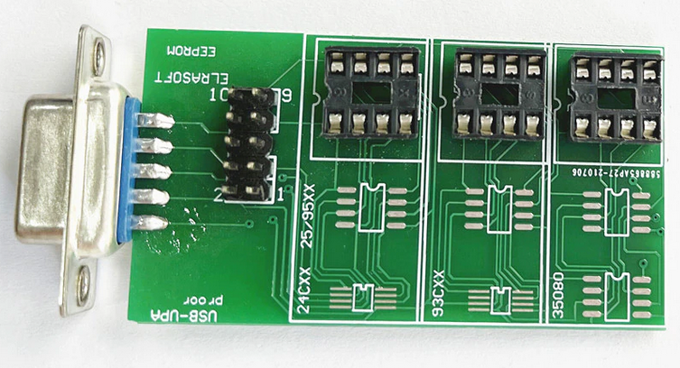

I am unable to find an ISP adapter like the one in the photo.
This would make it a lot faster and easier to connect the ISP port for reading different eeprom in circuit.
