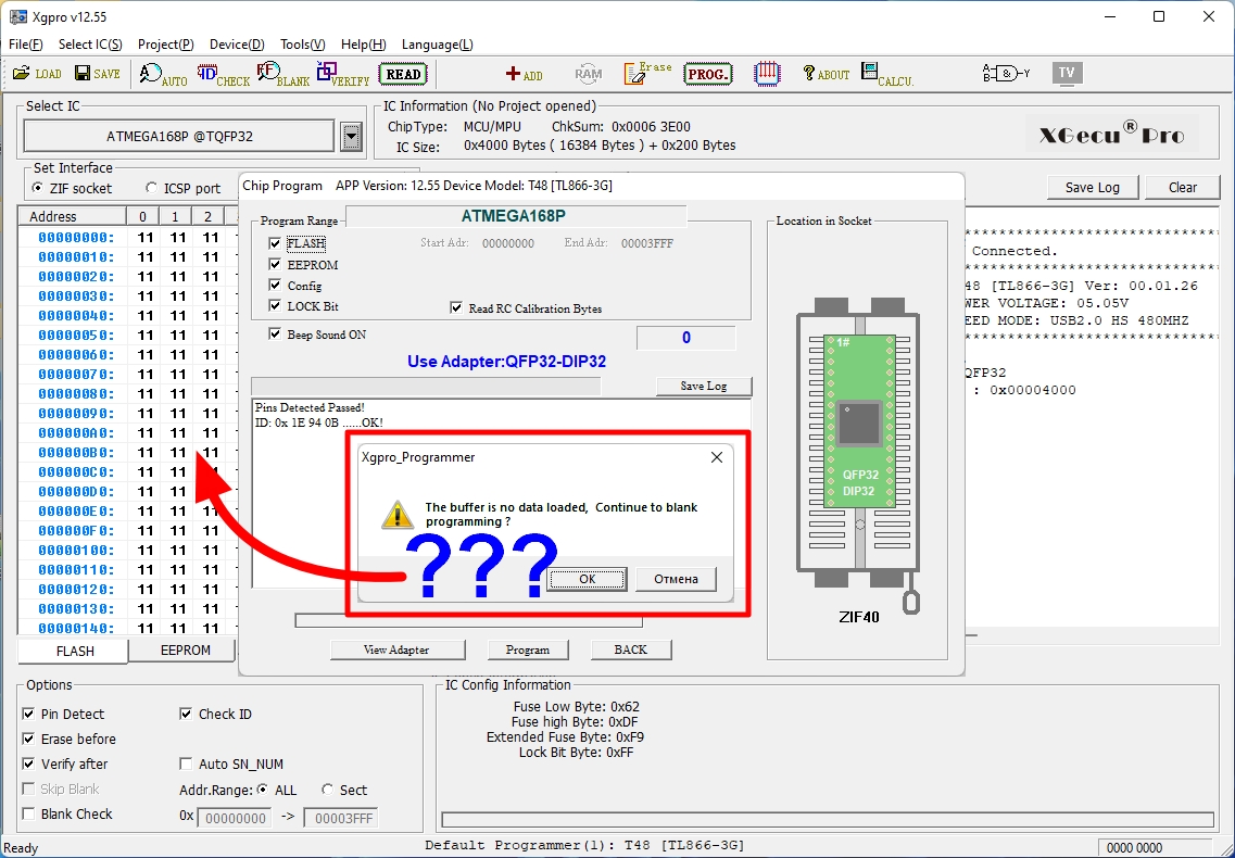

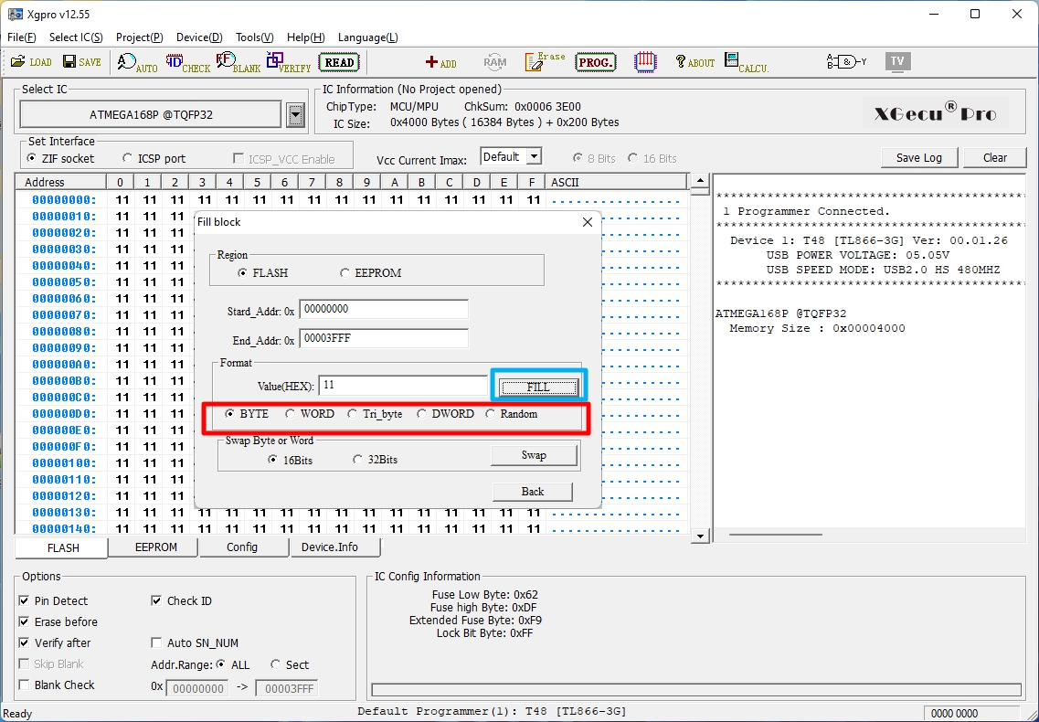

An "The buffer is no data loaded" warning is issued. Although the buffer is not empty. It's full. Can be filled in via menu "Fill Block" or entered manually.
1. Select a microcontroller.
2. Select "Fill block".
3. Fill in the blocks.
4. Program the microcontroller.
