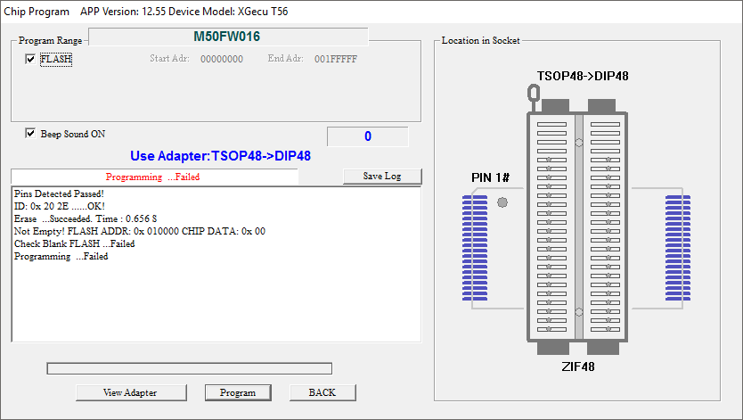

When working with M50FW016, several errors were revealed:
1. Erase only the first 0x10000 bytes
2. Writes only to these 0x10000 bytes and reads garbage.
3. Over 0x10000 bytes does not erase, reads garbage.

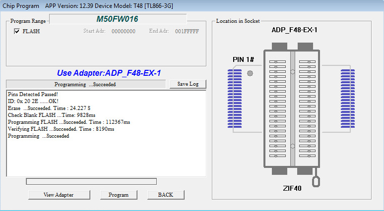

On T48 erasing, writing, reading passes without errors.
Fix please.
T56
T48
图片附件: image_2023-05-03_12-01-45.png (2023-5-3 17:27, 21.93 KB) / 下载次数 17268
http://forums.xgecu.com/attachment.php?aid=1799&k=a288f712bf6b6d77556a8d6cc0a2af81&t=1793248854&sid=i8wTrW
图片附件: 16M.jpg (2023-5-3 17:30, 183.34 KB) / 下载次数 19074
http://forums.xgecu.com/attachment.php?aid=1800&k=9d90802566de7a80730bd049b684ab15&t=1793248854&sid=i8wTrW

作者: dald    时间: 2023-8-19 01:26
I do have a very similar issue with a TL886IIplus and the M50FW016 flash. Everything written after 0X100000, is simply breaking the first half of the flash content.
Actually it appears that only the first half is in that case useable.
Initially I had a doubt as I tried with a flash I took out of my Mac Pro, but I did purchase 3 new chips and they all show the same behaviour which leads me to think that it's either the TL866IIplus not doing something right. I have confirmed this bad behaviour with Xgpro under Windows 10 and minipro (https://gitlab.com/DavidGriffith/minipro) under Mac OS X.
I have confirmed my TL866IIplus is an original one, it has the FW 04.2.132.
Could you please check if there is something to be adjusted ?
