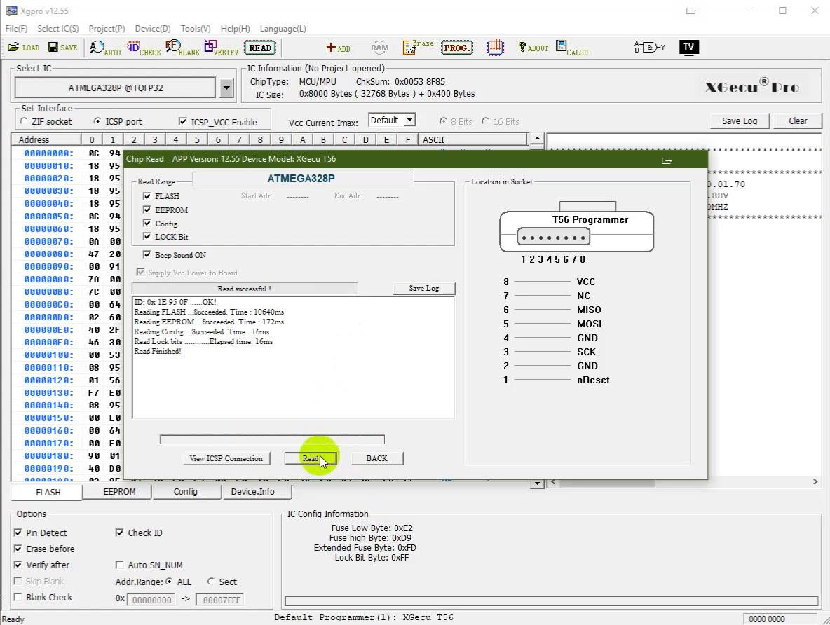

T56 via ISPinterface Atmega328P reading ok:

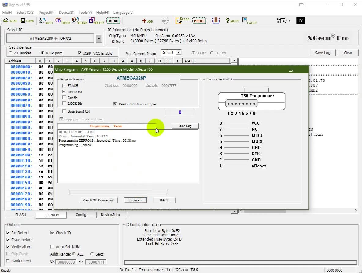

Butwhen writing, result is always error.

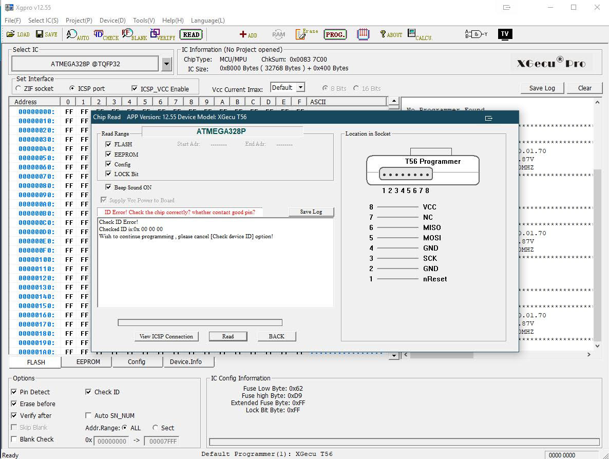

Every time after try to write (flash or eeprom), i can't  read ATmega328P anymore,programmer not recognizing Atmega.

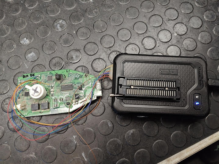

This is myPCB with Atmega328P.
With same wiring, same PCB, same dumps another  AVRISP MKII programer working ok.

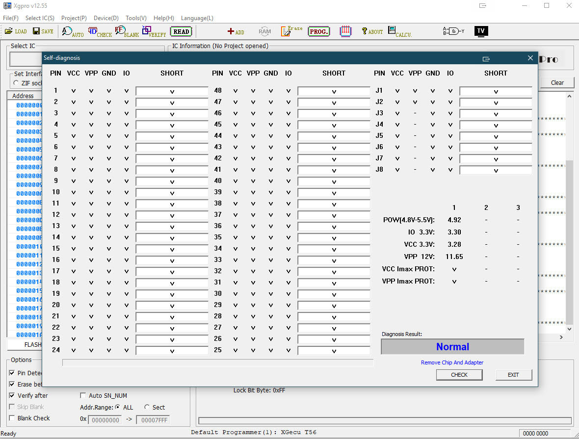

Do You have solution?
