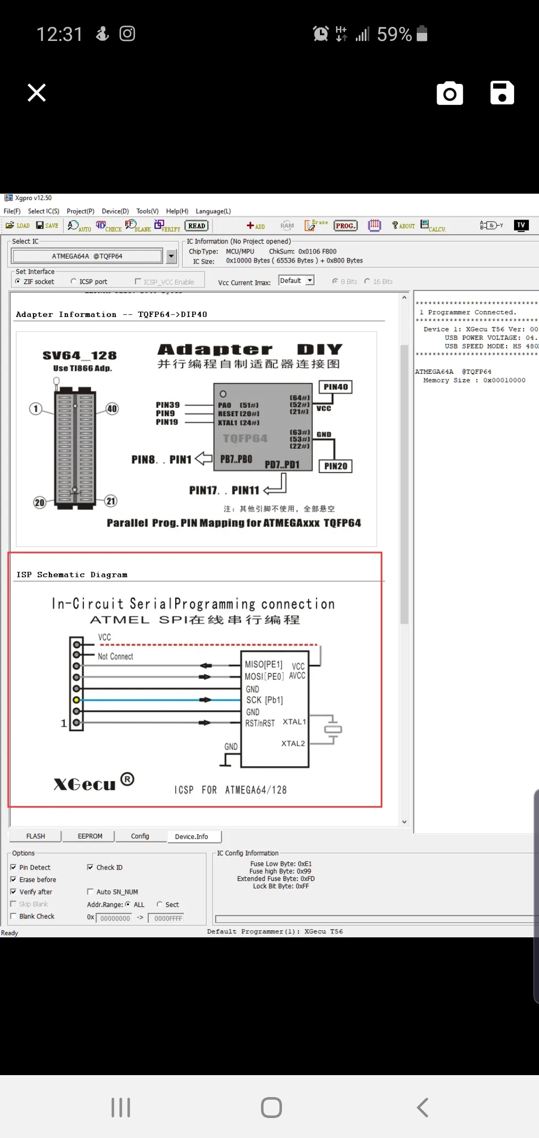

i have problem to read chip atmega64A IN XPROG BOX V6.12 WITH XGECU T56
I connected 7 wires according schematic(reset,gnd,sck,gnd,mosi,miso,vcc)
when i try to read the id error come out
uncheck id,try to read everything 0000
how can I solve
Thanks in advance

Upload the connection diagram. And photos

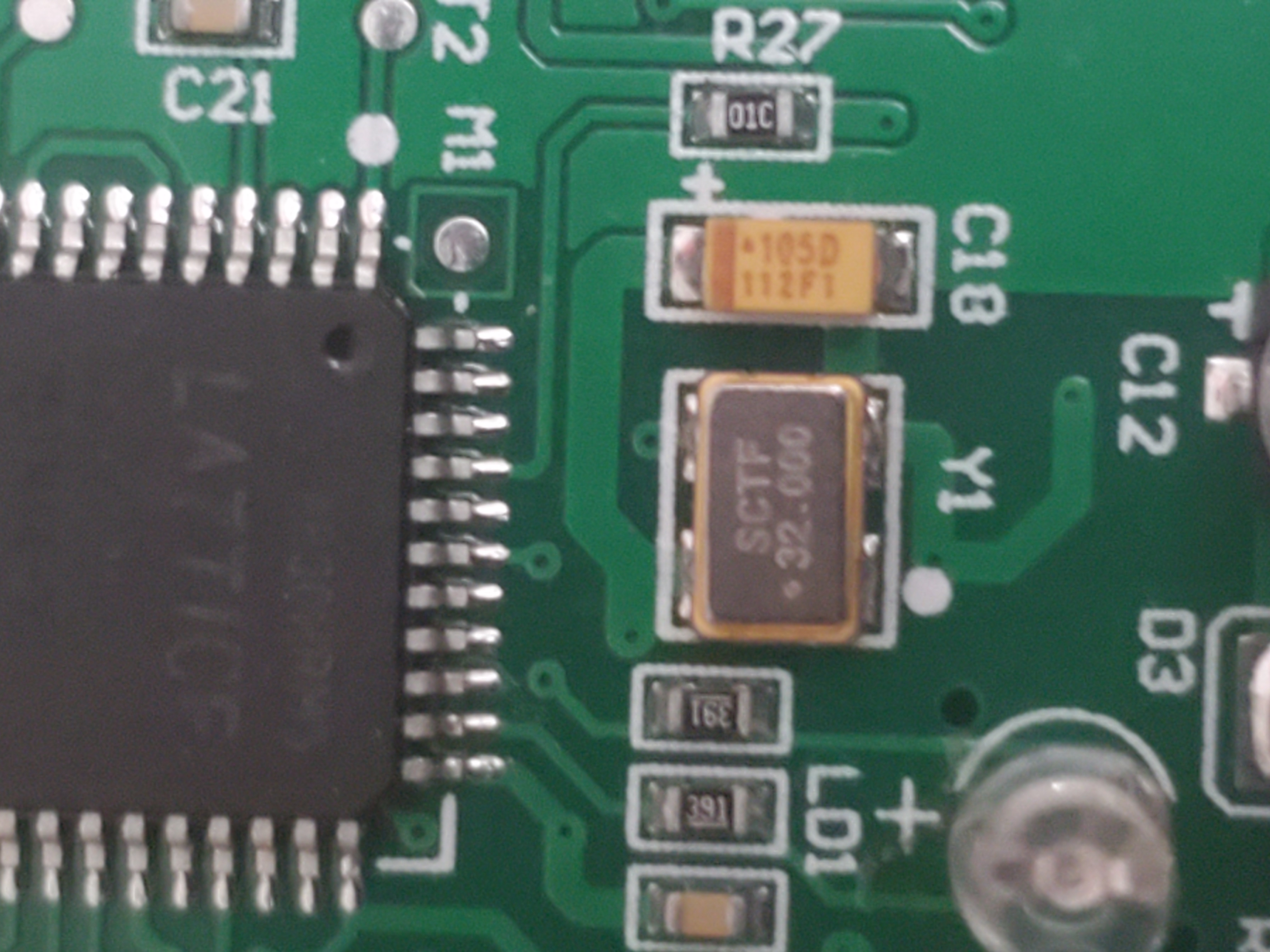

Is there a connected crystal oscillator?
图片附件: Screenshot_20230404-123137_AliExpress.jpg (2023-4-4 18:35, 476.67 KB) / 下载次数 11270
http://forums.xgecu.com/attachment.php?aid=1755&k=8e2f43864fdf3aefe572ae3c2151b623&t=1793323824&sid=83PNzm
图片附件: Screenshot_20230404-123137_AliExpress.jpg (2023-4-4 18:45, 476.67 KB) / 下载次数 11117
http://forums.xgecu.com/attachment.php?aid=1756&k=baaec61e295b3e488f06a1771e38ea63&t=1793323824&sid=83PNzm
图片附件: 20230404_202957.jpg (2023-4-5 02:34, 1.45 MB) / 下载次数 13355
http://forums.xgecu.com/attachment.php?aid=1759&k=3109ac10d9e283d4b365cc2e91ca685c&t=1793323824&sid=83PNzm

If you use ICSP Port you must check "ICSP-Port" on the Top where it named "Set Interface"
