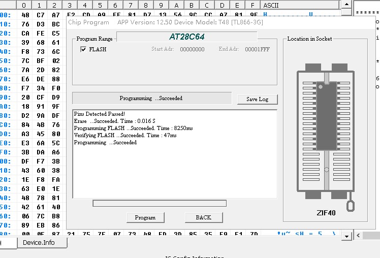

Both chips fail, random errors in programming, they are good EPROMs. Logs attached.

作者: admin    时间: 2023-3-17 15:30
回复 2# stevemas
select IC: AT28C64, not AT28C64E.
they have diffrent page size when programming.
error on adaddress: 0x00080 and 0x00040

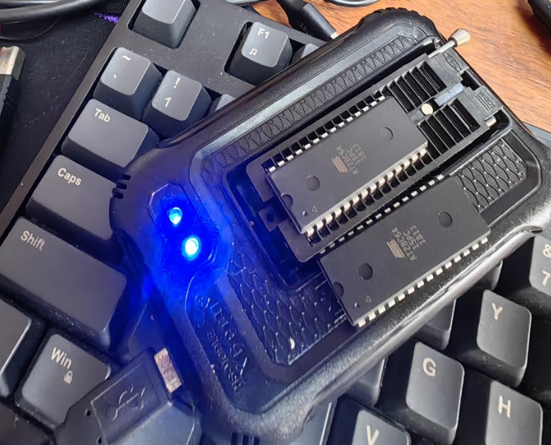

作者: admin    时间: 2023-3-19 17:56
回复 4# stevemas
   I have tested the AT28C64B and there is no problem. I will find several chips to try。
作者: admin    时间: 2023-3-20 13:55
回复 4# stevemas
all are normal.
