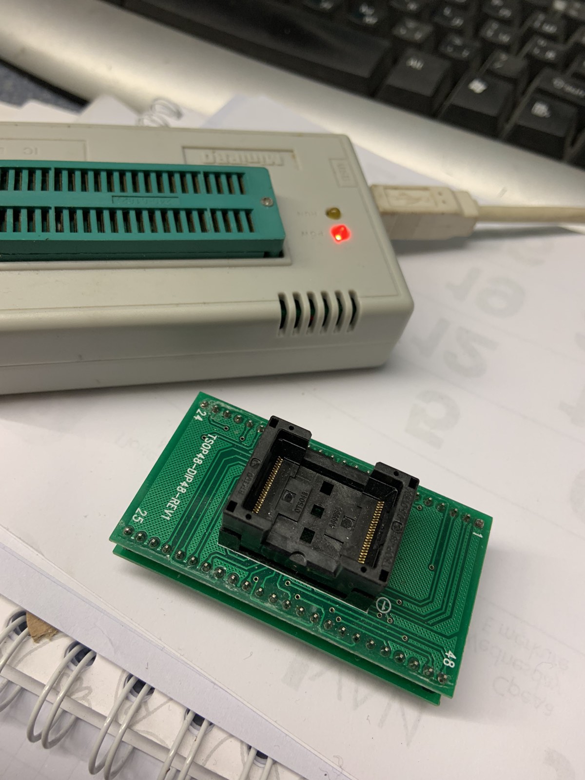

HELLO DEAR I HAVE ALREADY BOUGHT AND USED THE MINI PRO TL866CS and I have an adapter as in the picture TSOP48-DIP48-REV1. I WOULD LIKE TO ASK IF IF I BUY THE XGecu NEW T48 (TL866-3G) Programmer I will be able to use it to work on MX30LF1G18AC which is listed with this device
回复 1# MIKIMIKI
it can not be used.  it only be used on T56 programmer.
T48 and TL866II all use a special TSOP48 adapter. because they only have a 40 Pins socket.
