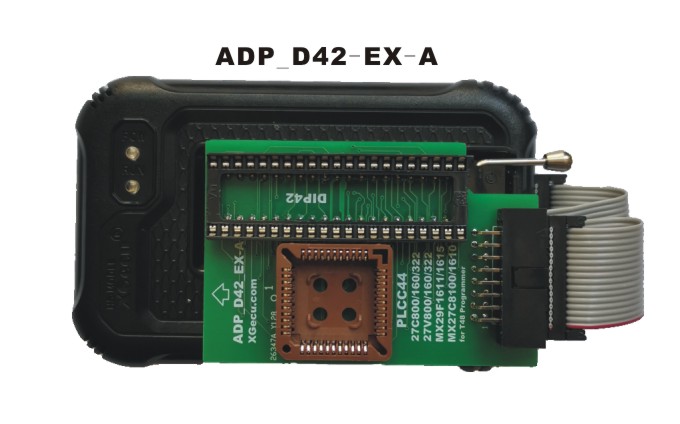

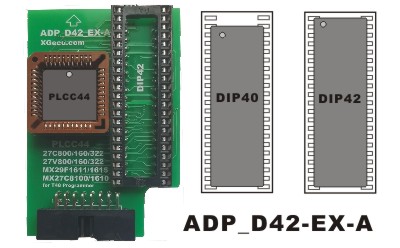

1.DIP42/PLCC44
for 27C800/160/322 27V800/160/322 MX27C8100/1610
only for T48 Programmer

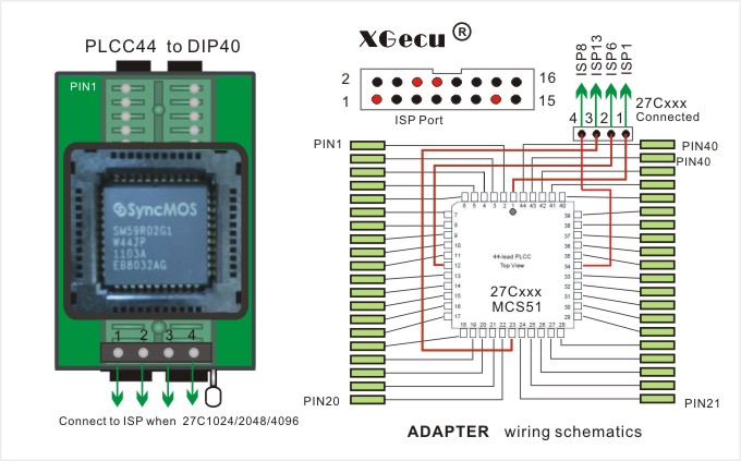

2.PLCC44 for C51 /27Cxxxx / PIC
