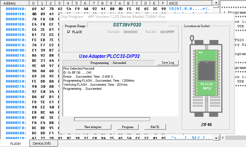

why disable CHECK ID?
these chips maybe too old.
i found this model of chips are often broken, and the ID cannot be read. Generally, it is a bad chip.
I tested it . everything  is normal.

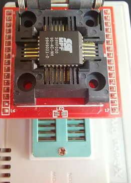

I then bought a new PLC/DIP adapter, but this did not help either. I also re-flashed the firmware to my TL866II and changed the USB cable, but always programming fails.

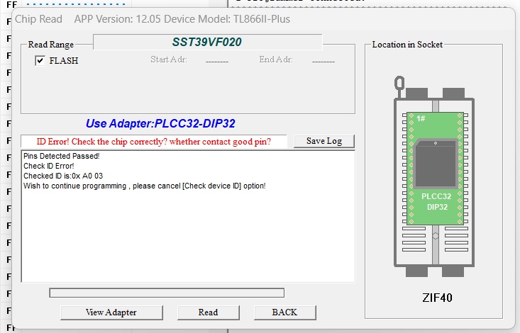

Here reading the old master chip with Check ID ON
Master Chip
2022-7-22 00:08
Here the new chip with Check ID ON
Reading no Chip ID
2022-7-22 00:09
Here the master chip with Check ID OFF... it reads the data

As I said, 6 chips are brand new and none of them works. I also cannot identify an issue with the socket. For PLCC32, I would need to check which pins are used for writing the Address: 0x000000 . Could there be a short in the socket?

I tried 2 different programmers and two different PLCC32 to DIP32 adapters. I am starting to thing the adapters are no good.
