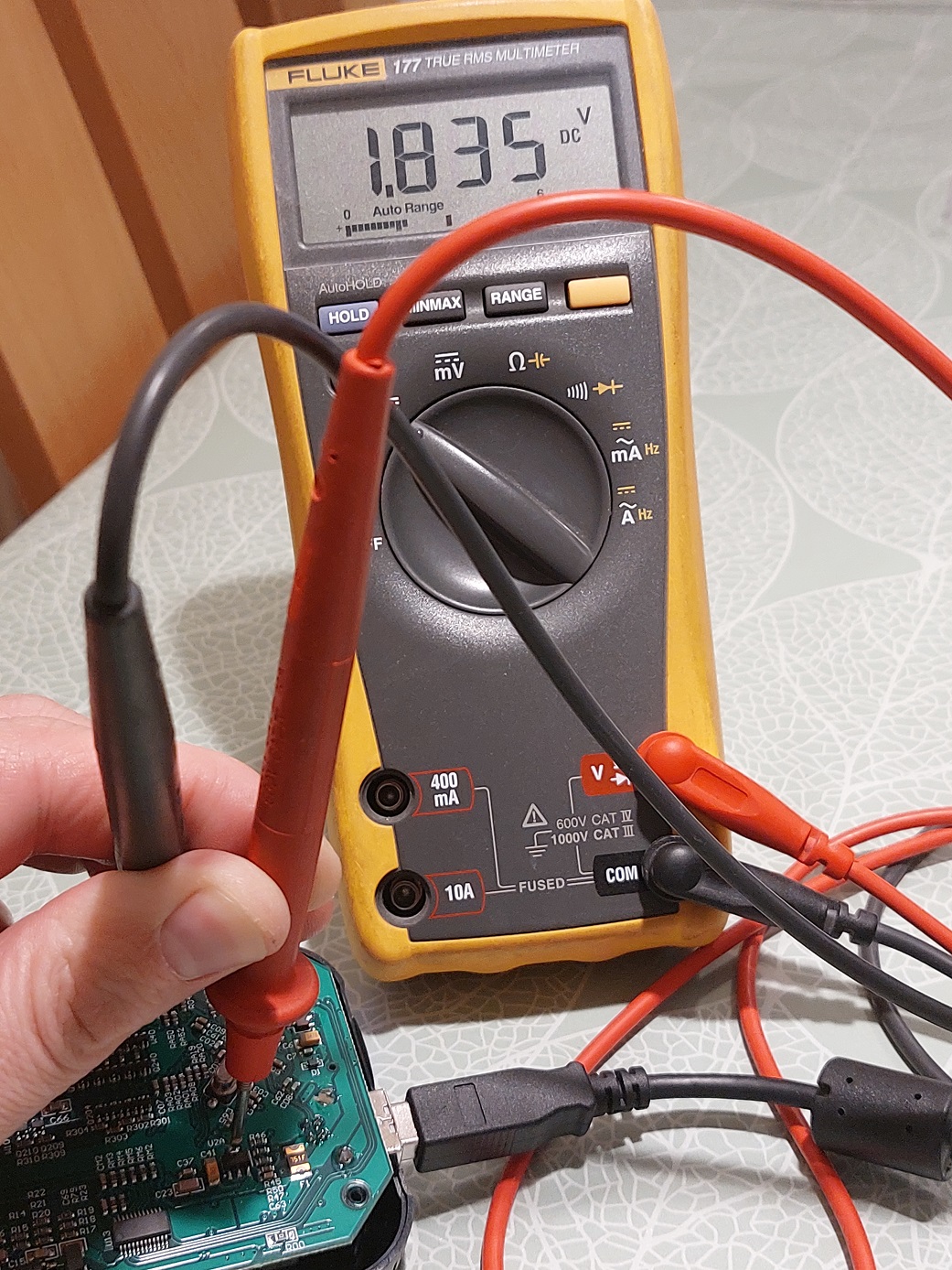

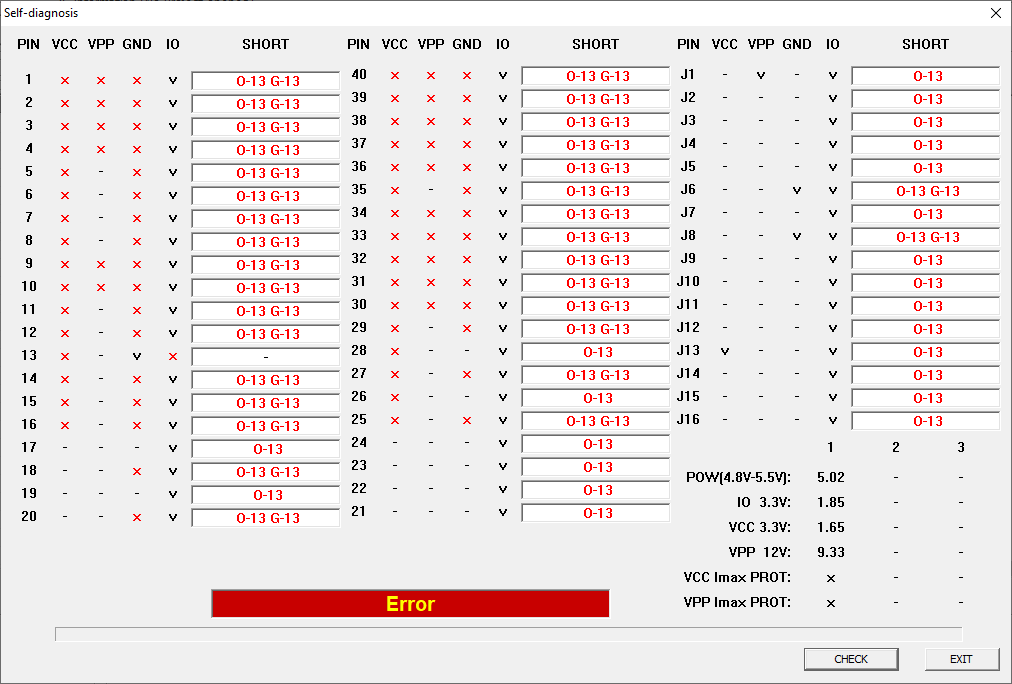

Dears,I bought original T48, use the newest software and firmware, but it not working at all, video shown below, that it aren't able to write simple memory (24C32W):
https://files.fm/u/xk2xb7je5
I try to read and write the same memory with the same socket on my cheap programmer EPZ2019+ and it working without any problem.
Could You help me ?
self test failed
回复 52# Requan
Sorry .it was broken.
open the box . Test the voltage as picture.
it 's normal about 3.25-3.35(3.3V), otherwise , Please replace the LDO  AMS1117-adj (Package:SOT89) .
Thank You for quick response and proffessional support.Yes, voltage is 1.8V instead 3.3V.
I will order LDO.
